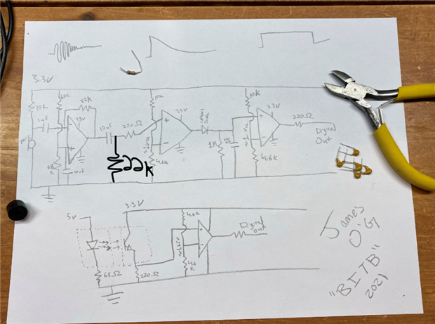

Vishay Phototransistor
I used this for a homing sensor to let the controller know where the beam is located. I have a 'flag' hanging off the beam that goes down and blocks the beam of this sensor when in the 'low' position.

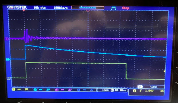

Microchip Op-Amp
This component ended up being very useful. I wasn't sure at first how to use it. I ended up using it to clear up a "clap" [audio] signal into an extremely simple digital input. I look at a microphone input in one stage, then pass into an R/C circuit for the second stage. At the third stage, I just clean up the signal into a digital which the microcontroller can easily read. So the microphone input uses 3/4 of the channels on this chip. The fourth channel was used by the photo interrupter to clean up the signal into digital.
The circuit is as shown here.
