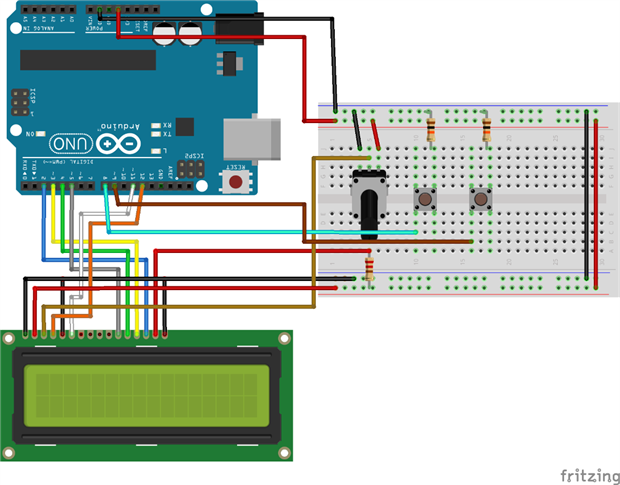

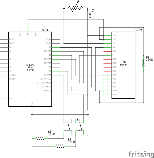

Clocks are a rite of passage for hardware hackers, and with this video you can start working on your DIY Clock merit badge using the Arduino platform to build a basic Arduino clock. This project builds on the Arduino Fortune Teller project and teaches programming concepts like timing and actively updating a display, so you can use it as a springboard for many more complicated projects!

THE CIRCUIT:

    beacon_dave over 6 years ago +2
    airbornesurfer looks like you have a short circuit in the power rail in your schematic across pins 1 and 2 of the LCD display. Also pin 5 of the LCD display is floating in the schematic but wired to ground…
  • airbornesurfer
    airbornesurfer over 6 years ago in reply to beacon_dave +2
    Ah, good catch! Sometimes Fritzing makes/breaks connections like this behind my back Thanks for the heads-up; I'll have to go back and fix them when I get a minute!

  • beacon_dave
    Also pin 5 of the LCD display is floating in the schematic but wired to ground in the breadboard layout.
