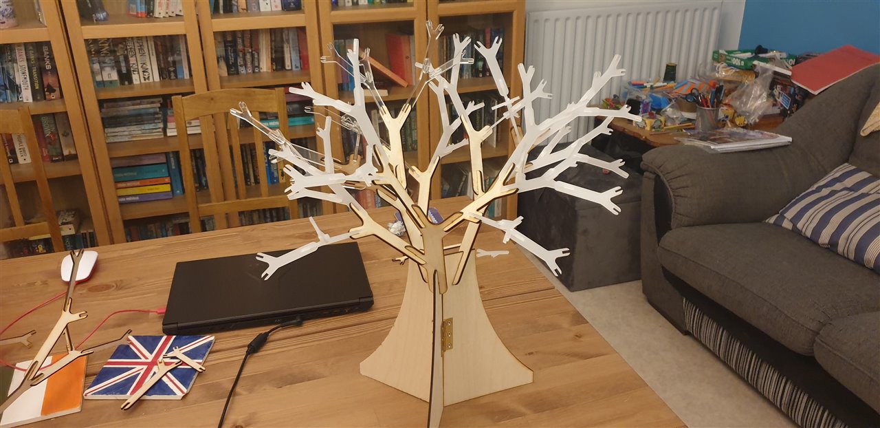

Solas is a leaf/light that attaches to branches on a tree. We decided to call the tree Laurelin (LOTR reference). I don't want the tree to be too tall that I would need a ladder to attach lights to it, so we're thinking 2 metres high. It needs to be collapsible and fit inside a car boot. Here are some of the original design files for the branches:
There are multiple layers of these of different sizes. 4 layers in total with the top 2 layers being 3mm thick and in frosted acrylic. The bottom 2 layers are thicker in wood with the trunk being maybe 9 or 12mm thick and 3 long pieces that can be screwed together. This is beyond the size of my laser cutter so we're relying on friends to help us with cutting the branches.
Here's the latest prototype and one quarter scale:
I like it! We need to add holes and figure out how each Solas/petal will connect to the branches. We also need to thread the wires through the branches.. possibly spray painting them so they look like roots! And maybe etch the wooden branches with decorations.

    If you are 'growing the tree' during the session, then attaching the Solais and wiring them may get interesting as time goes on. If the first person picks up the first branch and adds it to the empty trunk base then sticks their Solas onto the end of it and plugs it into the USB power supply, then that is ok. The next person then adds their Solas to the same branch and connects via Jacdac to the first Solas which is also ok. The third person adds their Solas to the same branch and connects it via Jacdac to either the first or the second Solas and that too is ok. That 3-way branch is now 'full up' though. At some point you will need to add another branch to that first branch (i.e. layer 2 branch) in order to grow the tree and add more Solais. So, presumably you will need to remove an existing Solas, add the layer 2 branch in its place, then replace the Solas onto the new layer 2 branch, rewire it to an existing Solas on layer 1 and then add the new Solas to the layer 2 branch and wire that via Jacdac to the Solas that has just been moved to layer 2. A bit of jiggling around and cable management may be required.
    Some Solais are going to start moving around the tree a bit as it goes, which is not a problem in itself unless you are giving them away, in which case the game of 'hunt my Solas' begins. Perhaps need to add a white rectangle to the silkscreen PCB layer so as people can write their name on them to help find them when it is home time ?
    What format to the Jacdac cables come in ? Are these premade to certain lengths or is there tooling available to make up your own custom cables ?
    One plus to growing the tree like that is you can make a rather neat time-lapse of it. One downside is that there isn't anything really on show initially to attract people from a distance. That was why I was thinking about synchronisation of the brains so as to be able to have fancy visual affects and then "hey kids, we are going to build one of _these_..."
    If it's mostly petals, then a simple solution may be to start with a full tree and work backwards from the last branches, replacing a petal with a programmed Solas. That way the petals are still getting control information from an upstream pre-programmed brain allowing for effects reliant on positional information (e.g. chasing/scanning along the branches). If you aren't using any positional effects, then you just need to have one 'brain' sitting somewhere on the branch which knows the addresses of all the petals that require to be controlled. If it gets removed and replaced with an independently driven Solas then it isn't an issue.
    If all you have is the 5 initial Solais, then perhaps drive the 8 chains of petals off 8 micro:bits instead and then leave the 5 Solais free for the workshop sessions. Once someone successfully programs the Solas then copy the code onto the micro:bit to replace a petal. Just need to watch out for any blocking code though.
    I notice that the Solas PCB doesn't include any mounting holes. Was that done on purpose ? Was thinking that you could laser cut a 'leaf' with 3 nylon standoffs that sloted into the end of the branch and then allow a Solas to be easily pushed onto and removed from the leaf. The leaf could be double-sided allowing for a Solas or petal on each side.
    I'm starting to have visions of "The Work Song Nanocluster" from The Big Bang Theory TV show here, trying to get things assembled in time Grin

    I thought we’d start with the trunk and people would add branches then lights. If it’s a tree full of Solas’ they code their individual light. If it’s a tree of Solas and mostly petals I need to think of how to do that.
    what would be cool is if someone writes the code for light 1, someone writes the code for light 2, someone else writes light 3 and so on. And their code can be easily added to a branch. You just plug it into the Solas/brain at the bottom of the branch. You wouldn’t even have to know what number your light is, it would just light up the next one..
    That code would work great for a string of lights too.
