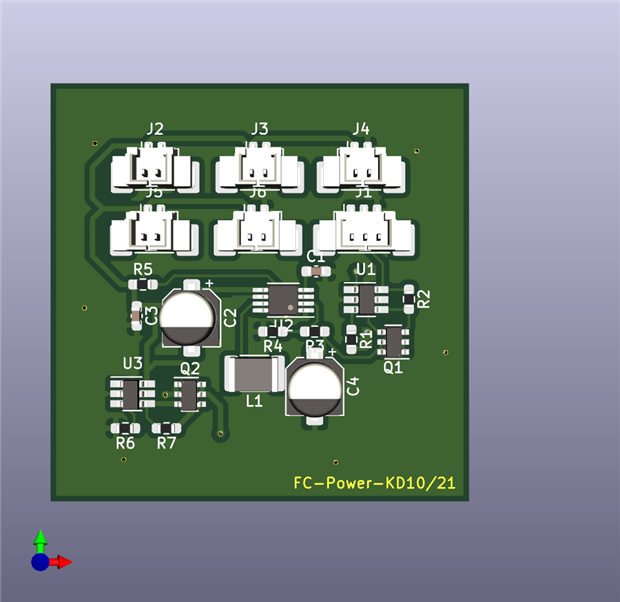

  • One side is a power supply, has a LiPo battery input and outputs 5v to 5 Molex PicoBlade connectors.
    • Pin1: +5V
    • Pin2: GND
  • Each side is completely stand-alone, has no dependency on any other side, other than the power connector.
    • All processing must be done on that side's PCB
  • The visible area of each side is 40mmx40mm
  • The PCB is 44mm by 40mm (This has a 2mm edge on 2 sides to slot into a 3D printed framework which will hold all the PCBs in to a cube shape.

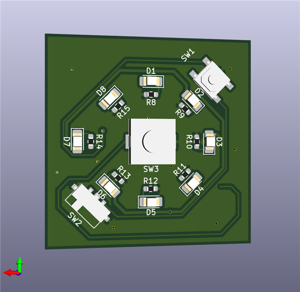

I currently have the Power supply PCB designed, this also includes a fidget element of a push button which will turn 8 LEDs on and off
Front and Back:

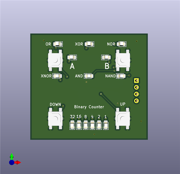

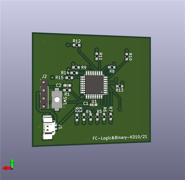

The next side I have designed is a logic gates and Binary counter board.
The top half has inputs A and B, and surrounding them the output of the following gates, based on input A and B, OR, XOR, NOR, XNOR, AND & NAND.
The lower half has a 6 bit binary counter, with a button to increase and decrease the counter.
Front and Back:

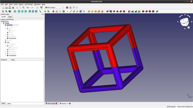

The framework to hold these into a cube will be 3D printed, and currently looks like this:
The red is the top half and the blue shows the bottom, these will slide over the PCBs due to a groove on the 4 outside faces. The top and the bottom will need some hotmelt glue or other fixing method designed into the 3D print to hold them in place. Potentially an internal framework which will push against the back of the PCB and also securely hold the LiPo battery pack.
