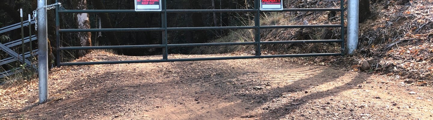

Priorities are strange. I have a huge list of projects on Bonesnapper Ridge, but what came up as the highest priority? The gate opener. Yep, even before power. This is the first project that I am going to build and blog about.
This topic is open for discussion. I would love to have your input on this build.
The Problem
During the construction and move-in phase, I have been going to town 2-3 times a day. Every time I leave, I have to stop the vehicle, get out, walk up to the gate, unlock it, open it, futz with making it stay in the right spot with a stick or a rock, walk back to the car, drive 20 feet, get out, go back and move that rock, close the gate, lock it, walk back to the car, get in and go. Then when I get back, I do the same thing in reverse. It's really not a big deal, just annoying to do so many times. And when it starts raining, it's going to be 100x more annoying.

Existing Gate
Currently, there is quite an average agricultural style gate with an ~8" post in concrete on the hinge side, and a ~4" post in concrete on the latch side. The gate itself is pretty boring, and I fully intend to build my own gate once the shop is done and I have a nice place to weld. My uncle also offered me to look around his "pile of gates" to see if there was something better or build me a custom gate. I've always wanted to build my own gate, so I am leaning towards that, but if he has something good... It's not off the table.
There is not really a great south-facing spot right near the gate for the solar panels, I will have to set them back a good 40-50 feet to be in an area that gets good access to the sun.
