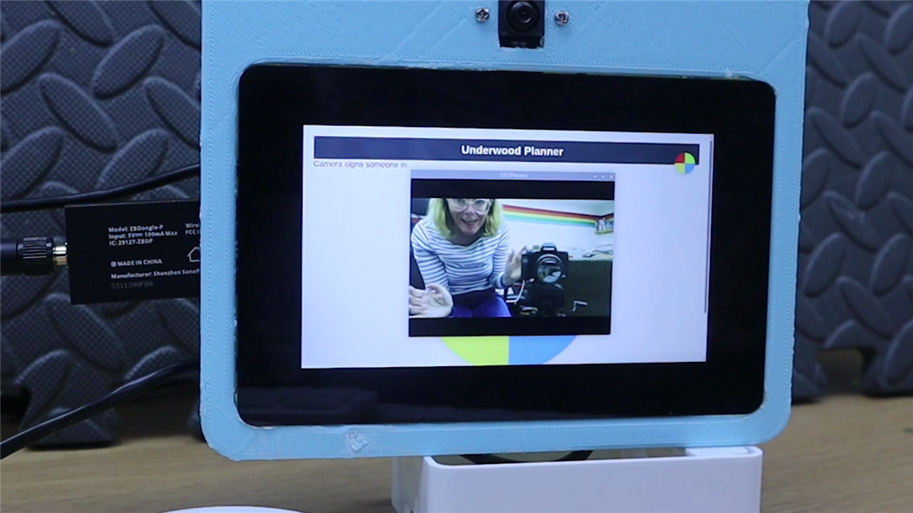

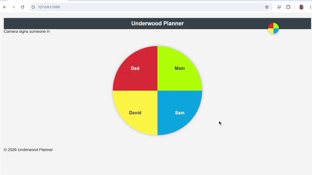

The heart of the project is the idea that information should be presented only to the person who needs it. Rather than displaying every family member's appointments and reminders on a communal screen, the planner uses a vision system to identify who has arrived and automatically display their own information.
"It's really important that only the correct people see their information."
To achieve that, Lorraine paired a Raspberry Pi AI Camera with a touchscreen interface. The camera is based on Sony's IMX500 intelligent vision sensor, which performs AI inference directly on the camera module rather than burdening the host processor. This makes it particularly well suited to edge-AI projects where image recognition needs to happen continuously while the Raspberry Pi remains available for running other services. The camera combines a 12.3-megapixel sensor with onboard neural-network acceleration, making face detection and classification practical without requiring an additional AI accelerator board.
During testing Lorraine discovered some of the realities of deploying facial recognition in a family environment. The camera occasionally confused children and parents, and lighting proved to be just as important as the recognition software itself. Once the camera was mounted more securely and images were retaken, recognition performance improved significantly.
Rather than treating these observations as setbacks, the project highlights them as useful design considerations for anyone implementing person recognition in a domestic setting. Stable camera placement, consistent framing and multiple training images are likely to improve reliability.

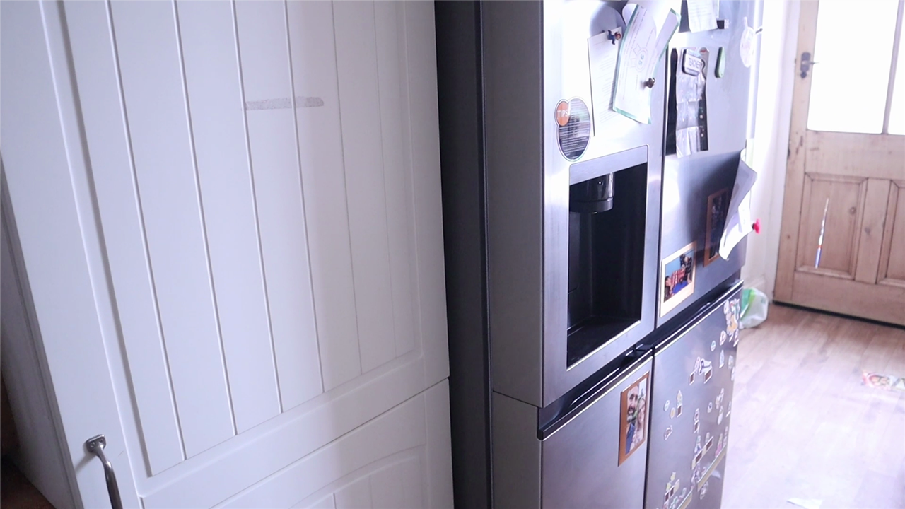

One of the most enjoyable aspects of the build is its use of a four-button wireless Zigbee controller mounted on the family fridge. Instead of requiring users to navigate menus, chore reminders can be assigned with a single press.
The original concept centred on common household jobs such as emptying the dishwasher and taking out recycling. When someone notices a chore needs attention, they simply press the corresponding button. The planner then assigns the task to the appropriate family member.
What makes the controller particularly flexible is that each button supports multiple actions. Lorraine discovered that single-click, double-click, triple-click and long-press events could all be detected.
"You kind of have like up to 12 buttons really rather than just four."
This dramatically expands the possibilities for future versions, allowing a relatively simple controller to support a much larger collection of actions without adding extra hardware.
Communication between the controller and the Raspberry Pi is handled using Zigbee networking through a USB coordinator dongle. After initial pairing and configuration, Lorraine verified that the buttons remained reliable across floors of the house, with the Raspberry Pi located in the basement and the controller mounted upstairs on the kitchen fridge.

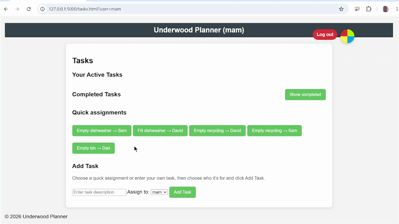

While the hardware draws immediate attention, much of the project's value comes from the custom web application running locally on the Raspberry Pi.
The interface combines several household functions into a single dashboard:
  • Shared shopping lists with item tracking.
  • Household messaging between family members.
  • Task assignment and chore notifications.
  • Automatic user selection through face recognition.
  • Local data storage running on the Raspberry Pi.
The shopping list implementation goes beyond a basic checklist by recording who added each item and when it was added. Lorraine also discussed future plans for a print function, making it easier to generate a physical list before heading to the shops.
Meanwhile, the messaging system enables quick communication between household members without relying on external services. Messages can be sent to individuals or broadcast to everyone in the family, creating a lightweight communication layer entirely within the planner.
A particularly elegant design choice is the use of a JSON configuration file to map specific button events to particular actions. This allows the physical controls and software interface to remain loosely coupled, making future customisation straightforward.

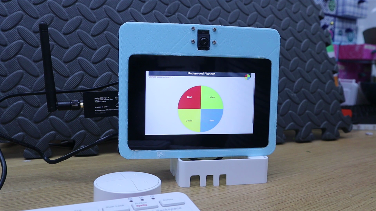

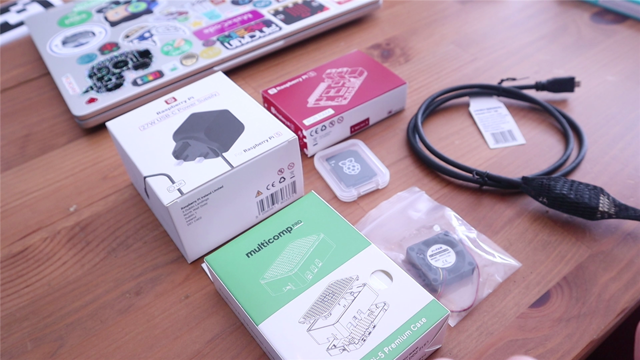

The Raspberry Pi 5 provides enough processing headroom to run the local web application, Zigbee services, touchscreen interface and camera software simultaneously. Lorraine also made use of active cooling, recognising that computer vision workloads can place greater demand on the system than many traditional maker projects.

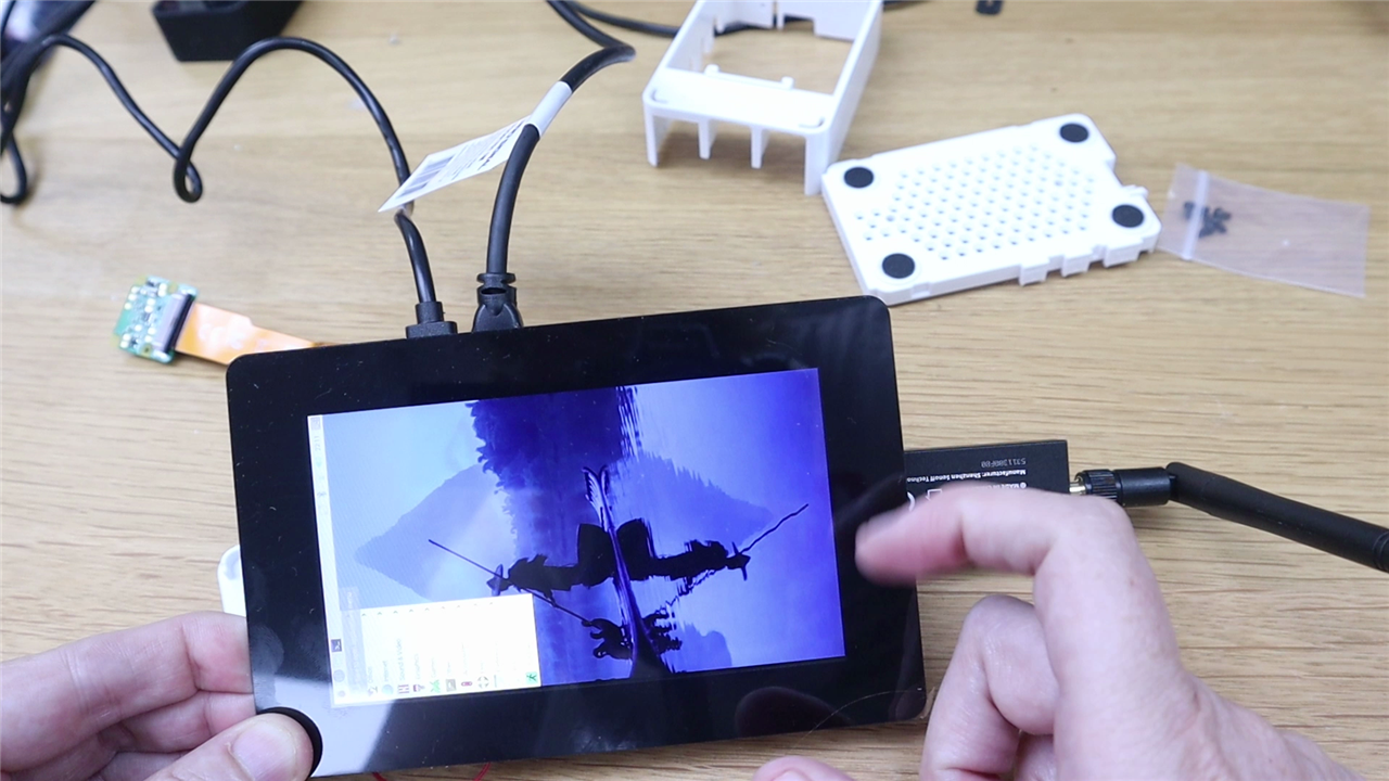

The 5-inch Touch Display 2 serves as the planner's primary interface. Connected through the Raspberry Pi's DSI display connection, it supports five-point capacitive multitouch and provides a 720 × 1280 resolution panel, making it suitable for kiosk-style installations and information dashboards. 【3-54beba】【4-509005】【5-1f5816】
One practical lesson from the build involved integration. Although the Raspberry Pi case initially appeared to solve enclosure requirements, cable routing and accessory placement quickly complicated matters. Rather than forcing everything into the supplied enclosure, Lorraine opted to develop a custom 3D-printed mounting solution that incorporates the display, camera and Raspberry Pi into a single assembly.
