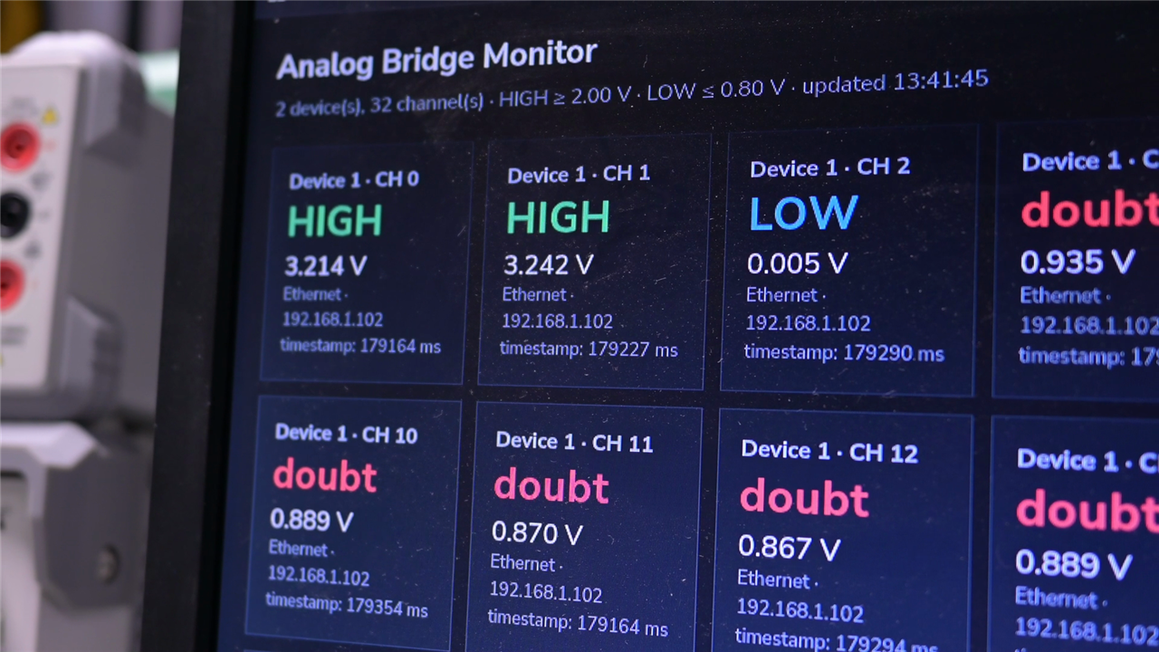

For a nominal 3.3 V digital system it is tempting to think of every signal as simply 0 V or 3.3 V. Reality is rather less tidy. Digital inputs recognise voltage ranges, and a problematic output may change without travelling sufficiently far into the valid high or low region. A binary indication can therefore hide precisely the information needed while debugging a marginal circuit.
Analog Bridge consequently measures voltages rather than deciding in firmware whether a pin is high or low. That distinction is important. The hardware collects the value; it is the client application that decides how to interpret it.
The supplied monitor, for example, uses configurable thresholds. Its defaults classify 2.0 V and above as HIGH, 0.8 V and below as LOW, with anything between those values reported as a doubtful state. Those levels live in the Python application rather than being hard-coded into the measurement hardware, so a user can change the interpretation without changing the instrument firmware.

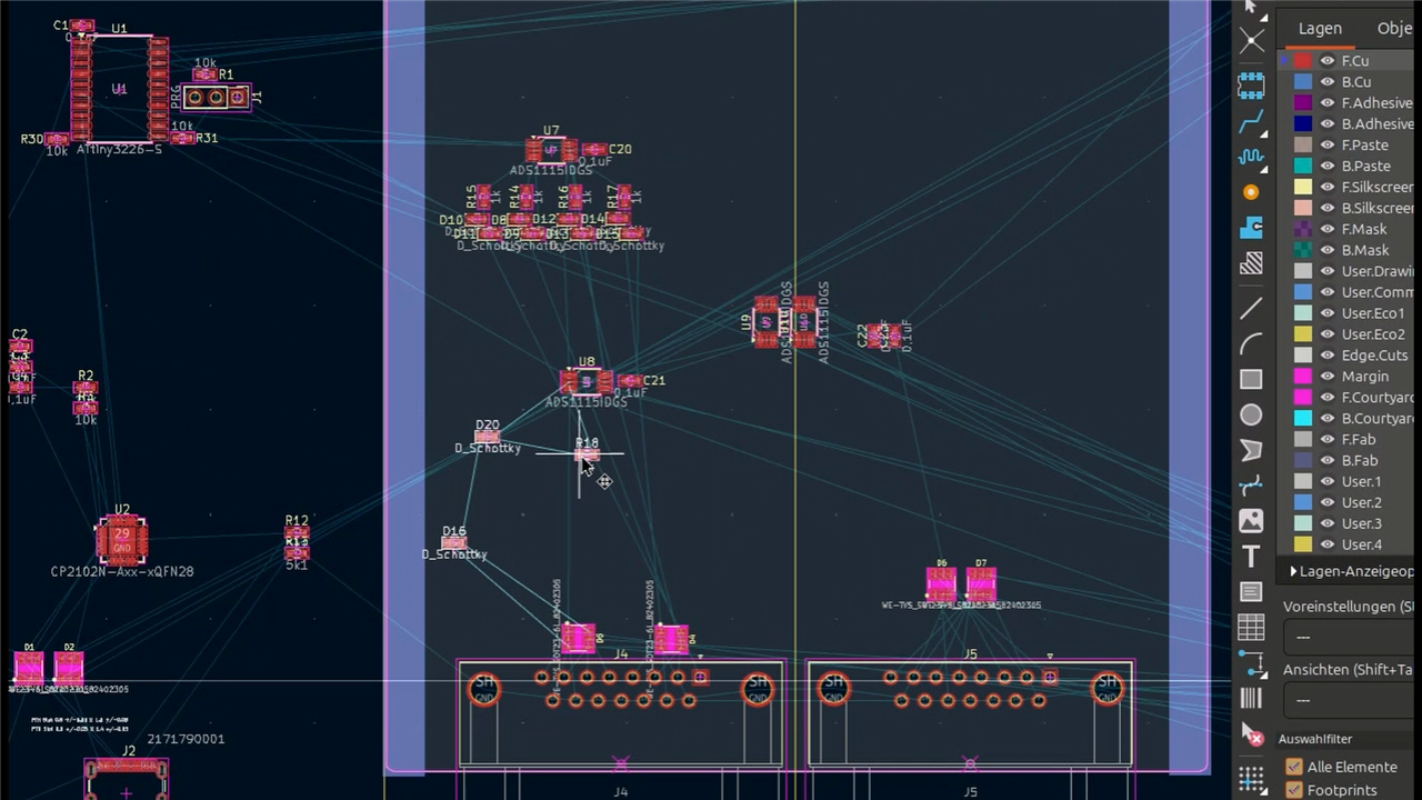

A single Analog Bridge PCB has 16 analogue inputs. Rather than producing a monolithic 32-channel board, Clem simply built two and installed them in the same enclosure. They share power, but not their Ethernet interfaces.
“This is actually two units inside one case. So this is a modular device, meaning I can have as many channels as I may need for my project.”
There is a practical advantage to that architecture beyond easier PCB reuse. Each module is an independently addressable network instrument, so one can be used by one diagnostic application while another performs a different job. There is no internal Ethernet switch or master board coordinating the pair.
This also avoids squeezing the entire 32-channel workload through one acquisition scheduler. Two modules can make measurements independently, with the resulting data reconciled by software. Clem's firmware attaches a millisecond timestamp to each valid sample, and that timing information accompanies the raw ADC value when all 16 channels are requested.

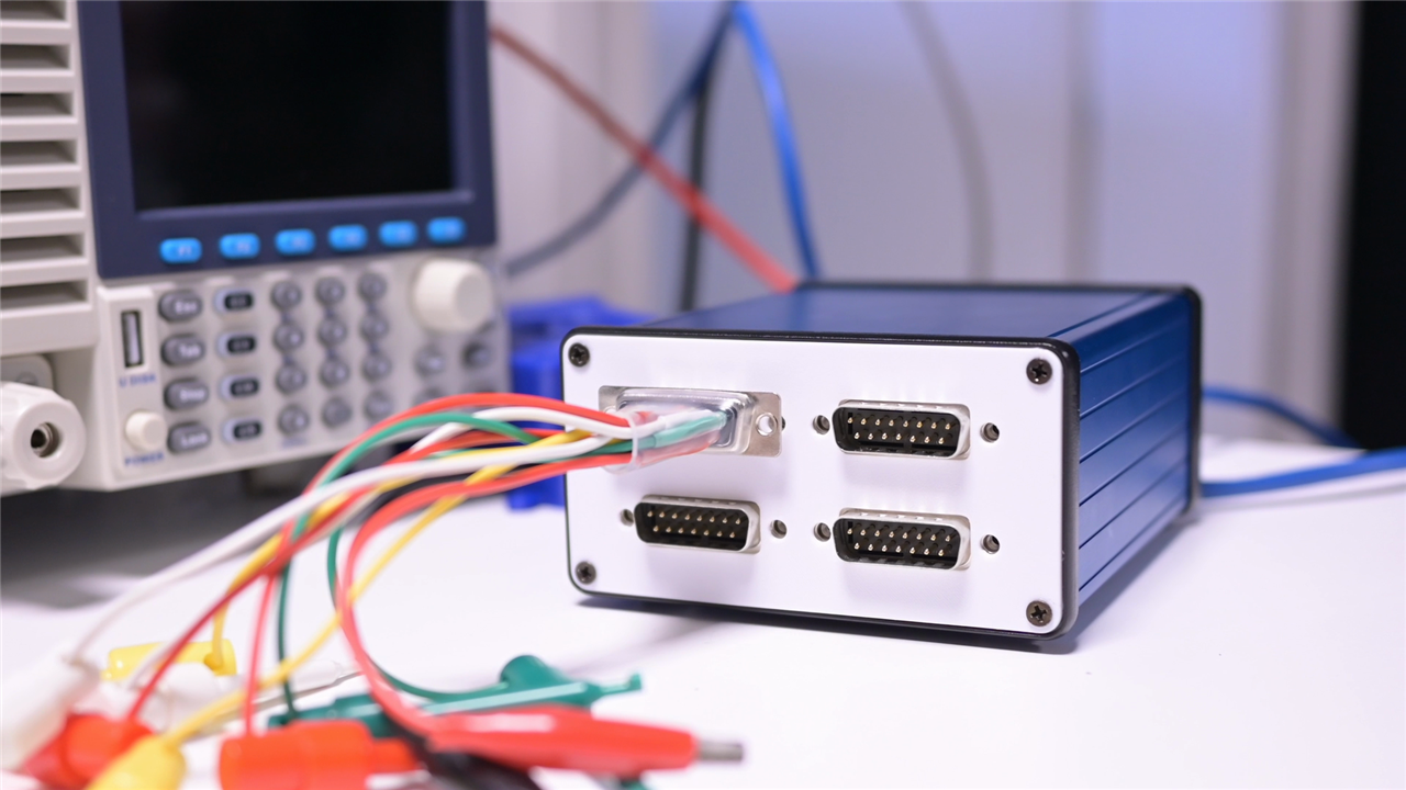

Starting at the business end, Clem chose the familiar 15-pin D-sub connector for the analogue connections. Its relative rarity on modern equipment is actually useful here because there is less chance of accidentally confusing the custom measurement connection with a contemporary computer interface.
More importantly, it provides a convenient point from which to build application-specific leads. A harness can terminate in individual wires or clips, while a little adapter board can present BNC sockets and allow conventional oscilloscope probes or other test equipment to be used.
“This gives me the ability to adapt to whatever I'm testing without modifying my device heavily.”

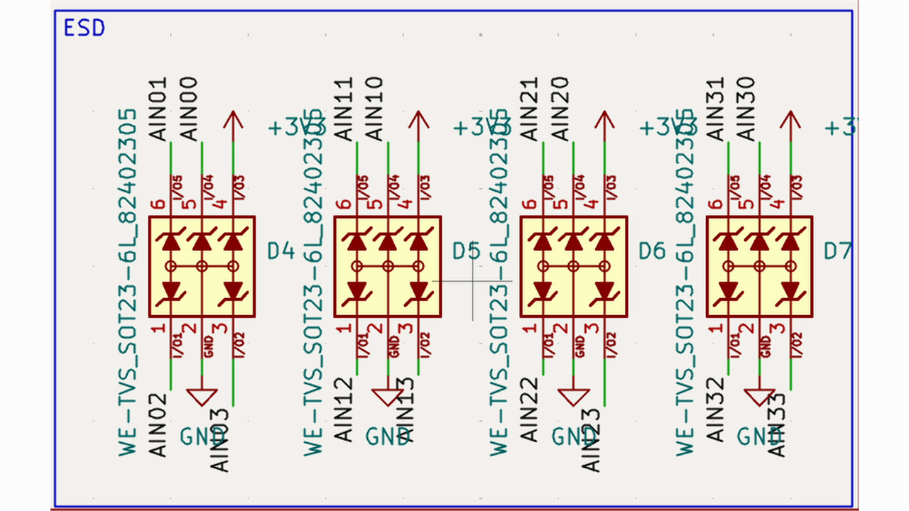

Behind the connector sits the part of the design Clem regards as particularly important: input protection. A bench instrument cannot assume that every circuit connected to it will stay politely within the ADC's range. Static discharge, wiring mistakes, negative voltages and signals from other voltage domains all need consideration.
The inputs therefore use Schottky-diode clamps towards 0 V and 3.3 V, together with current-limiting resistance and ESD protection. There are two clamp diodes for each of the 16 channels, so even before the protection around the other interfaces is counted, the little board becomes surprisingly diode-heavy.

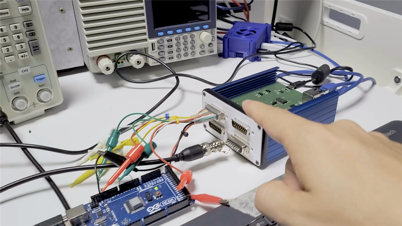

“It will always be clipped at zero volts and at 3.3 volts, so it never goes beyond these two points to protect the input chain.”
Clem even demonstrates the point with a 5 V Arduino Mega signal. The Analog Bridge itself is intended around a 3.3 V measurement domain, but the protected input limits what reaches the ADC. That should not be interpreted as an invitation to connect arbitrary voltages: the inputs are neither isolated nor a replacement for the rated front end of a proper oscilloscope. Builders should verify the permitted input conditions, common grounding and protection-component ratings before attaching an unknown circuit.
That caution is particularly relevant because this is experimental bench equipment. Clem notes that a productised version would warrant substantially more work around EMC, shielding and signal integrity. His enclosure uses 3D-printed end plates; he experimented with metal parts but found the simpler arrangement adequate for his current use.

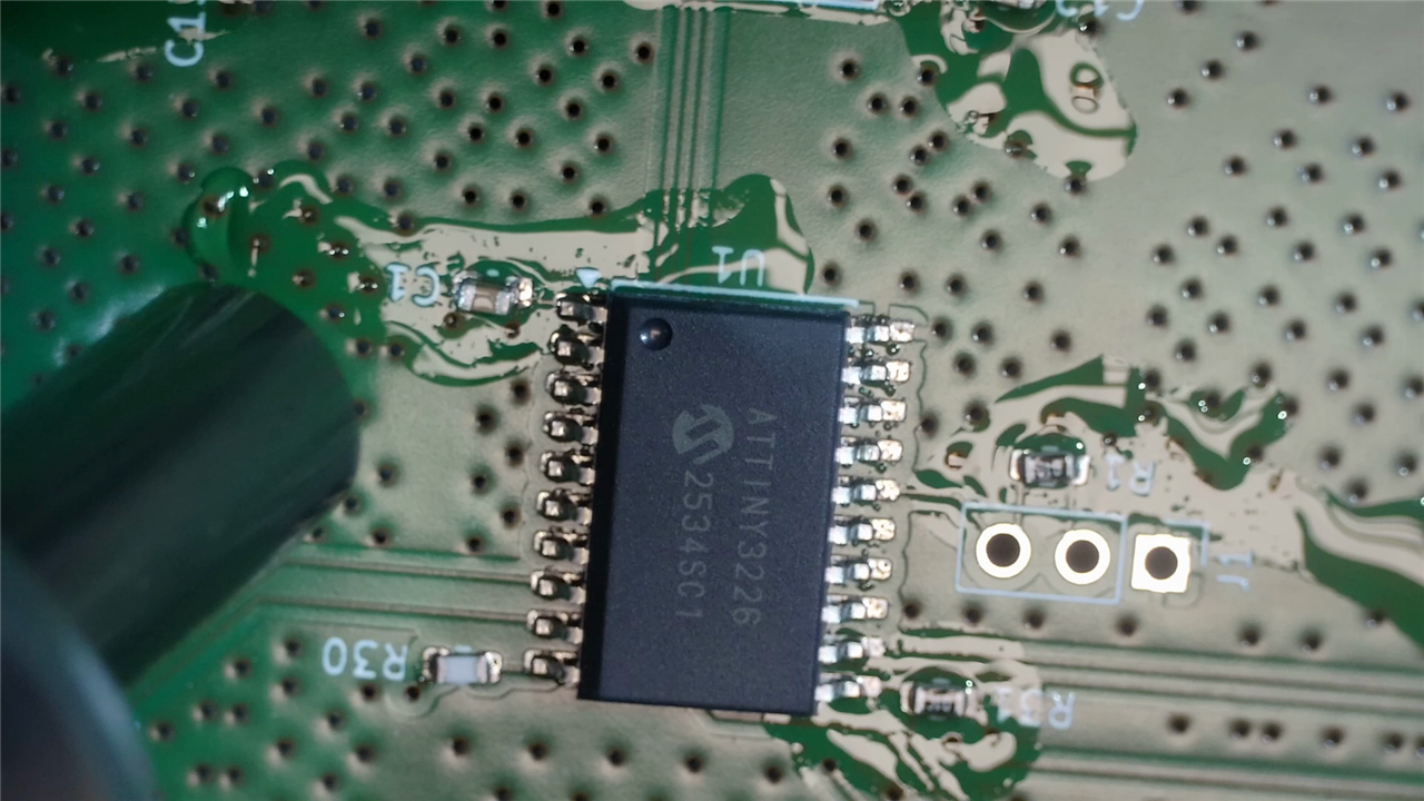

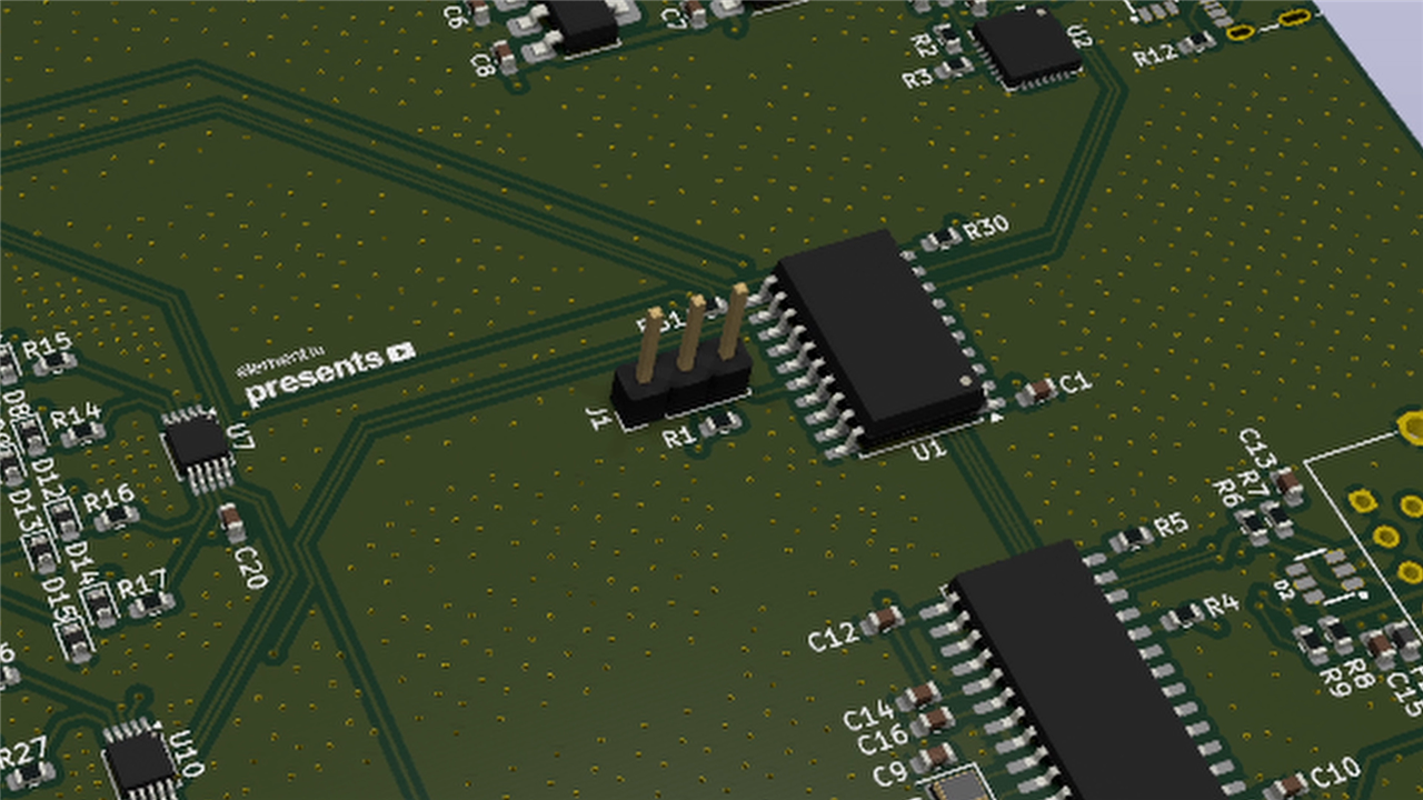

The converters communicate over I²C with a Microchip ATtiny3226. It is a rather more modest processor than somebody might expect to find in a modern oscilloscope, but that is the point: Analog Bridge is not trying to digitise and process high-speed waveforms locally.
The ATtiny3226 is an 8-bit tinyAVR 2-family device capable of running at up to 20 MHz, with 32 KB of Flash and 3 KB of SRAM. Clem chose it because it has the interfaces and pins needed by the application without adding unnecessary computing power.
“The MCU only relays data. It doesn't do any signal processing on here... it just obtains that data and then whenever asked for it, it will relay that over Ethernet.”
This decision keeps the embedded side pleasingly straightforward. Interpretation, graphing and logic-state classification all happen on the host. Improvements can therefore be made to the applications without repeatedly rebuilding the measurement hardware.

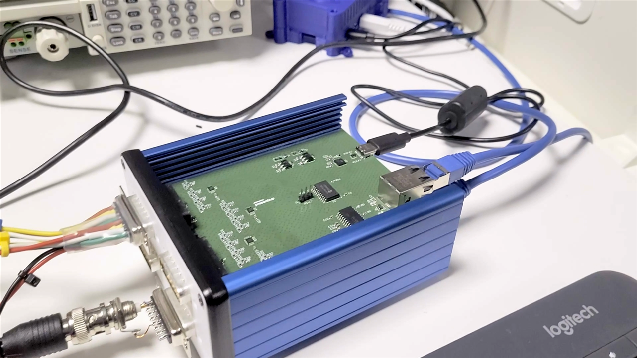

Ethernet, USB and SCPI
The ATtiny's next job is getting those samples off the instrument. Ethernet comes courtesy of the familiar ENC28J60 controller. Clem had already used the part in his EtherRGB project, so this was an opportunity to reuse a proven portion of the design rather than solving the same networking problem again.
USB uses a Silicon Labs CP2102N USB-to-UART bridge. The USB connection is deliberately an instrument interface rather than the normal firmware-programming path. Clem keeps UPDI available for deliberate firmware updates instead of turning the externally accessible USB connector into a convenient route for reflashing the controller.
“This is strictly a UART connection that can have debug output but also will accept SCPI commands. So you can choose if you're going via Ethernet or USB.”
The two interfaces expose the same simple command-oriented model. Ethernet uses DHCP and TCP port 5025, while USB serial operates at 115200 8N1. The current project documentation notes that the network service has neither authentication nor encryption, so Ethernet operation belongs on a trusted network rather than an exposed one.

The dual-module configuration creates a power consideration which is easy to overlook. Both boards are linked for power so a single USB-C connection can supply the assembly, but connecting multiple powered interfaces can create potentially unpleasant back-power paths towards another module or the host computer.
Clem consequently includes diode protection around the power inputs to prevent current travelling in the wrong direction. In his view, this and the analogue input protection account for a surprisingly substantial part of the electrical design.
The finished boards live in a Hammond 1455-series enclosure. The series lends itself well to sliding PCBs into an aluminium extrusion, and using a larger version leaves a straightforward route to fitting more modules. The front and rear plates for this build are 3D printed, with the project's manufacturing assets including the required 3MF and SVG files.

Once the hardware is measuring, the client software is where the project becomes particularly flexible. Clem's Python monitor first searches for Analog Bridge devices and identifies them using the normal *IDN? request. Ethernet discovery probes the local IPv4 /24 networks for devices listening on port 5025. USB discovery can alternatively probe serial interfaces using PySerial.
Once discovered, the program repeatedly asks each instrument for all 16 measurements:
channels = parse_measurements(
device,
device.command("MEAS:RAW:ALL?", 16)
The raw signed ADC value is converted using the configured ±4.096 V full-scale setting, after which the host applies its HIGH and LOW thresholds. With two bridges attached, the browser interface consequently becomes a 32-channel logic-level monitor showing both interpreted state and measured voltage.

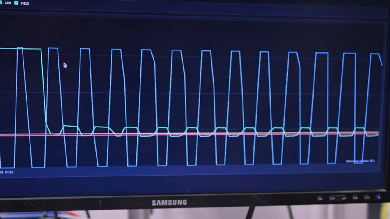

This directly addresses the original PLC problem. Instead of moving a probe from node to node and trying to mentally correlate what happened earlier, Clem can wire probes throughout the signal path and observe the system together.
“I can go through my device's states, see if the signal changes have occurred as they should... I can see if the signal chain has propagated correctly.”
The ability to configure thresholds is particularly handy here. It prevents the instrument itself from asserting that an arbitrary voltage is universally a valid digital HIGH or LOW. The host can use limits appropriate to the circuit being investigated, while still displaying the underlying measurement when something sits in the grey area.

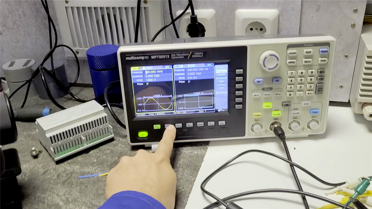

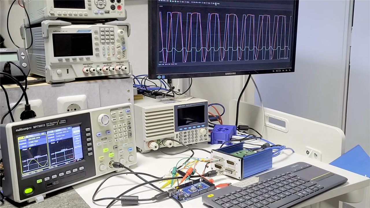

The second Python application deliberately pushes the same hardware into territory for which it was never really intended. It plots one input from each ADS1115, logical channels 0, 4, 8 and 12, giving four traces per module. With two bridges, that makes an eight-trace waveform display.
It is described, with suitable enthusiasm, as an oscilloscope. Clem is equally quick to point out that it is not a particularly good one.
“Technically we have made an oscilloscope now with eight channels... so we have an eight-channel oscilloscope that is very slow.”
The host defaults to polling every 250 ms and plots measurements into a rolling 30-second window. As the test frequency is increased, the acquisition rapidly stops representing the original waveform. Samples become isolated points along a much faster signal and there simply is not sufficient information to reconstruct the curve correctly.
For Clem's demonstration, getting down below about 1 Hz is where complete slow waveforms such as sine and sawtooth signals become recognisable. This limitation should not be confused with the headline 860 SPS capability of an individual ADS1115 configuration. The complete instrument includes input multiplexing, channel scheduling, command-and-response transfer, host-side polling and plotting. The demonstration is therefore illustrating the behaviour of this complete multi-channel system, rather than simply quoting the converter's maximum specification.

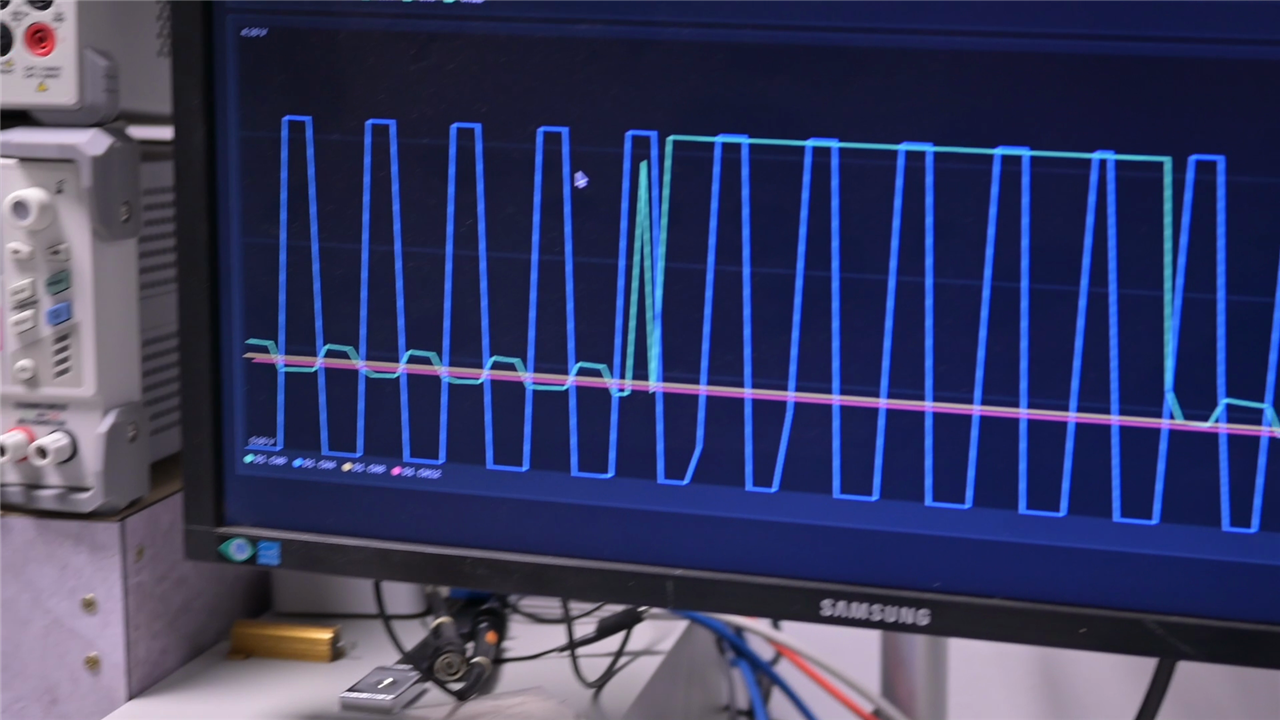

The supplied oscilloscope client reinforces the distinction. It concentrates on channels 0, 4, 8 and 12, AIN0 on each converter, rather than pretending that every input can simultaneously behave like an independent high-speed scope channel.
“It is a logic probe. It tells us the state of a pin at a given time and not the transition between those states, so different tools for different purposes.”
It also makes a neat practical demonstration of why a proper oscilloscope costs rather more than an ADC and a microcontroller. Capturing a faithful fast waveform requires a high-rate analogue front end, sustained acquisition bandwidth, buffering, processing and display. Analog Bridge instead trades that performance for many inexpensive channels and software flexibility.
