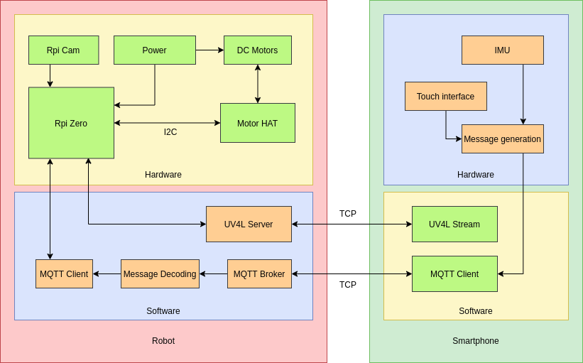

The project is titled "A simple Gesture Controlled Robot" and it uses readily available day to day hobby utilities such as an RC toy car, a smartphone, a Raspberry Pi Zero, a MotorHAT, and a battery power source.
Let me give a simple graphic to understand the basic layout of the whole system.
The main parts of this system are the Robot and the Smartphone. There is a 2-way wireless communication between the robot and the smartphone.
The Robot boasts the following features:
  • Remote video streaming server
  • MQTT based message pipeline
  • MQTT broker hosting
  • DC Motor interfacing
The Smartphone contributes to the following:
  • Onboard sensor access for gesture recognition

    Wow, so many people are using MQTT! I didn't think it would respond fast enough for a robot control, what's the latency like?

    Thank you all for your appreciation and feedback. During this lockdown, it was very challenging for me to take up and complete such a project right from scratch. I had to face a lot of difficulties on…

    Could you have also used webrtc locally so you do not need an online server? Always wanted to try that with an RC project!
    This would be phenomenal with VR/webVR controllers!
