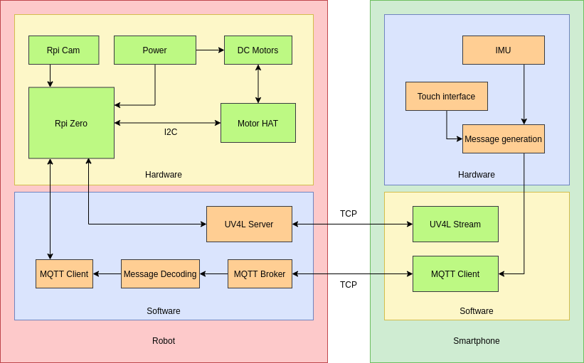

The project is titled "A simple Gesture Controlled Robot" and it uses readily available day to day hobby utilities such as an RC toy car, a smartphone, a Raspberry Pi Zero, a MotorHAT, and a battery power source.
Let me give a simple graphic to understand the basic layout of the whole system.
The main parts of this system are the Robot and the Smartphone. There is a 2-way wireless communication between the robot and the smartphone.
The Robot boasts the following features:
  • Remote video streaming server
  • MQTT based message pipeline
  • MQTT broker hosting
  • DC Motor interfacing
The Smartphone contributes to the following:
  • Onboard sensor access for gesture recognition
