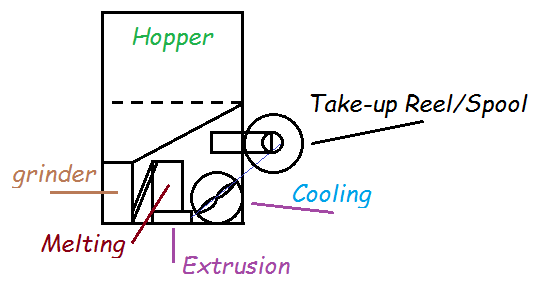

    e14 Contributor over 10 years ago in reply to beacon_dave
    Shouldn't be any water in the system, other than possibly vapor from any absorbed by the plastics.  Some plastics absorb and/or are more permeable than others.
    How about a hopper to feed-auger/grinder, into a small melting chamber, then a second auger extruding off the bottom, so the extruder only gets liquified plastic?  Still needs to be a continuous process, once started, so the hopper needs a capacity large enough to allow for normal human activity and behavior.
    Something like one of those coffee-grinder to fresh coffee makers.  where the feed stock is in a hopper, then goes through a grinder and into the rest of the process.
    For that matter, w/PWM heat control, maybe insulate an automatic-drip coffee-maker heating element/tube, as the melting area, prior to extrusion?  Or wrap a heating element around a piece of pipe and insulate that, for the melt chamber?  Pot sits on top, like a coffee caraffe', preheating and melting, then auger feeds through the heat-tube, pushing out through the metered orifice, for the final filament size?  Might be able to insulate and convert one of those single-cup size ADC coffee makers?  Extruder auger would need a thermal control switch, as well, preventing it from operating below some suitable temperature.
    Maybe, initially, have a designated plastic, and make only one kind of filament, such as collecting and cleaning only plastic milk-jugs, is the source?

    beacon_dave over 10 years ago in reply to e14 Contributor
    I was thinking of small amounts of water left over from cleaning the plastic. If it goes into a hot melt though then this should quickly boil off as the melt point of HDPE appears to be around 250F, well above the boiling point of water at 212F.
    I thought about feeding liquid plastic into the auger as well. May need to have this at a slightly lower temperature (250F-300F) so that the plastic is still gooey at this stage rather than fully liquid so as then the auger doesn't have to be so liquid tight. Alternatively consider a near vertical auger so that leakage is less of an issue. Then the extruder heater can raise it up to the 350F+ required for extrusion. Another bonus is that if the plastic is in a liquid state in the auger then less torque will be required to turn the auger. The downside is if the liquid plastic is allowed to cool in the auger then it will require to be heated up to 250F to get things turning/flowing again.
    High temperature glue guns appear to operate at around 380F so could potentially be used for the final extrusion heater and will have thermostatic controls built in.
