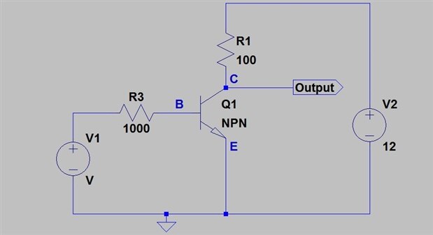

    A simple transistor amplifier:
    This is an explanation for beginners, it is not the whole truth but this way of thinking about transistors (or to be pedantic Bipolar Junction
    Transistors) will work for most DC circuits.
    This is an NPN transistor (PNP works the same except all the voltages go the other way round, in my reality current flows from Positivie to Negative
    which is called Conventional Current  - some people get all excited about what the electrons are doing but you don't need to know.)
    The first thing you need to know is that the transistor will only work properly when it has some current flowing in it and something is making sure that
    there is a voltage from collector to emitter and base to emitter. This is called biasing the transistor and is essential to make them work with AC in
    linear circuits (switching circuits are a bit different and we'll worry about them another day.)
    So in our circuit we make V1 the input voltage 1V.
    V2 is the 12V power supply and the little triangle is the zero or ground reference point.
    The base to emitter connection in the transistor is like a diode so if we make the base positive then current wants to flow from base to emitter and it
    can (the diode part of the symbol shows that). There is a a way of working out exactly what the voltage across the base emitter needs to be for any
    current but for starters we'll just say that for small silicon transistors you'll get about 600mV for reasonable currents.
    The 1V input will give us a current of (1 - 0.6)/1000 = 0.4mA.
    (That's the applied voltage - the base/emitter voltage divided by the total resistance in the loop = 1000 ohms).
    Now we come to the magical part of transistors.
    If you make a current flow from base to emitter the transistor will try to make a bigger current flow from collector to emitter.
    The collector current divided by the base current is the transistor gain (often Hfe or HFE in data sheets (warning  - economy with truth here)).
    A typical gain for a small transistor would be 100 so our Q1 will try to make 0.4 * 100 = 40mA flow in it's collector.
    This will have to flow through R1 so the voltage across R1 will be 100 * 0.04 = 4V so the output voltage will be 12 - 4 = 8V from the ground reference.
    If we change the voltage on V1 to 1.1V the current in the base emitter circuit will increase to 0.5mA so the collector current will increase to 50mA and
    the voltage across R1 will be 5V so the output voltage will drop to 7V
    So for a change of +0.1V on the input the output changed by -1V.
    This amplifier has a gain of -10, it will only work for a small range of input voltages (it won't work at all if the input voltage is zero).
    It's not a very good amplifier because its very dependent on the gain of the transistor (and in real life that often varies by 2:1 or more) and that
    assumption about 0.6V across the base emitter is OK in better circuits but makes this one even worse.
    A useful amplifier is a bit more complicated.
    If this level of description is useful I'll do some more later (might be a week or so 'coz I'm going on hols tomorrow).

    sekrit_skworl over 11 years ago in reply to michaelkellett
    Ok, first thing Michael... Thank You for adding to the tutelage pool to assist me on this.  SECOND, enjoy a happy holiday! :-D
    Ok, so, looking at the circuit and description:
    1a.) Assuming V2 to be a 12V battery, is V1 drawing from V2?
    1b.) If so, what caused the transition from 12V to 1V?

    V1 is completely independent of V2.
    This is an imaginary circuit so it can contain voltage sources and current sources. In real life such things don't exist but they are useful (essential) in analysing how things work.
    A voltage source is a two terminal device that maintains a defined voltage across its terminals. It's a bit like a very good battery. In real life there are no true voltage sources.
    So in this circuit V1 is the input and we don't need to worry where it comes from or how it's made.
    V2 is the power supply and we just accept for now that it's 12V.
    Later on - when we get nearer to a useful circuit, we might need to improve our model of the input source.
