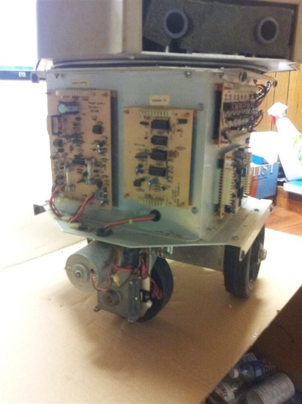

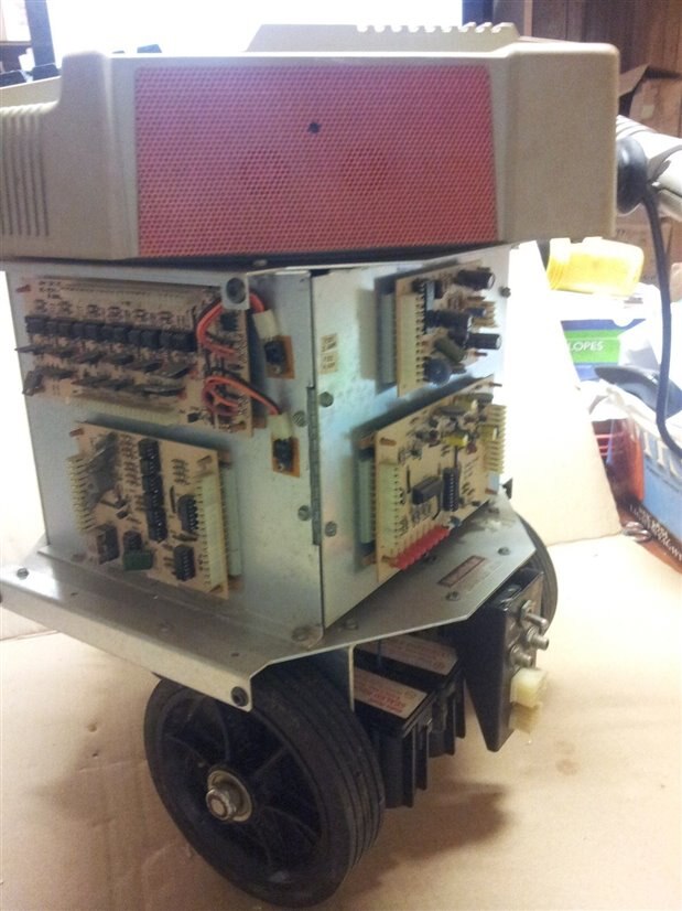

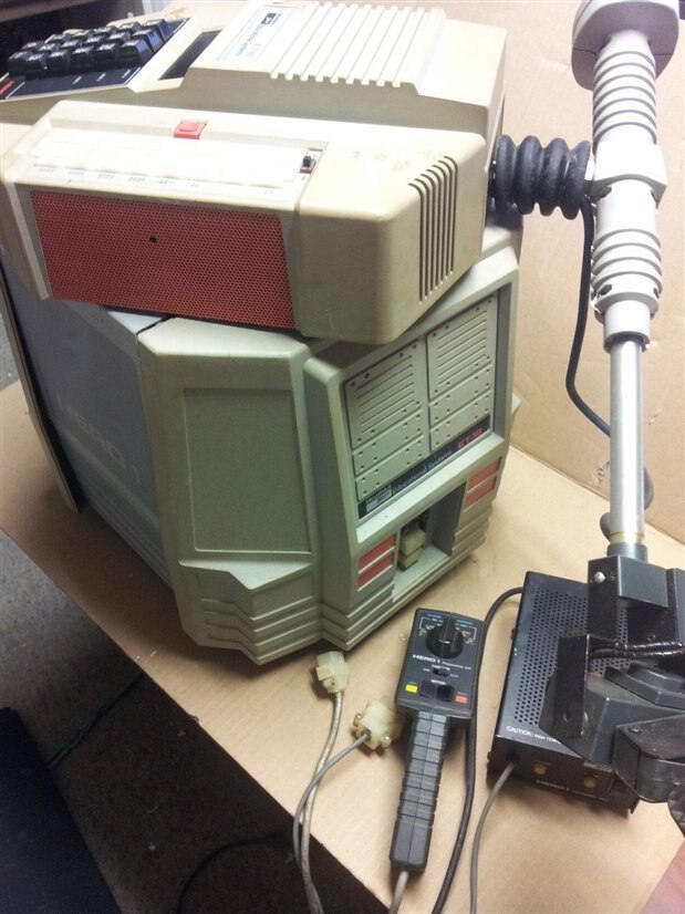

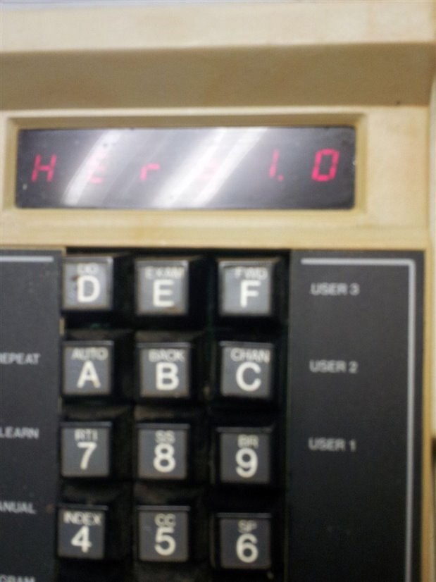

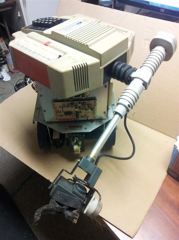

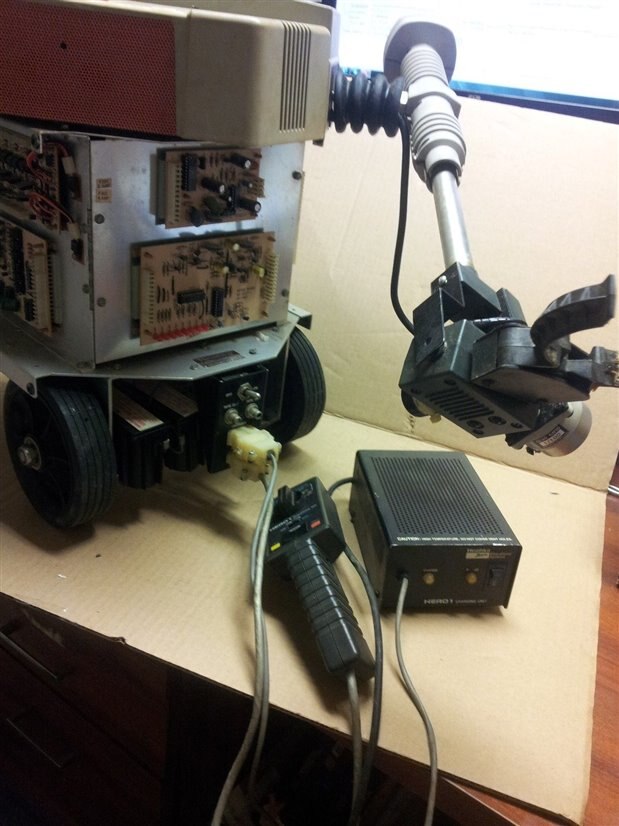

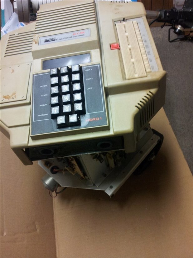

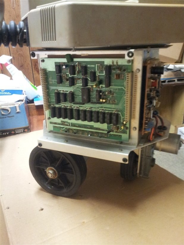

    Adding some photos - these are not mine, and I wish I knew who to ask for permission, but if anyone has a copyright on them, I'll remove them.
    The photos were publicly accessible in some e-bay listing a few years ago.

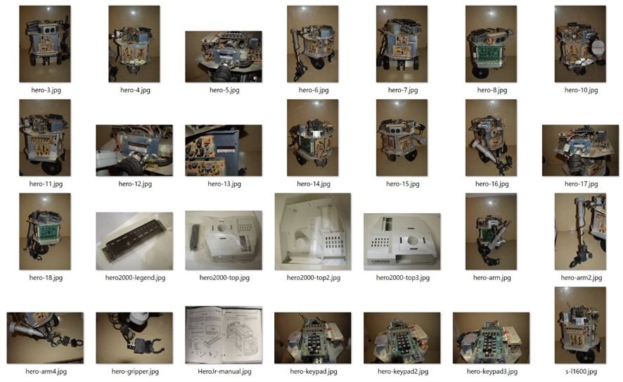

    shabaz over 7 years ago
    Just to add some more pics info.. unusually there are several HERO robots on ebay currently (at the usual high prices), but I was more interested in the photos.
    Since the larger pics may be copyrighted, there is just a thumbnails summary below, but anyone can view and download the photos from ebay until they disappear...
    There's more than enough information to make very good, and similar-looking if desired, modern replacements : )
