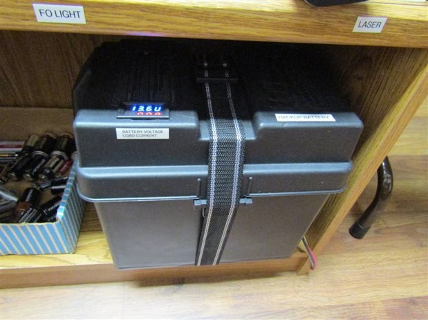

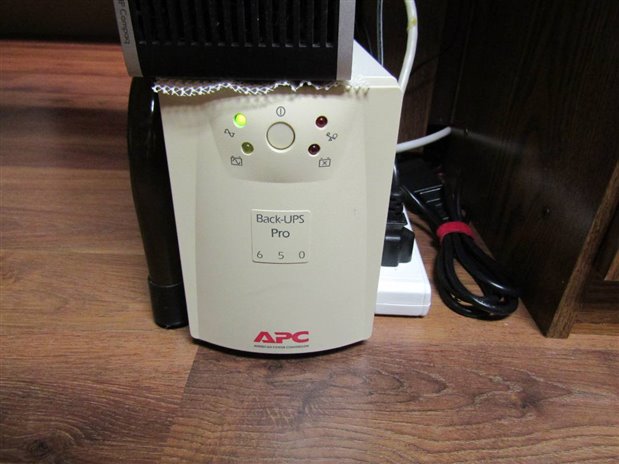

    It sounds like you have done a good job of analyzing what will work best for you. Personally I took an old APC and installed an external car battery. I have voltage and current monitors on the battery and I test it for proper operation monthly. I also have a separate APC on my Modem and Router which is tied to the local cable service. In the last couple power outages I was able to continue to work and monitor the weather on the computer without interruption. Here are a couple picture of my setup.

    jw0752 over 10 years ago in reply to mcb1
    Hi Mark,
    Yes, this unit passes the mains through to the units when mains is available and charges the battery to 13.6 volts. When the mains drop down it switches on the inverter quickly enough so that the interruption is not relevant to the computers power supply. I was not aware that there was a different approach than this.
    mcb1 over 10 years ago in reply to jw0752
    Most UPS use the mains as a battery charger, and the inverter runs the load using the battery (which is being float charged normally)
