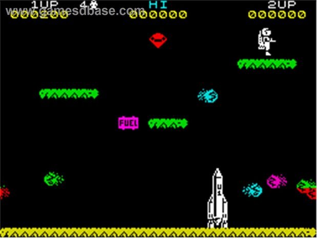

  • Workshopshed
    Workshopshed over 8 years ago in reply to jpickens
    Collect fuel, build rocket, avoid aliens... That sounds familar..
