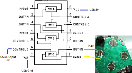

    It's an LED driver, but it seems like I might be able to wire up one side of each switch in the controller to accomplish this? It's just an 8 output board. But, how do you deal with the different grounds? The wiring diagram with the 12V external power source doesn't make sense to me, as the 12V source is over there and you're using the + but you're going back to - over here in this other place. It seems to think in the comment that you're going to run the 12V from the power supply in the same computer with the USB so that would probably make sense that way but in this case I have two different devices with two different supplies.
    So here's the crux:
    The Controller has a USB cable and is hooked up to device A (xbox).
    The board has a USB cable and is hooked up to device B (computer).
    The USB shield grounds ont he two devices have different ground potentials.So in this case, i tried using 4016s with inverters, but no dice. I wonder if the voltage difference is too great on the 74HC 4066 on the controller side since the controller is 2.4V internally and the USB on the other board is 5v. The circuit with the 74HC 4066 works, on the logic side I'm pulling up to 5v, do I need to do something similar on the controller side? Is there a better way to do this?
    Do I need optocouplers?
    I mean the board I have is essentially a selectable 8 output board, and it selects outputs properly, and I can control that in software and measure it.
    But it doesn't register button presses on the keypad. if I just short the two wires together that I have soldered to the pad, it works fine.

    After a little probing it's clear that there is more going on that switching between 0 and 5v, how did you wire the 4066's? If you used both sides of the pads for each it shouldn't be a problem, if you wired one side to 5v or ground and the other to the pad that would be the problem. If not then a little more investigating will be needed image
    e14 Contributor over 15 years ago in reply to e14 Contributor
    The output from the driver board goes into an enable line, with a pullup. That part works perfectly. The two pad lines are on the other side of the 4066. No dice. I think cos the pad side is 2.4v and the other side is 5v and the 4066 uses a transistor, there's too different a voltage diff. I think the optos are needed? What's funny is I've talked to 3 EEs and I had one here and no dice. This shouldn't be that hard, should it?
    Or maybe I just need pulldowns on the controller side since they are going low. But I shouldn't have to if I have the two sides of the same pad on that side, and yet that doesn't work.
    Just to clarify you have it wired like the image or have tried it like that?
    The voltage doesn't matter because the transistor is acting as a switch you could switch it on with 5v and be switching 100v on the other side, theoretically.
    If you haven't tried without the pullup/downs I would try that. I don't see why it wouldn't work unless the switching frequency of the signal is higher than the switch will pass?
    Yeah that's right, that's exactly right. I'm using a pullup on the control side, and I figured I wouldn't need anything on the other side. I know that transistors have a drop across them, no? And maybe if the drop is 1.2 volts or whatever, and the source is 2.4v, that it's dropping too much? that's all I can think of with that.
    As far as the switching frequency, I'm switching via software and the control side, and leaving it. It switches and I immediately see a change to high on the other side (the board goes low and I'm using an inverter). If I meter the out/in pins on the other side, there is no continuity when off, and continuity when on. However, if I have the controller pads wired to the in/out, nothing happens. However, if I just short the wires together everything's fine. It's sort of baffling.
