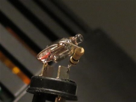

I have my first set of studio strobe lights that have been sitting in the closet since I upgraded to alien bee's b800's and I'd like to pull them out of the closet due to their compact size and punch they deliver given their size. The only problem is they do not have a fast recycle time on full power and the indicator lamps are the only means of letting me know when they're ready to fire. So what I'm looking for is a simple basic 5 minute video from Ben, or a quick post from anyone who can assist which covers in detail how I might be able to acheive my end goal. y en
My end goal is to create an audible beep when the flash is ready (fully charged)
How I hope to accomplish this is tapping into the indicator lamp wires. From testing the lamp sits at 0.02v during the charge period, and then it ramps up anywher between 70V and 120V roughly.  I'm not sure exactly when the lamp kicks on because I think my $10 multimeter doesnt have the speed/resolution I need as the voltage climbs in a not so smooth manner. When the flash fires a shot, the lamp cuts off ( I think it ramp's down either that or my multimeter updates really slow) and it starts the charge process again sitting at 0.02V.

    these sound like Ne2 bulbs, they normally have a trigger voltage of about 90v and are quite high impedence up until they strike up, and are normally fed with a high value resistor (100k +).
    one idea would be to use a Low value resistor in line with this Ne2 bulb (say 1 or 2k) and use the P.D across it when the bulb lights, to trigger a transistors base, which will in turn activate your buzzer/beeper unit.

    there is a resistor tied into the bulb, so im guessing it's what you say it is. here's a close up shot
    The bands are brown black yellow.  I was thinking of tapping directly to the 2 metal bases on the black plug and running that to a transistor but I was thinking, I want it to only beep once, so I was having trouble coming up with a way to charge a capacitor when the transistor is pulled low, then when its high, dump the capacitor out to my speaker (with bits in between to not blow the speaker/buzzer) but I'm an extreme novice and don't have a bunch of parts nor electronics to really scavange from at the moment. But I thank you for your reply, I'm sure someone's got just the diagram I need, I just need them to post it here, or have Ben take a stab at it. image

    That is a 100K resistor that I mentioned, what you would need to do is find the Negative side of the bulb on the board, and put an additional 1-2K resistor in series with what you already have, and then Across that resistor the most Negative side would go to the Emitter if an NPN transistor, and the Base of that transistor to the other side of that resistor.
    this will give you a full negaive voltage terminal to use against any low voltage positive, with which you can do your beeper thing.
    you don`t want to put anything Across this bulb or its feed, unless it`s really high impedence, a small resistance can stop the bulb lighting entirely!
    a non-invasive series connection would be your best bet in my opinion.
    as for a single beep, well that would be another issue entirely, unless you wanted to use the Ne2 in a Relaxation Oscillator mode? or some sort of One-shot monostable?
