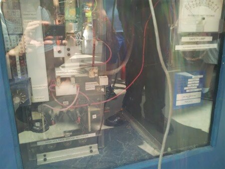

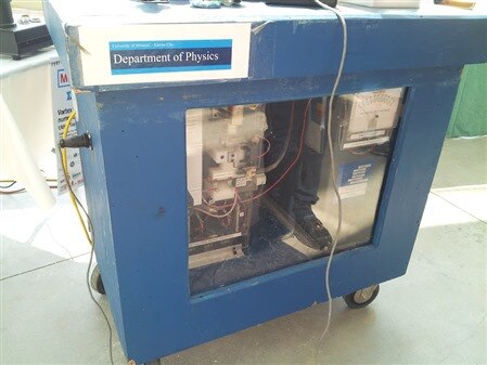

    This is how the Physics dept at the University of Missouri - KC did it at Maker Faire Kansas City : www.youtube.com/watch Can you tell it gave me a suprise? Here's a view of their device: Look at that…
  • fustini
    fustini over 14 years ago
    This is how the Physics dept at the University of Missouri - KC did it at Maker Faire Kansas City:
    Can you tell it gave me a suprise? image
    Look at that nice cap!
    The student running it said they also use it to shrink quarters!
    Cheers,
    Drew
