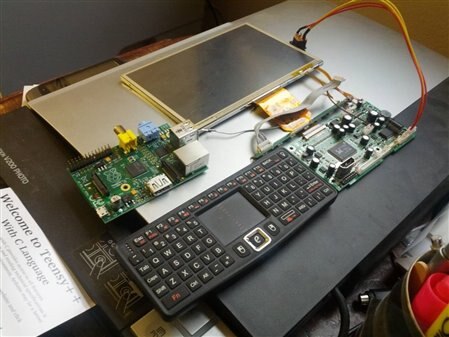

    Here's a pic of a setup I'll build eventually. Raspberyy Pi, 2.4GHz wireless keypad (needs dongle). Asus N-10 Wi-Fi dongle (not shown) 7" LCD with touchscreen and HDMI from eBay.

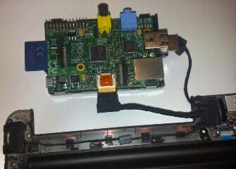

    e14 Contributor over 12 years ago in reply to fustini
    I have been developing and testing a direct Pi Lapdock connection.... Still a few problems... Lid closed power out.... Potential solution : super capacitor....... Second problem... Burnt out D1 on Pi. Solution might be to wire the USB power to the HDMI pin 2 to provide the required current.
    Don't actually know why HDMI pin 2 requires +5volts?
    e14 Contributor over 12 years ago in reply to e14 Contributor
    Above direct connect cable...
    Other photos of my test boards at @OpenECommunity twit
