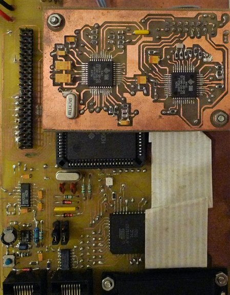

    If you really want to go through the home-made PCB route (I stopped after a while, it was just too much hard work! ; -) and you're pursuing the non-CNC method, then step 1 is to confirm you can create a very opaque image on a transparency, by holding it up to a strong light. If you cannot, you should stop right there - otherwise it is just a wasted attempt at photoresist, chemical etching, etc.
    The opaqueness is really key to a good result. If you can achieve that, then you can create very detailed boards fairly reliably.
    For example, here is a photo showing two PCBs created with a professional photo-plot, but with home exposure and etching. They are both double-sided (with wires linking the holes), and you can see the lower PCB has some fairly fine tracks. It looks oxidized because it is quite old and was not protected. It still works (it was the last board I ever did with home etching). Some people print multiple times over the same transparency, to get it extremely dense. It really depends on the printer and type of plastic sheet. I've used a photocopier in the past (special plastic is required, otherwise it will melt).
    The key point to Stage 2 is to ensure that you're using pre-sensitized boards. The spray-can method works, but it is hard to be consistent from one attempt to the next.
    The key point to the chemical etching stage is to use a warm bath and some occasional agitation. Otherwise, it etches too slow and eats up the thin tracks. There are small heaters in a test-tube-like enclosure that are fairly low cost.

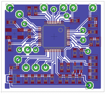

    I'm in the process of designing a PCB that I plan to etch myself.  How do you get the copper ground plane to be separate from the pads and parts that aren't connected to it?  So far, in my board layout, only the wirepads seem to be separated from the ground plane.  Everything else seems to run right into it.  Is there some kind of script I need to run to format this thing for etching?
    Thanks!
    shabaz over 13 years ago in reply to mikemoretti

    Generally, with EAGLE, for a ground plane, all you need to do is route the board (manually or automatically) then
    draw an outline using the 'Polygon' icon, and then  name it the same net name as your ground plane
    (e.g. 'GND'), and then click the strange icon that looks like an 'X with blobs' (when you hover over it,
    it says 'Calculate shortest airwaves'). This will lay a plane around all your existing traces, without touching any except GND.

    I did exactly what you mentioned, it lays a plane around them but it touches everything except wirepads.  Here's a picture:
    You see all those smd resistors and caps?  The pads where the routes are touch the ground plane because the ratsnest tool didn't isolate the those pads on them.  Yet it isolated the ones on the wirepads.  It makes no sense to me.  These are standard 0603 resistors and caps I got from the "rcl" library.  Maybe I should've put all my traces on the top layer?
    Thanks!
    Hi Mike,
    Yes, basically your SMD devices are currently on the top layer (because they are in red), but the traces are on the bottom layer (blue), so they
    are not touching.
    There is a similar problem with the IC, because it is on the top layer, but the tracks are on the bottom layer.
    Ordinarily EAGLE will automatically identify this and won't allow you to do this. Did you draw the schematic first, and then change the yellow airwaves into tracks?
    (If you skip the schematic step, there is a chance for a lot of errors to occur).
  • mikemoretti
    mikemoretti over 13 years ago in reply to shabaz
    Ahh, I see.  Yeah, I drew the schematic first and then had it generate the board.  Then I manually placed the routes.
    Now that I've messed around a little more I can see that I will need to put my traces on the Top as you said and it looks like it works perfectly.  Thanks!!!

    By the way, since this is going to be a home-etched board and likely single-sided, the green pads will be on top only too, so any wires that you connect will have to be fed through from the bottom of the board and soldered to the top, same as the SMD devices, or perhaps solder in some pins but from the top.
    In the photo in post number 7, I actually had the same problem with the long DIL header you can see at the top-left of the board. What you can't see is that I had to lift the header quite high and solder it from the top side of the board, so actually that header is raised somewhat from the surface of the board. It's rather messy but is fine for a prototype of course.
    The board you can see mounted on screws hasa DIL header soldered from the underside (you can see the parallel row of soldered joints near the top of the board).
    So, home-etching does have some challenges ocassionally, due to the absence of through-hole capability. At the bottom of the large board, you can see near a nut that there are many solder blobs; these were through-hole bits of wire. Again, rather messy but works.

    I notice on your board you either have a huge isolation value or orphans is off (lots of etched away space in the middle of the board around the chips and the things connected to them).  It looks clean.  I may need to do that too depending on how this all comes out (instead of having ground EVERYWHERE).
    Thanks again,
    -m
    You're right, to be honest that board may not be EAGLE, or may be done by hand. I think I was just trying to save a bit of etchant rather than have a ground plane (possibly the underside may have one if it is dual-layer). It was a very long time ago (I experimented with quite a few CAD packages over the years, but eventually stumbled upon EAGLE from version 4.x and I've been using it ever since (although I do occasionally use some other packages).
