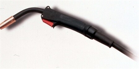

So a roll of solder is on the side of the solder station. Solder is fed to the tip by a series of brackets and a servo. A sensor will be used to tell when to start feeding solder and stop feeding it. You could also use a remote and feed it yourself. A sensor will also be on the station as well and will be used to retract the solder when the station is powered down. Thanks for reading!

    it sounds like you trying to do something like this
    feeding filler wire through a tube can be a pain, softer wire may cause more problems. MiG wielders push the wire through a tube, I suspect this will not work with softer solder. you would have to pull it from the iron, or mount the spool directly on the iron handle.

    A motorised feed which pulls solder through a guide attached to the soldering iron so it  advances through the guide and is fed towards the soldering tip and thus the joint. Speed of advance to be controlled via foot pressure switch.
    As some one has already said it would be like the wire feed on a welder.
