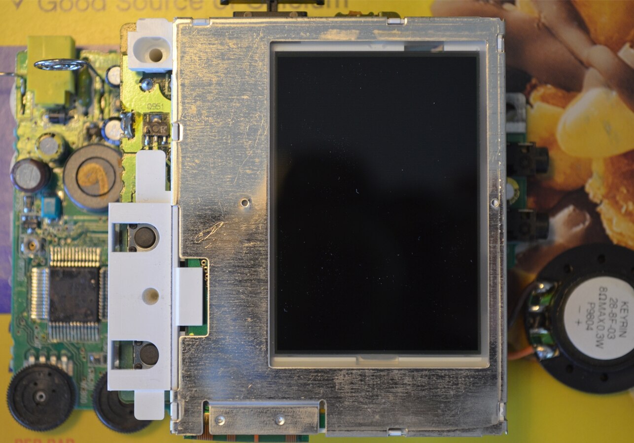

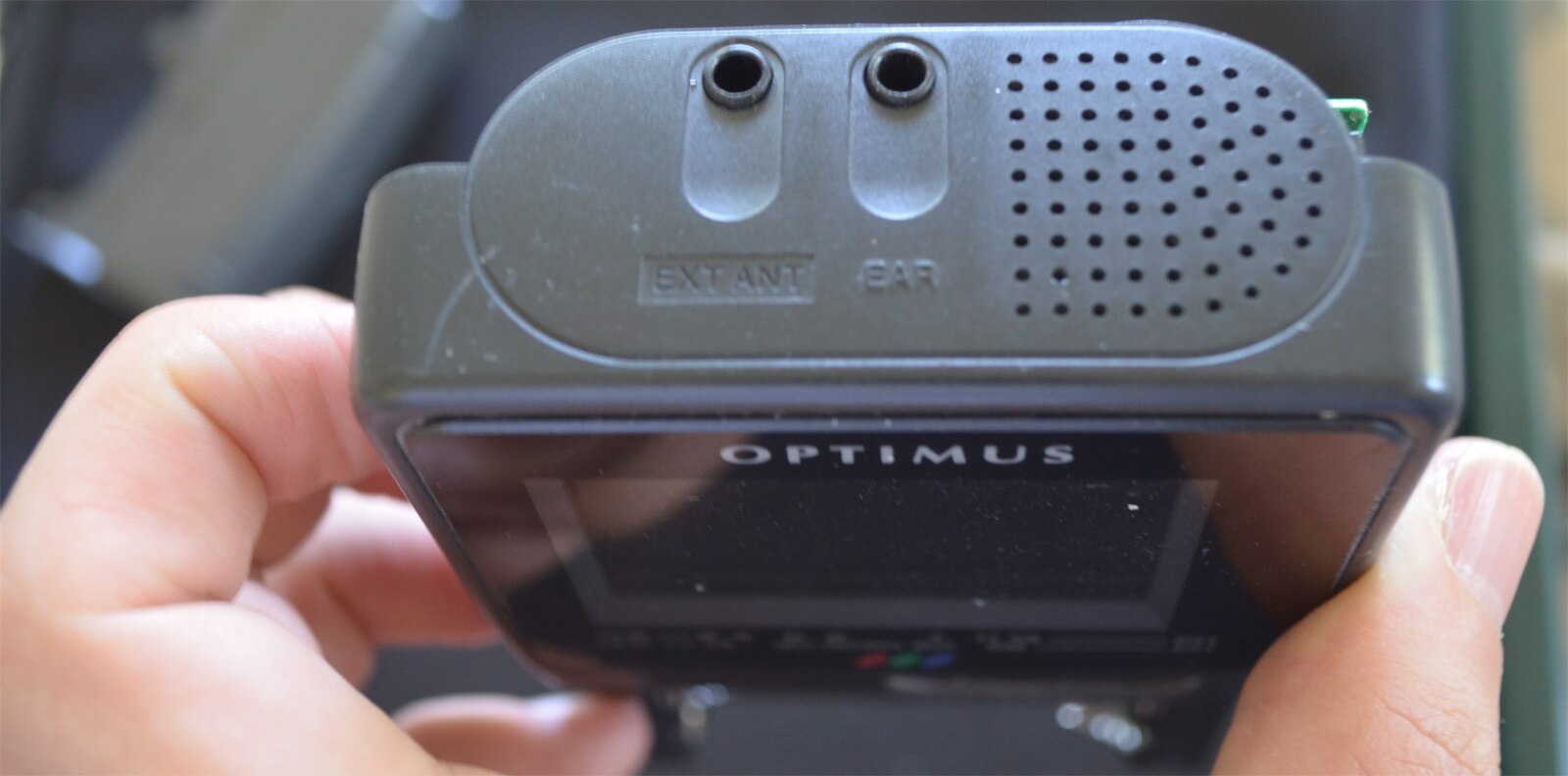

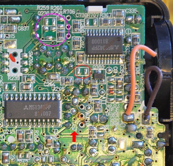

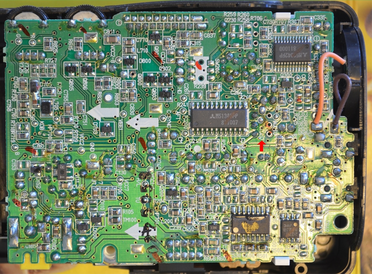

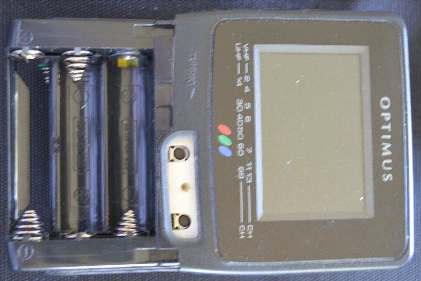

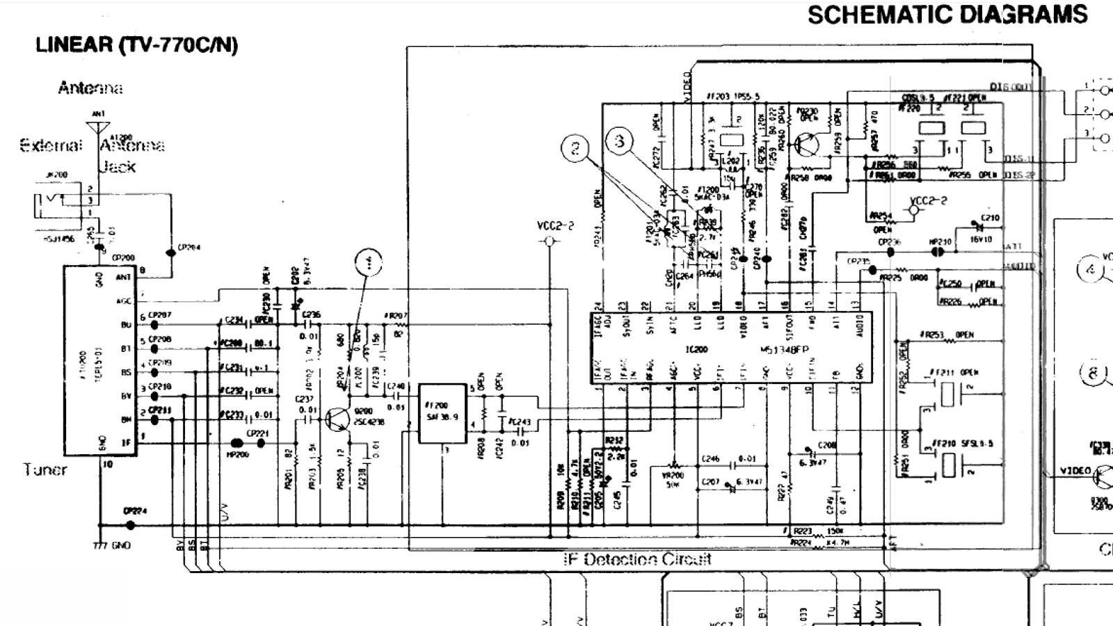

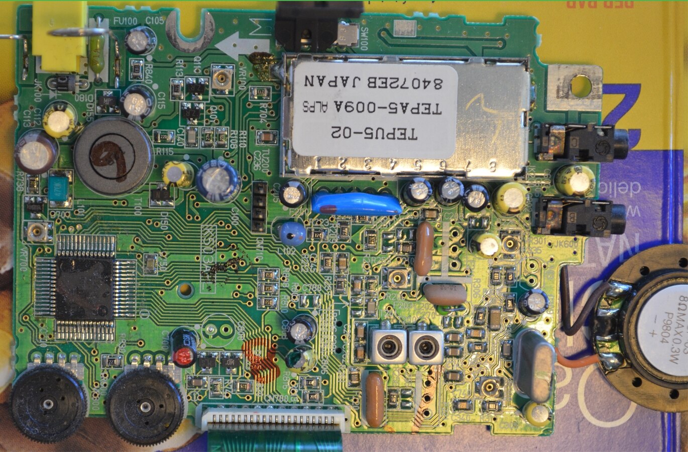

Hey Ben,
I'm trying to find a way to add composite video to an old OPTIMUS portable LCD TV for a Raspberry Pi project, but information is scarce.
Then I found out you used to use them on old portable game console hacks.
Here are some pictures of what I'm working with, do you think it's possible?
Rov
    shabaz over 11 years ago +4 suggested
    Hi Rovert, Check out the data sheet (PDF) for the Mitsubishi M51348FP IC on that board, you can see there is a ceramic resonator (probably the one above the two cans in your second photo) and you could…
    shabaz over 11 years ago in reply to RovertScott +1
    Hi Rovert, I was originally thinking lift the resonator on short wires, remove the wire that is connected to pin 18, and connect your video feed (via a 10nF capacitor) to the pin on the resonator that…
    0 shabaz over 11 years ago

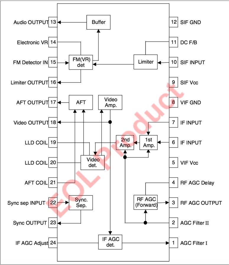

    Hi Rovert,
    (probably the one above the two cans in your second photo) and you could try to feed the signal into there
    (temporarily break a track or lift that resonator out and extend it on very short wires and use a capacitor (e.g. 10nF) in series with your output from the RPI)
    - try both ends, one should work, and ground is the center of that part.
    Bear in mind you need to enable the composite output on the RPI (it defaults to HDMI) - or use some other composite signal source for now.
    EDIT: Now I look a bit closer, it appears this could have been the areas where additional stuff is needed for the model with A/V input -
    see the photo below, the red circled area is possibly where the video wire was connected, and the pink area is some level adjustment perhaps,
    but is missing in the BoM for this model. Possibly SW200 (the white area on the left with the red marker paint on it) was used to control it.
    In the absence of a circuit diagram it would be hard to know for sure.
    Anyway, the ceramic resonator method mentioned above hopefully could work - it won't harm anything to try.

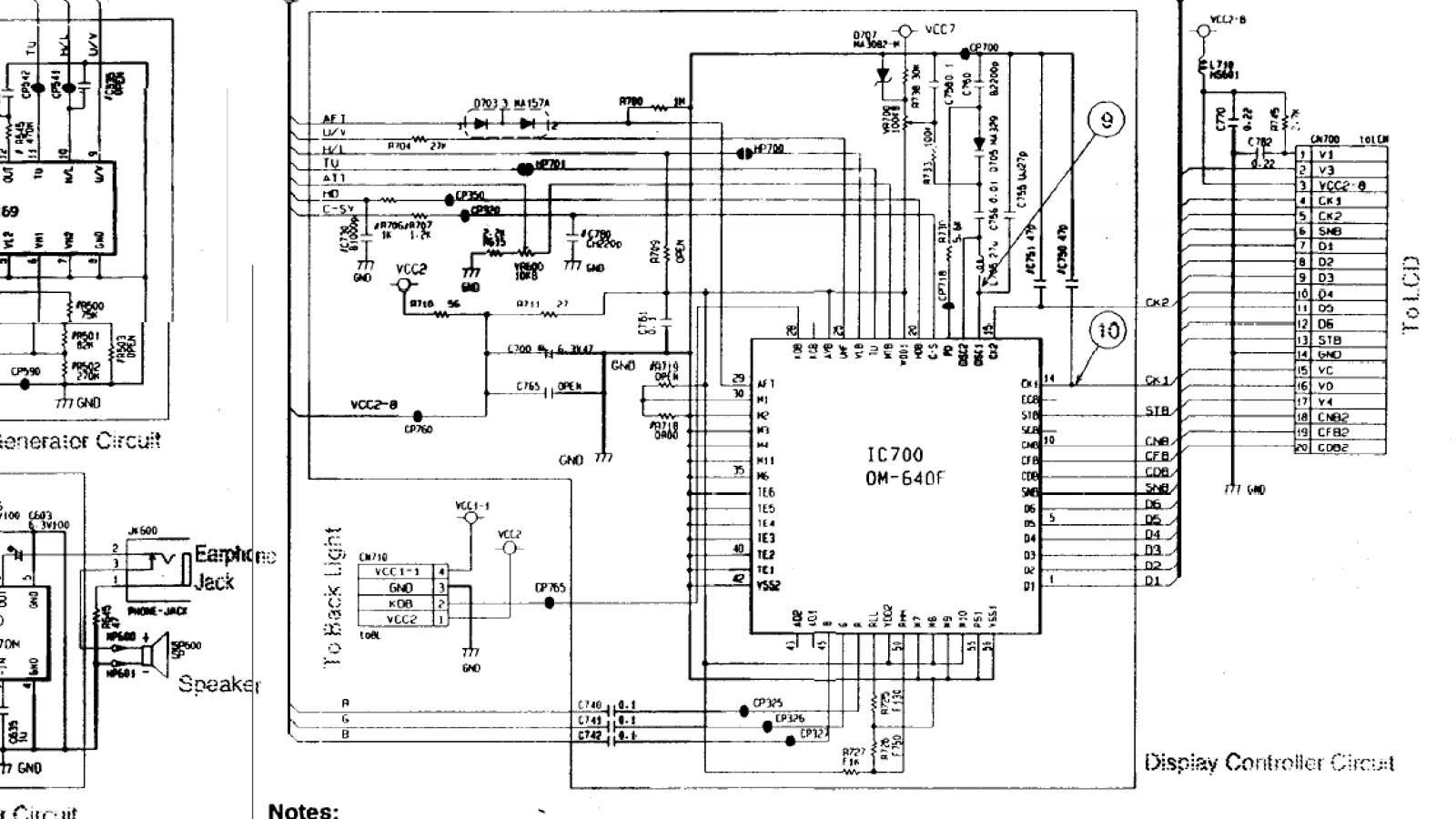

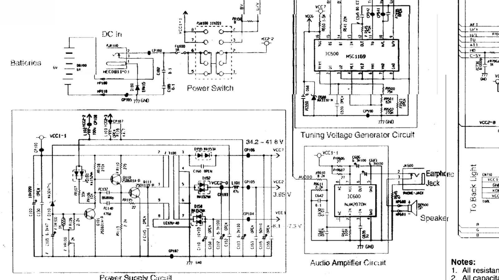

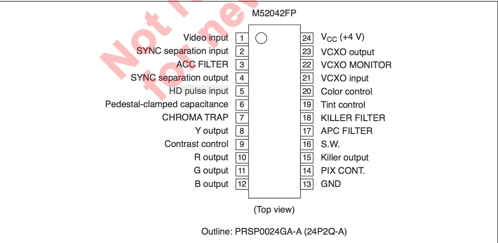

    0 RovertScott over 11 years ago in reply to shabaz
    I used my multimeter to check the continuity of those pads and it appears that half of them are connected to ground.

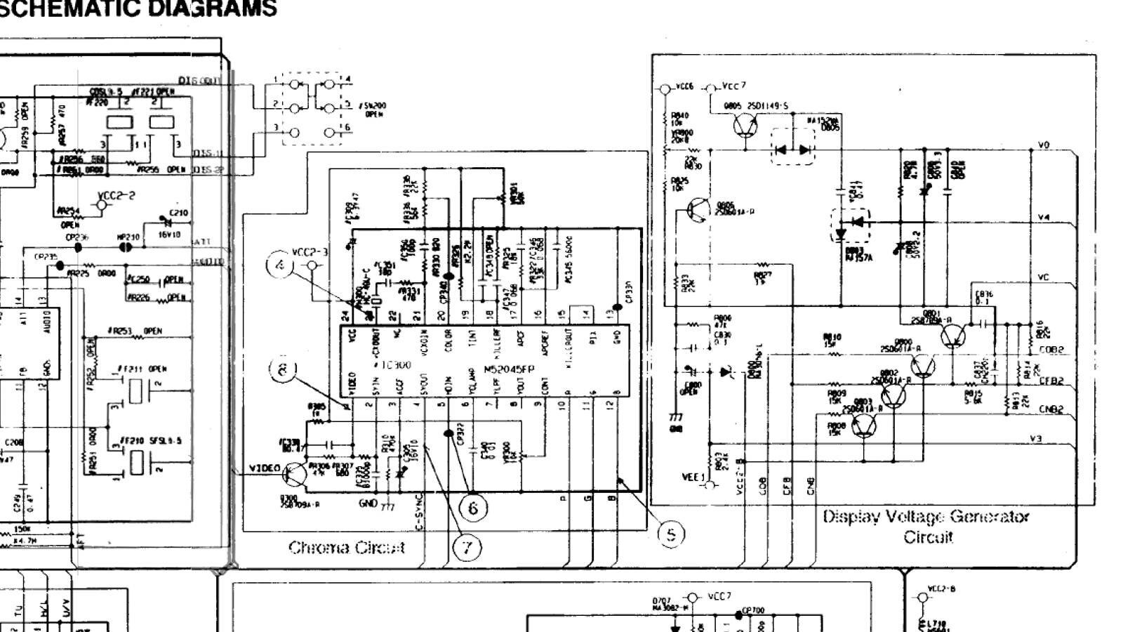

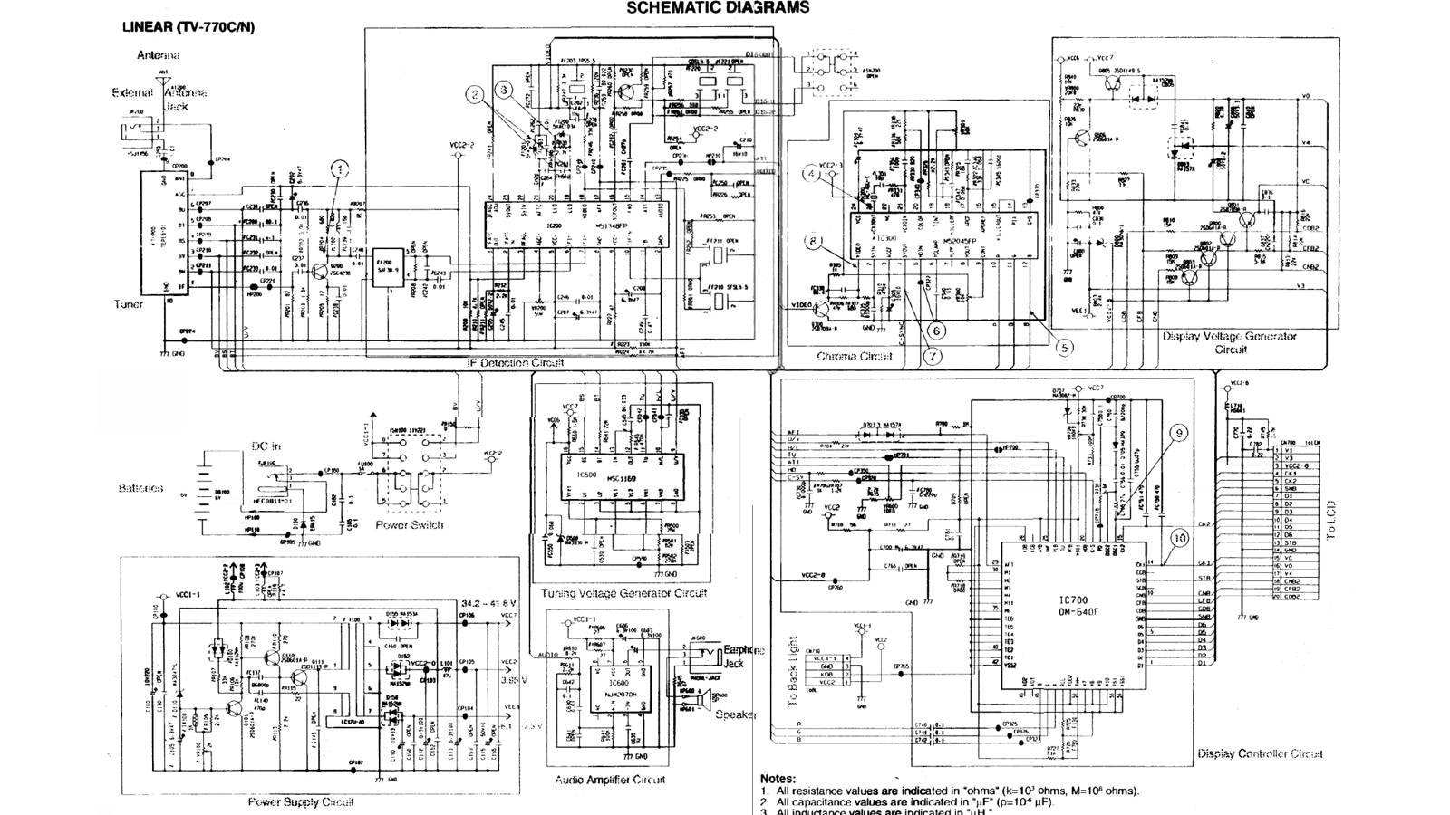

    Thanks to the datasheet you found, I know that the M5204FP converts the Composite signal to Component for the LCD.
    The M51343FP, however, converts the RF Signal to Composite.
    If there was a way to input Composite signal, the first step would be breaking the circuit by inserting an A/V Jack.
    Then I'm assuming the chip that controls the channel selector automatically switches to INPUT mode.
    That's the first issue, I need to find a way to get to INPUT mode.
    0 shabaz over 11 years ago in reply to RovertScott
    Hi Rovert,

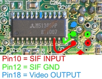

    I think you mean M51348FP, not M51343FP, right? (the text is hard to read on the IC in the photo).
    The pin 18 goes to one end of that ceramic resonator I mentioned, according to the schematic, so you could lift a pin there (in practice you'll need to lift out the entire resonator and place it on very small wires) and you'll be able to feed your video signal in there (i.e. isolate pin 18) so that it no longer goes into the ceramic resonator.
    It might not work (depends on levels) but it is worth a try - may be easier than trying to decipher how the A/V input functioned on the other models, because it appears some of those components are missing on the board.
    I went back and tested the pins for continuity.
    So, you're suggesting I remove the resonator and solder a wire to the blue solder point?
    I'm also currently trying to follow the "Blue Line" and mark out where it's going.
    Sorry if I'm being too cautious, I want to learn what is going on while preventing myself from making mistakes that might fry something.
    Hi Rovert,

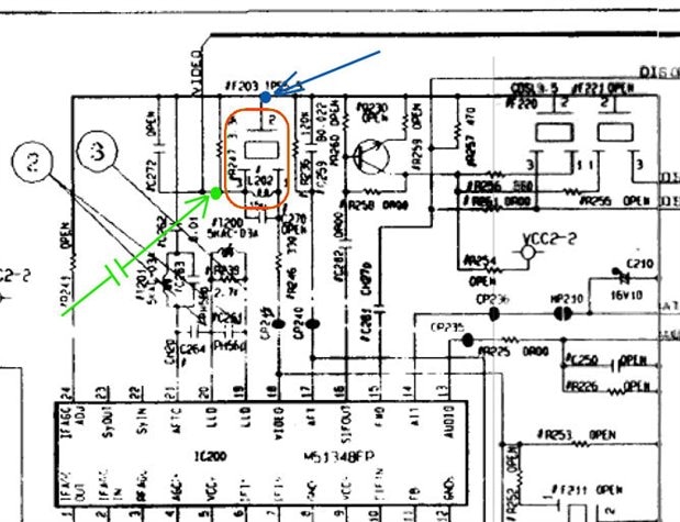

    I was originally thinking lift the resonator on short wires, remove the wire that is connected to pin 18, and connect your video feed (via a 10nF capacitor)  to the pin on the resonator that was connected to pin 18.
    However, it is unnecessary, and easier still, just entirely remove the resonator, and connect your video feed (via a 10nF capacitor) to the pin on the resonator that was not connected to pin 18.
    And ground will be the center hole where the resonator was.
    You can't destroy anything by probing around in that area, as long as you have your 10nF capacitor in series.
    Once you have lifted out that resonator, the screen will likely entirely dim (i.e. no more snow, since the demodulator and entire RF section has been removed by your action of removing that part).
    Then when you have a composite video feed on the pin that was not connected to pin 18, you should see something - hopefully.
    EDIT: Just saw the schematics, you will also have to remove L202 which is that green part right next to the resonator.
    EDIT 2: On second thoughts, leave L202 there and try it first. If it doesn't work, remove L202. No risk of damage occurring in either case.
    Just to make it clearer, this is your goal; you want to remove the bits in red (resonator and inductor L202), because this will isolate pin 18 of the integrated circuit.
    Then you want to feed your video to the point marked in green (via a capacitor), with your ground connection being the point marked in blue.
