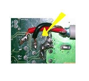

I watched all the episodes where Ben builds an xbox portable. When he is working on the Atari one he shows how he wires up the audio so I followed that as a guide.
This is what I did:
http://i.imgur.com/P7zd5l.jpg
And here is the shot of what Ben does during the episode:
http://i.imgur.com/QXsPkl.jpg
For some reason the analog audio output isn't workingon mine while the hdmi cable is connected and I am not sure what I am doing wrong.
Any suggestions or help would be really appreciate. Thanks.
    0 e14 Contributor over 15 years ago
    it looks like you soldered the black wire on the wrong pin.
    in ben's theres 3 pins then the first wire (red in your case)
    then 4 empty pins
    then 1 unsoldered pin, then what looks like two connected to the same wire (in your case the unshielded one)
    then after that you should solder the black wire to the last pin on that row.
    try this and post back if it works or not.
    Probably solved, but for archieve : Move the black wire to highlighted pin
