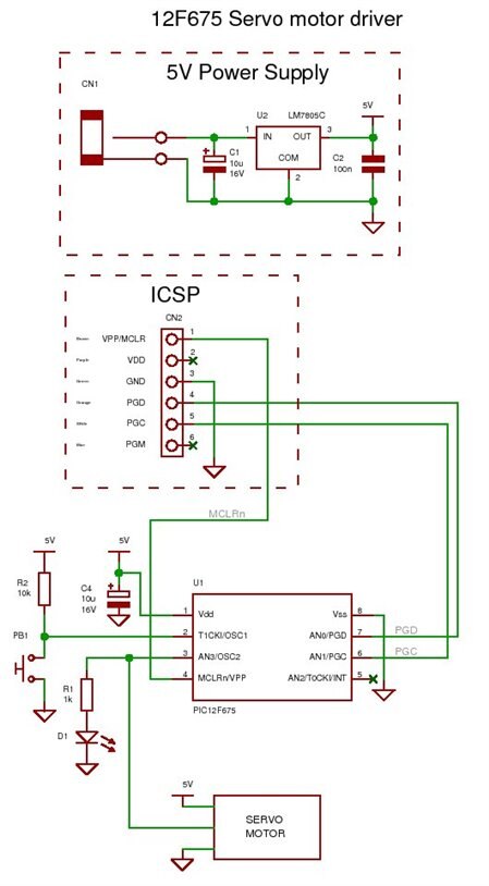

    If you are just sampling the sound for analysis for the system, then I would recommend a data acquisition module or analogue input of a micro-controller. > Analyse the data as needed > the micro-controller can then control the servo motors.
    You can get away with controlling one servo motor with a PIC 12F675PIC 12F675, while also sampling analogue data from 1 - 3 other sources.
