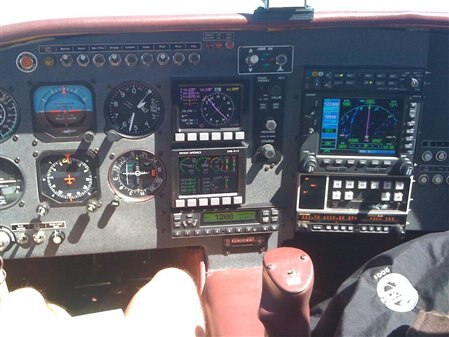

    Shawn, thanks very much for an intelligent and complete response.  image
    My professional background is in the server industry, where I am an engineering manager in a major server supplier.  I've got quite a bit of background in both the design end (mostly ASIC and custom logic) and more recently in the supply end where I manage NPI (New Product Introduction) engineering and test engineering for basically all the cards (planar and otherwise) that we use.  I've got quite a bit of background in what I would call Server level quality issues - design for manufacturability and design for reliability included.  If I were to be bold, I'd say that commercial Server quality requirements are somewhere betweeen commodity product (your ipad) quality requirements and what you deal with - Aerospace quality requirements.  For the record, I worked my way through college as a technician constructing space and near space based high energy cosmic ray experimental packages.  This work required NASA certification for soldering and wiring techniques.  That's about as close as I can claim to what you are clearly an expert at - the requirments for the true Aerospace industry.
    I also have over 20 years experience building and maintaining experimental aircraft, and through the years I've wired many aircraft, and even built quite a bit of my own avionics systems (mostly digital engine analysis systems).  I'd lay out the operating characteristics of these kinds of planes as follows:
    Altititudes range from 0 - 17,500 feet
    Temperatures (in the cockpit environment, where the avionics live) range from maybe 10 - 90 degrees F.
    AFA humidity, shock/vibration, corrosion (exposure to high salt environments, etc.) - I can't give a clear range.
    Avionics systems, even the off the shelf radios we buy and install are typically use standard "D shell" connectors.  Reliability issues I've had with these radios seldom have been connector related - more commonly issues have to do with bad switches, internal batteries, and sometimes display issues.
    In my current panel (picture attached) you will see off the shelf avionics supplied by Garmin, Apollo (a company later purchased by Garmin), Dynon (a supplier to the homebuilt avionics market), and Century (an autopilot manufacturer).  I've been inside the Garmin boxes - my experienced eye would say they are using what I called Server quality levels of construction (at best... some of the things I saw, especially the way some of the cards and components were mounted, were surprisingly bad from a vibration resistance standpoint).  As I said, all of the boxes, including the Garmin (which are FAA certified for use in what we call storebought airplanes) use d-shell connector systems.  For the record, I use aircraft grade mil-spec wire throughout.
    One of the things I should have clarified at the start was that the GPWS - Gear Up! warning system I'm workinging on is (and will remain) completely redundant to the existing warning system that I've been using for over 1000 flight hours in this plane.
