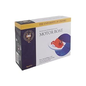

Unfortunately, I am a total noob in 3D printers and I don't know where to start.image I also have a oxford smart kit series motor boat. On the cover it says that you builld a powerful electric motor, is this useful enough for 3D printers? I know that it works a D cell battery so how shall I power it. Thanks a lotimage
