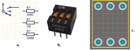

I'm having a little bit confused now. I thought it should be simple but I become clueless some how.
Refer to figure a. above, my question is how can I make a wire connection between 3-way switch A6E3101 (figure b.) and three resistors.
The switch has 6 pins, I assumed pin 4, 5 and 6 is for the 'on' state.
Please advice.
Thank you.

    The schematic does not match the item or footprint.  That is a 3way switch in the schematic but figure b and c are a 3position dip switch.
    Ignoring the schematic, if the switch is wired crosswise (1-4, 2-5,3-6) you should be able to wire 1 resistor each for the pins 4,5,6 up to VCC, then pins 1,2,3 are tied to ground.  Your signals will then be on 4,5,6 and pulled-up by the resistors.

    You are right, the schematic does not match the footprint. I'm using Altium designer, and the footprint was created by myself and I haven't made the schematic symbol since I don't know how it supposed to be look like; I just put the symbol I found in the library to make the question clearer.
    Anyway, can you tell me how does the symbol for the 3 position dip switch looks like?

    0 e14 Contributor over 13 years ago in reply to e14 Contributor
    or probably you can direct me to the component that really reflects the 3-way switch instead a 3 position switch?

    0 colecago over 13 years ago in reply to e14 Contributor
    I'm having trouble finding pcb type of 3way switches.  What you need to look for is a SP3T switch.
    http://www.newark.com/carling-technologies/2ge51-73/switch-toggle-sp3t-15a-250v/dp/24C1006
