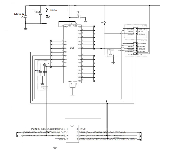

Hi all,
I found a schematic about a AVR development board and modified it with a 8 pin socket. Im a newby with electronics so i hoped somebody could tell me if this could work and if it doesn't were i made a mistake.
Hope to get a respond!

  • colecago
    colecago over 12 years ago +1 suggested
    Hard to read, but it looks good besides the crystal caps. Way too big, you need something more like 10-20pF typically.
  • steve25
    steve25 over 12 years ago +1 suggested
    Yes i noticed that after i uploaded it i am going to use 22 pF caps for that. Thanks for you're respond!

  • steve25
    0 steve25 over 12 years ago in reply to colecago
    What shall i do with the AREF pin? Just leave it open? Connect it to the ground with an 100nF cap? Ore connect it to the vcc like the schematic?
  • colecago
    0 colecago over 12 years ago in reply to steve25
    Tie it to VCC and probably put a cap on it as well.

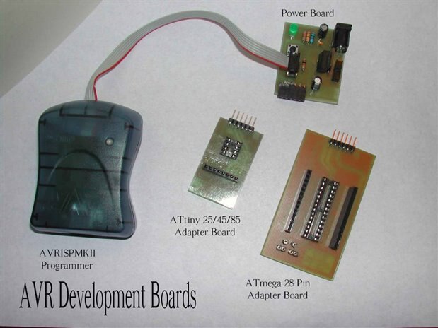

  • sparky2k7
    0 sparky2k7 over 12 years ago
    Hi everyone,
    Here is my version of the AVR development board that I made. It consists of AVRISPMKII programmer, Power Board which supplies 5V to the target chip for programming, ATtiny Adapter Board, ATmega 28 Pin Adapter Board and a wall wart power supply (not shown).
    I went with a modular approach where you can program various Atmel chips by making chip specific adapter boards.
    I have tested and verified the adapter boards work properly.
    If any one is interested in my design I will supply the art work and part list needed to make the AVR development Boards.
    Let me know..
    Thanks
    Sparky2K7
    • Reject Answer
  • benheck
    0 benheck over 12 years ago in reply to sparky2k7
    That's a cool setup!
