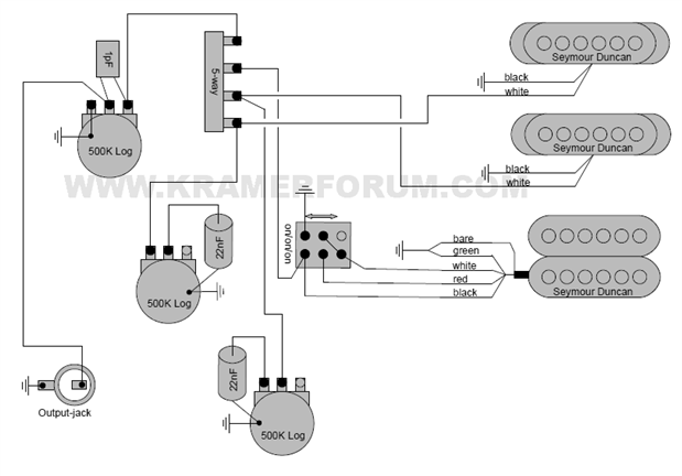

I know that this may be an unusual question for element14, but I figured I would ask people who know electrical theory first.
I have a Kramer 610 guitar that I am rewiring. I'm putting all new electronics in it, and have been looking at some schematics of how it should be wired. Specifically, this one.image
Looking at the schematic, it shows two 22nF capacitors, one on each tone pot. When I look at my guitar (and spoke with my uncle, who owns 8 other Kramers), it turns out that all of them seem to share one 22nF cap between the two tone pots by running a wire from the second post of one pot to the first post of the other, which also has the cap. I was curious to know how much difference it will make to follow how it was wired, compared to how it has been drawn.

    Personally,I enjoy Fender products,but especially StratoCasters;owning six so far. In the past,I have played a few Kramers,but never embraced them as much as I do other brands.  As far as the diagram versus your uncle's way of wiring depends on several variables;some of which are not necessarilly electrical/electronic. Having a cap to each tone pot will allow a wider range of tonality to each pickup;thus adding facets of timbre to each string. True,consideration should be given for style of play;equipment(amps,pre-amps,emulation boards,etc.) or if you're playing solo or in a band or whatever? Being a retired EEE,I can tell you in great detail what you might need to know? I played professionally until my last stroke 6 years ago and peripheral neuropathy was the final nail...

    Alright. I appreciate the answer. On my Kramer (which only had one cap), I figure it was Korean laborers trying to save time and money by only using one.

    Assuming that anyone is looking at this post, I just wanted to give a very belated update on the status of this question. After not taking up Mr. Goetz's generous offer of assistance (which I didn't catch earlier), I tinkered, and I played. And I found that there is a difference noticeable between having one or two caps in the circuit. I ended up wiring it with two. The main reason was that I had two available, and wasn't planning on another project of this sort for a long time, so using it wouldn't affect me that badly. The project turned out wonderfully, and I'm now excited to move on to building another (THIS TIME A MODULAR STRAT).
