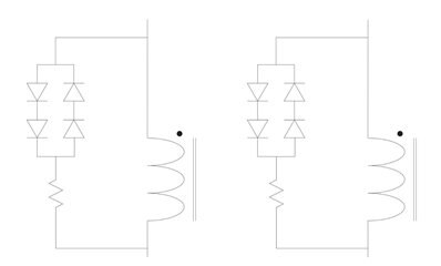

  • D_Hersey
    0 D_Hersey over 12 years ago
    Here is a cheap way to get a little idea of what is happening to your SM.  Each diode string consists of an LED and a reversal protection diode.  LEDs do not have good reverse breakdowns, so use a hundred voltish signal diode in series.  Use different colors.
    Ballast resistor can be Kish if dim, reduce (increase conductance)

  • fuzion_reaktor
    0 fuzion_reaktor over 12 years ago in reply to D_Hersey
    Any type of resistor or LED your recommend? I got a few laying around that might work, otherwise I'll have to get some.
  • D_Hersey
    Just use any old indicator LEDs, for the ballast try approximately 1K, any type will do, quarter watts if you got 'em.  A couple of 1n4003s for the back-up diodes would be more than adequate.  You can degenerate a bipolar transistor into a diode by connecting the collector and base terminals if you have those laying around.  Almost anything will do.
    I'd make it so that a red LED lit when coil A was energized in the positive direction.
    I'd make it so that a blue LED lit when coil A was energized in the negative direction.
    I'd make it so that a yellow LED lit when coil B was energized in the positive direction.
    I'd make it so that a green LED lit when coil B was energized in the negative direction.
    But, of course, it doesn't really matter.
