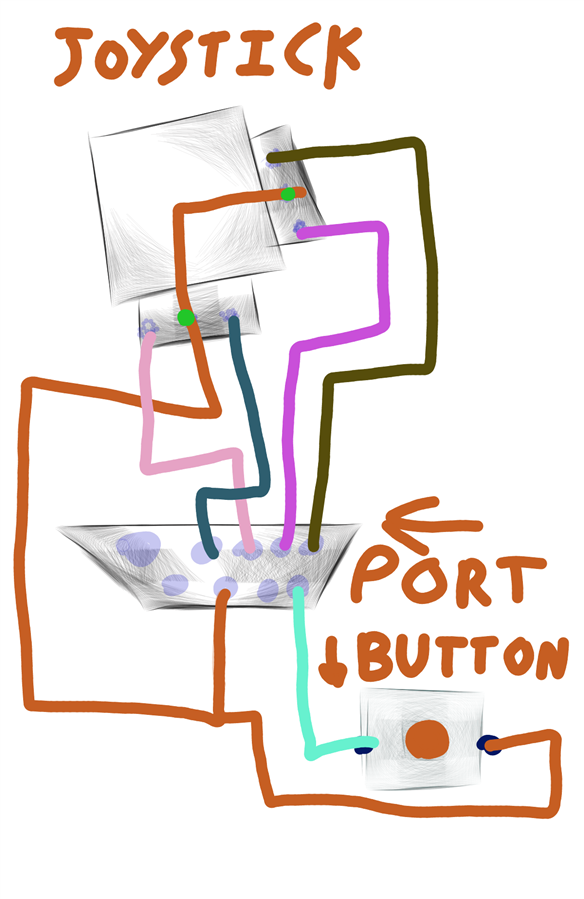

I have another question about my atari portable. I want to use this joystick, Thumb Joystick - $3.95 : FunGizmos, make something fun! but it use potentiometers. the atari use buttons. is there a way to use this for my atari portable or do i have to use a d-pad like ben heck. (I am using an Atari Flashback 4.)

    Hello again chuck. This site should do what you need. Console Modding Site - Using an Analog Stick in place of a D-Pad/Joystick

    how would i hook it up to an atari? heres the circuit for the regular controller in case you need it.Joystick information and circuits just scroll down some.

    Thanks, the pin out helped. This piout should work fine. Please excuse the awful drawing, this is the first time I have used this programming. The underside of the joystick is shown and the top of the page is up.image

    Thanks for the explanation I read further into it and figured it out. Now i will be able to finish my atari Portable.
    will post pic when done.also the joystick i showed you on the website earlier has a built in button when you
    push the knob down. can i use this as an optional "fire" button?image

    You could, just wire to the button in the diagram, however, I would not recommend it. A separate control stick and button is normally a must for comfort and convenience. Also, I often find myself pressing buttons like that by mistake. A simple button with a tact switch is almost always better.
