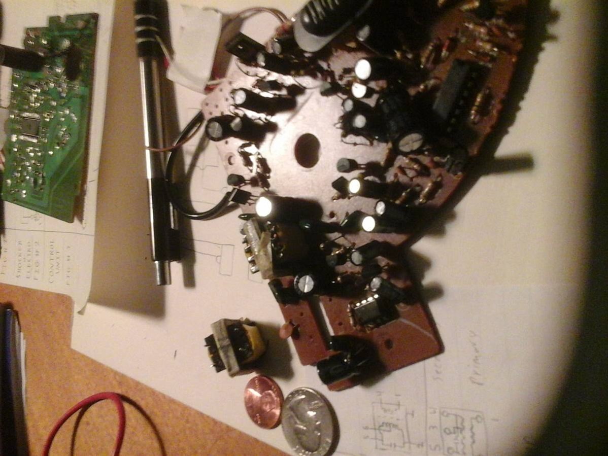

    Thank you very much, but can I adapt this circuit to use a 4pin transformer? I have two from an emergency dc powered flourecent light. Here's what I have and the actual circuit below.
    0 jw0752 over 11 years ago in reply to RovertScott
    Hi Rovert,  Your hand drawn circuit holds the key to why only a flyback will probably work with this design. Notice on the side of the transformer with three connections the center connection is not really in the center. The short coil is an important aspect of the design and isn't typical on most transformers. Don't get me wrong, there are many ways to do just about anything with electronics and there are probably ways to incorporate different type transformers to get a similiar effect but without better component information on your salvage transformers you are much better off spending your money to get the correct component as opposed to the amount of work to redesign the circuit. The other issue in this redesign is if the original circuit is changed and the shock your circuit creates hurts someone you and whoever helps you modify the design will both be sued. If you stay true to the original design then it will be just you and the instructables designer. Hope this helps.

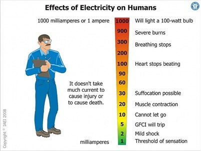

    here is an idea of the deadliness of electricity at 120V
