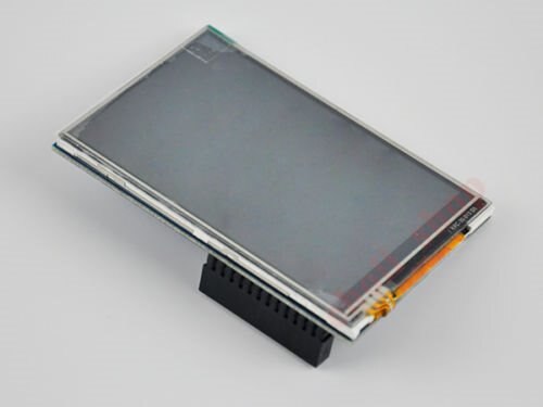

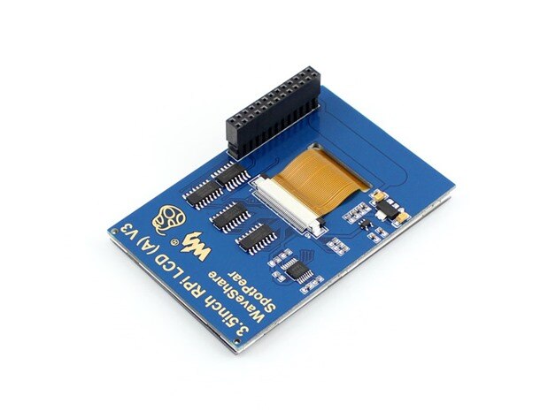

Hi Ben, long time watcher of the TBHS. Love it & you. Need Help with Raspberry pi 2 & LCD please!
e14 Contributor
Super new to the raspberry pi scene been watching you do various projects with them and figured it would be something new and cool to check out. got my noobs installed perfect now running raspbian.
been moving along following different tutorials trying out new things.
I finaly got stuff working on my Raspbian good and I'm starting to get a little more comfortable doing stuff on my Pi like, 1.) Installed apache and MySQL got wordpress working. (been tinkering around with it a little) also got a working copy of minecraft server vrs.1.8.4 working on my Pi.
Recently wanted to make it a bit more portable.
So I bought the 3.5" TFT LCD from Waveshare spotpear.
thought it was a no brainer plug N play with the Gpio
I pretty sure it is. but I cant seem to get or find proper soft ware, & or documentation to easily install it. there was no software when I got my lcd. it told me to go to few sites which were for the older pi.
I've read through few pages of peoples post seems a lot of new and regulars on the  Pi scene are having similar problems with lcd installations.
Currently My pi is running on hdmi to tv.
Best Related web page related info I could find so far Is http://www.wvshare.com/product/3.5inch-RPi-LCD-A.htm
Please say you can help figure this out.
Also, if anyone else who reads this if you also have a raspi2 w/ the 3.5" tft lcd Waveshare Spotpear addon card let us know if you got it working right and if so let  us know what you did or didn't do, please also provide software as I have been unable to find it.

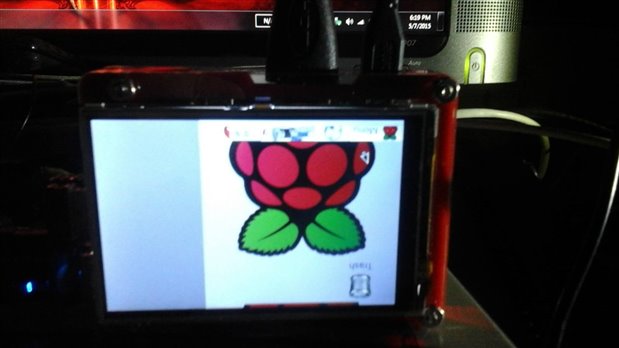

    0 e14 Contributor over 11 years ago in reply to e14 Contributor
    well tried your options, think I'm just not doing something right. As I'm still only getting a white screen. nothing else.
    is it possible for you to zip a fresh image with it all installed. and I can install that image on to my 16gb micro sd class 10 card.
    and see if it at least gets the screen to work?
    Found someone with same screen (they had a image) but they have old Raspberry pi. Do not know if that matters or not in this case.
    I had spare micro SD card so I applied the image to it. and it booted right up. not sure how but everything sort of works. But as this is I wont be able to use my own image or fresh copy of raspbian, or Ubuntu if I wanted to. I would not know how to make that work.
    So if I want to use this 3.5" lcd it looks like I'm stuck using this guys image. image
    But image  happy image to find out that the LCD does work so does the tft part. the windows in the desktop environment are really hard to navigate due to resolution not sure how to make the windows
    fit the 320 x 480 resolution.
    Also another bummer with this image is I can not use the HDMI port anymore. image
    not sure how to make both work at same time or if they can even do that.
    Tried to attach the image so you guys could check it out. but the size is over a 1gb even after I Rared it. image
    any ideas on any of these issues would be great. thanks for all the help so far.
    Finally got a moment to work on this..
    so I am following your instructions..
    at the fbcon=map:1 fbcon=font:VGA8x8 section
    I left this out as I want to be able to use either 3.5" or the hdmi
    if possible I would like it to work on both simultaneously.
    or be able to detect when I have hdmi plugged in.
    ok so made it further down before I ran into a problem..
    the sudo nano /usr/shar/X11/xorg.conf.d/99-fbturbo.conf does not seem to exist & wont let me save to create one.
    I have stopped at this point do to the fact this appears to be important.
    I do have a black screen now when loading btw.
    I checked some of your directories and found the problems.
    you left the (e) out in /usr/share/ part that solved that problem
    Ive finished it but cant seem to get the screen to flip or rotate in the upper direction.
    its upside down for me. I tried changing rotate but it would reboot with partial screen working
    Ok, when I run into an issue like that I start by cd'ing to each directory in the list and making sure they are all spelled correct. image
    it's "share" not "shar" If what you entered above is a copy of your line then you forgot an e.
    Correction, I left out an e. lol I correct my post above. Sorry about that.
    yeh, my main problem seems to be getting the screen to be right side up yours has mine with cords at the bottom  also the touch screen seems to be off some how.
    I've tried going back through and changing the rotate but only rotate=90 will give me any picture properly and its upside down for me.
    Ideas?
    There are two rotate points. One in modules and one in the boot config.txt
    If I remember correctly they can be 0, 90, -90, or 180
    I spent a lot of time playing with both for mine the module had to be -90 and the config had to b 90 to get it rotated the correct direction.
    It seems that they would cancel each other out but it actually flips the screen the right direction for me.
    ok finaly got screen rotated as I wanted, got the touch going in the right x & y axis but the touch does not go to edge of desktop in any direction it is like a half a centimeter short of space in each direction. what do I play with to make it go to edge of screen?
