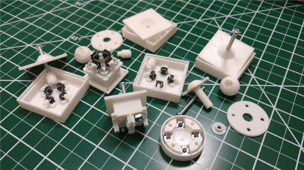

I started by downloading and printing some free models. They did technically work, but the plastic-on-plastic feel was weird and kind of squeaky. I added some silicone lubricant but it didn’t help. I tried various modifications and even made some of my own designs from scratch, but I wasn’t really satisfied with any of them. Also, the switches were a bit too noisy and had too much resistance.
A graveyard of failed joystick attempts

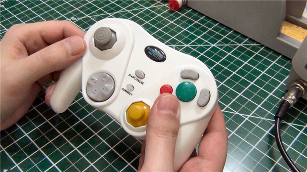

In the end, this is what I decided to use:
No official GameCube controllers were harmed in the making of this build.

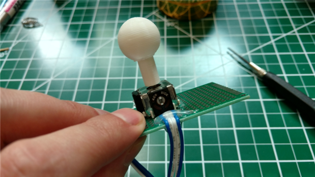

This third-party wireless GameCube controller has a decent feel, but the signal cuts out intermittently which makes it pretty much worthless. I was happy to sacrifice it for this project. There are two analog sticks. Unfortunately, this controller is not USB-compatible, and my USB encoder only accepts digital inputs. Is there a way to convert the sticks from analog to digital without extra hardware? It turns out there is!
It’s working! It’s working! The modded GameCube stick
If you want to see exactly how I did it, watch for my project video to be released on April 4.
Note: Don’t worry if you don’t have a GameCube controller to spare. The final project uses a similar analog stick that I found on Amazon and will include in the parts list for the build.
