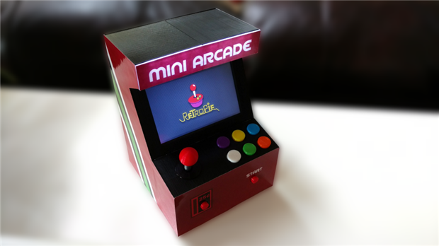

The mini arcade is actually fun to play
It was worth spending extra time on the controls because this thing is fun! To be honest, this was all about the build for me, so having a fun game system at the end is an added bonus. In fact, I think I may have been playing a little too much yesterday because I got at least one disapproving look. Hey, I have to test it, don’t I? Chores can wait. image

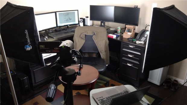

I concentrated heavily on the arcade system, which was important, but I didn’t put nearly enough planning and effort into the video. I underestimated how much work was involved and I had to speed through the entire thing on the night before the deadline. Lack of sleep and my lighting setup meant that I was visibly exhausted ("haggard" as someone put it). At the end I was rushing, which resulted in a video that focused on random minutiae rather than important build steps. A lot of great footage was omitted. Other minor things like inconsistent lighting and repetitive music didn’t help.

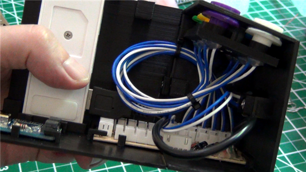

I’ve never designed or printed a 3D print even remotely as large or complex as this before. I was flying by the seat of my pants. I learned a lot about print orientation, weight distribution, fasteners and adhesives. But that learning came at the cost of some broken parts and a slightly flimsy final build. The system is fine on a desk, table, or shelf, but it kind of falls short as a portable device.

4:3 aspect ratio screen
The mini arcade is about retro gaming, and most retro games aren’t widescreen. If anything, a lot of classic arcade games were tall rather than wide.
Include analog controls
Because I was using a strictly digital USB encoder, I had to convert an analog stick to digital to make it work. But lots of games use analog controls and it would be nice to be able to play them that way.
Use a large format 3D printer and improve overall design to make it more robust
The ability to print larger pieces would make designing a strong case much easier. Also, avoiding the use of long, thin pieces is essential.
Find a nicer solution for cabinet art
I chose to go with a simple, inexpensive approach for cabinet art, and one that would let me do several reprints immediately if I messed something up. The design is printed with a color laser printer on full-sheet sticker paper and laminated with self-adhesive laminating sheets. The result is OK, but the adhesive isn’t very sticky and the print quality is slightly cheap-looking.
