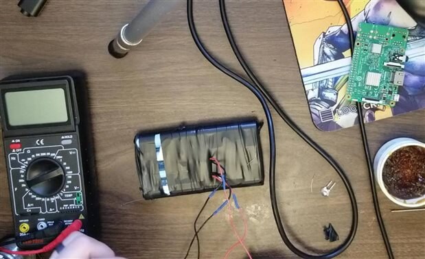

Battery is in progress:
22000mah of wonderful charge, lets see how far I can get this week

    rocits over 8 years ago +1
    ..at first glance 2200mah.. a week? what?.. oh 22,000 mah lol wow! Nice one you could power a small car, lol ! How's the rest of the project going, any luck with the python RC?

    cfoote7 over 8 years ago in reply to rocits
    20000mah I typo-ed with 22000, this is the specific battery I used https://www.amazon.com/gp/product/B01422TC14/ref=oh_aui_detailpage_o03_s00?ie=UTF8&psc=1  it's an all-in-one USB device recharger. The reason I used it was my previous build was under powered I kept getting the lightning bolt on my pi. I didn't really need the batteries I just wanted the lithium charging circuit that has a 3.5A at 4.1V and the dual boost converter that outputs two seperate 5v rails at 3A each.
