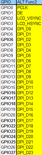

GPIO Pins
The DPI (Display Parallel Interface) is a simple clocked parallel interface (up to 8 bits of R, G, B; clock, enable, hsync, and vsync).  Its one of the alternate functions selectable on bank 0 of the Raspberry Pi GPIO.  The interface is available as alternate function 2 (ALT2).

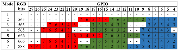

There are various ways that color values can be presented on the DPI output pins in either 565, 666, or 24-bit modes:

The Linux Device Tree overlay is used to switch the GPIO pins into the correct mode (alt function 2).  The GPU is responsible for driving the DPI display.  There is no linux driver so the overlay simply sets the GPIO alt functions correctly.
The 'full fat' DPI overlay (dpi24.dtb) sets all 28 GPIOs to ALT2 mode to provide the full 24 bits of color bus as well as the h and v-sync, enable and dot clock.  This will use all the bank 0 GPIO pins.
Users can edit overlays to create a custom overlay to enable just the pins they want to use.
