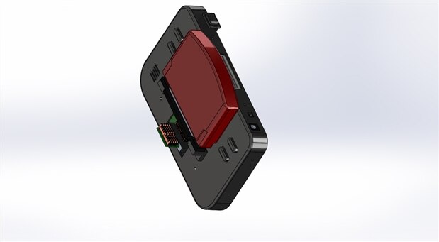

  • danybau
    danybau over 8 years ago
    It's better to make it simpler
    *****Image taken from the internet****

  • harbottherobot
    harbottherobot over 8 years ago in reply to danybau
    I think it is very easy for anyone to get hung up on the details of making something more portable. Mr. Heckendorn would do well to not seek perfection of portability and forsake more costly gaming systems in the process of chasing the ideal "portable" (specifically with marrying the indirect RAM extension card to port). In other words, he shouldn't use existing architecture. Fiddle around with a blank pin-out board instead of the sourced motherboards, that way further carnage is not executed up the growing death-toll.
    Daniel Bautista's design is essentially the thinner mother board of the N64 with out it's plastic shell. I think this suugestionscould salvage the existing project.
