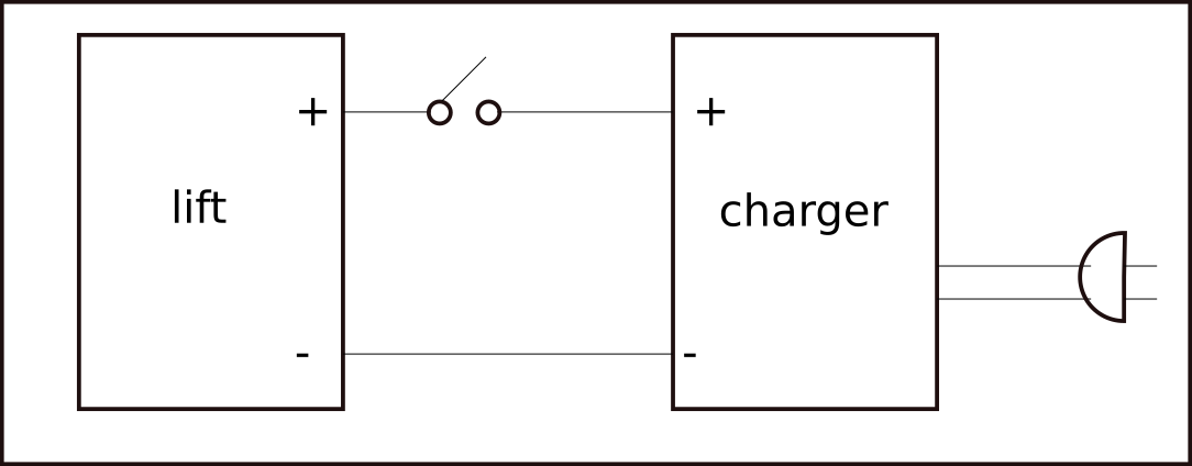

I am a total newb, so this is probably a really dumb question. I have a DC Harmar scooter lift that I need to be able to run from household current. I need to modify it to make a lift to get my wife off the floor when she falls. I have all the plans to do it, I just don't know what I need to convert the DC to AC. Currently, the lift connects to DC via a standard "trailer" plug. So I need to connect it to a converter that will them plug into a wall socket. I spoke to a guy at Harmar and he seemed to think it was doable as long as the device put out a minimum load of 15amp. Any help would be really appreciated. Thanks!

    It operates from a car's battery, so it's 12 V nominal (really 14 volts) and as Dave said the manual states it could draw up to 20 amps. This item comes close, it can put out 15 amps at 12 volts. https…

    I have a two solutions. My focus is not aesthetics. The solution is easy to create and safe. It is using technology that already exists today.
    I would consider an RV battery and a battery charger. The RV battery can be charged using the charger from an AC source without generating toxic fumes. The battery will meet the current and voltage requirements within a range of uses. If the kids are using the device for a amusement ride it won't hold up.
    Good RV batteries can provide well over 30amp/hrs. Your current demand is not for hours but for short periods of time. The battery and charger in a plastic tub from a department store, keeps the cost down if the solution has budget constraints.
    If you wanted to go all in on just a battery charger, there are units capable of supplying that amperage and more. I did a quick search for battery charger and starter and got this hit. The 25amp rating meets your requirements. Make up some cables (be sure an use 10AWG wire and rated connectors and your good to go.
    A wall wart power supply is not going to provide the capacity for such a job. A power supply that can provide the current specified is not going to come cheap. Hang around here long enough and a power supply RoadTest review might net you the ideal unit. Some of those suckers can support 40amps. It will just cost you a RoadTest:)

    dougw over 6 years ago in reply to colporteur
    The charger idea is a pretty robust, low cost solution.
    If the power is simply fed to the motor with a switch, a car battery charger should work without a battery.
    I have an old 16 A charger that has many times been asked to supply over 30 amps (while starting a car).
    I consider it bulletproof - it has been through the war and abused badly, but still works fine.
    At 14.7 Volts it supplies less than 2 Amps, so it doesn't need a voltage limiter/regulator.
    The chargers are about as low cost as you can find. I paid about $30.

    mark1054 over 6 years ago in reply to dougw
    So are you saying I could wire the lift directly to the charger to use it?
    dougw over 6 years ago in reply to mark1054
    If the lift has electronic circuitry, (for example a speed controller) it may need a regulated voltage.
    If the lift control is just a switch, it should work, as the charger is able to power DC motors.
    Can you describe the controller and what it does?
    If you want to try it, have someone knowledgeable look over your wiring and explain the charger voltage is unregulated - not clean DC.
