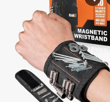

    Expanding operations is pretty exciting.  Im not sure it possible to keep everything within arms reach, when I try, things get buried in piles in the heat of battle, to pardon the pun.
    There are also families of stuff in the solder area. I have a 100W soldering pencil, a USB solder pencil, and it sounds like you also have surface mount equipment too ?
    Even tho its a soldering area, I always battle with the need to have tiny tools there too : tiny pliers, small screwdrivers, a needle size drill bit, tweezers, a DVM with tiny probes, a tiny caliper, and magnifying glasses.
    You're on the right track with rolling drawers. I also have a rolling toolbox just for tiny tools.
    I also use a magnetic wristband, even tho I might not wear it, I keep it nearby so the stuff Im presently using doesnt roll away and hide me from me.
