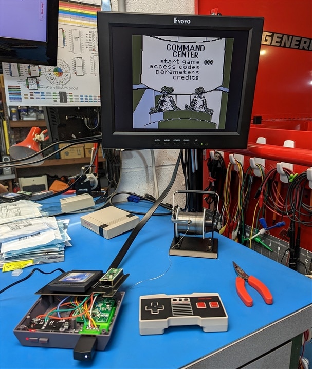

element14 Community member Joe Ostrander saw the "Unportable Game Boy" that Andy made in a previous video, and decided to make a new and improved version. In this episode, Andy builds a console from Joe's upgraded design and demonstrates its features, including several enhancements that were requested by viewers.

    This has been a fun project to put together.  I added parts to the pcb design to include the Game Link connection.  I am waiting on a second Tetris cartridge to come in so I can see if it works.  I wanted to make a Gameboy Console when Andy made the original project, but didn't have a faulty DMG-01 or NES case to use.  With Joe's version I really wanted to make one as it includes various things I wanted to get some practice with.

    Tetris did come in, I wired in the Link Cable to test with.  It wouldn't start a 2 Player game though.  I have not played a linked game on the Game Boy in decades.  I believe the process is to connect the Game Boys together with the cable, turn them on with the same cartridge and choose 2 Player Game.  It just won't start the 2 Player game from either device.
    I rechecked the wiring on the cable.
    I checked the Diode Array Datasheet.
    I checked the Game Boy DMG Schematics against the new board schematics.
    If anyone has any suggestions let me know.
    I am thinking I will check one of the spare boards to make sure all the points are connected properly on the board.  Then I'll have to pull the board out and check over the solder and if the diode arrays etc are all good on it.  It seems only pins 2 (SOUT), 3 (SIN), 5 (SCX)and 6 (Ground) are used to create a link.  Pin1 is VCC after a Diode, but it looks like it is only used by the 4 Player Adapter DMG-07.
    Beyond that it has worked great as to how Joe had set it up.  I made it to Level 10 in Tetris.  It is still an oddly appealing game.
    Provided it had worked the cable from the DMG-07 does fit through the hole in the back of the case meant for the 3.5mm jack from the Pi3 the case was originally designed to hold.  The cable is a bit to short though to be very practical.  I was going to use it for testing though.  If I find the issue, I have designed a breakout board for the Linkport and found a good place for it in the bottom of the case.
  • markeno
    markeno over 3 years ago in reply to markeno
    The problem with the Multiplayer Link was using the DMG-07 cable, Pin 2 and 3 needed flipped.  I wasn't aware the regular cable has them flipped and Joe pointed that out.  So it is working great.  I just need to work out installing the Link Port in the case and I am done with it.  I don't like having that cable hanging out, and it is a bit short to be pracical.  Thanks to Andy for inspiring Joe to make this project.  It has been a lot of fun to work on and learned a few things that will help me with other projects.
