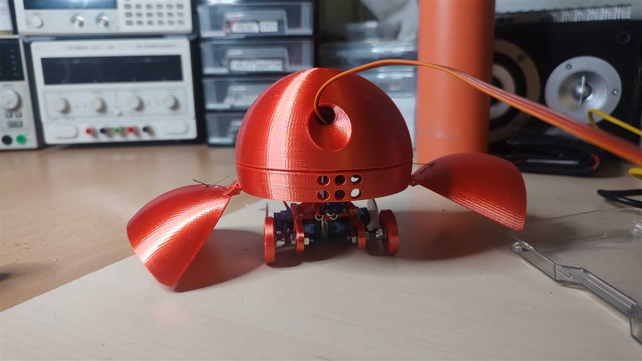

Milos starts by brainstorming a few rough sketches and ideas, which provide a roadmap for the project. The goal is to create a Christmas ornament (a sphere with a diameter of no more than 100mm) that transforms into a drivable robot.
The sphere shape is chosen so that the robot can blend inconspicuously in with the other ornaments on the tree. The robot is 3D printed from shiny red silk PLA filament. Hidden inside, a tiny winch! When it's time to explore, trap doors open, wheels emerge, and the robot descends gracefully from the tree.

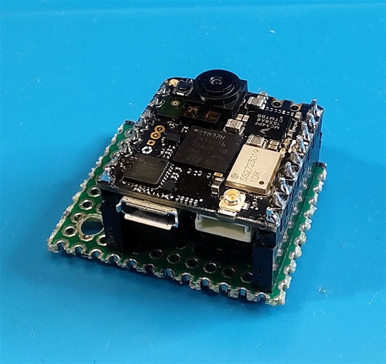

Integral to the project's success is the small (but powerful) Arduino Nicla Vision board. The Arduino enables Wi-Fi connectivity and allows Milos to control the robot's motors, while also live streaming footage from the embedded camera to a PC via Wi-Fi (RTSP).
Powering the robot is a 9V battery regulated to 5.1V using the LM317T linear voltage regulator. For night driving, Milos incorporates six small LEDs controlled by an N-channel MOSFET. To address issues with continuous rotation servos during testing, a level shifter using BJT transistors is added; this successfully corrects any distortions in the motors.

In a nutshell, Milos' MR-04 Robot Christmas Ornament is like holiday magic with a tech twist. It’s an inconspicuous decoration that morphs into a roving robot with a live video feed—pretty cool, right? This perfect blend of festive cheer and cutting-edge fun turns your Christmas into a tech-powered celebration!
