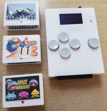

    imagereally well done! I like the cartridge system and the label of tiny gilbert. image
  • andrewsays
    andrewsays over 7 years ago in reply to electrol.i.b
    Thanks! Gilbert image is kind of "hard to find".
  • andrewsays
  • electrol.i.b
    electrol.i.b over 7 years ago in reply to andrewsays
    The images are all available in the SPRITE folder of the original game "Gilbert and the doors" ! image
