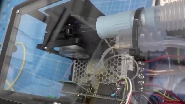

The teardown reveals a design that balances accessibility with functionality. The main enclosure consists of 3D-printed components combined with laser-cut acrylic panels, allowing the internals to remain visible during development and demonstration.
"The main body is 3D printed and it has acrylic laser cut panels so you can see the inside."

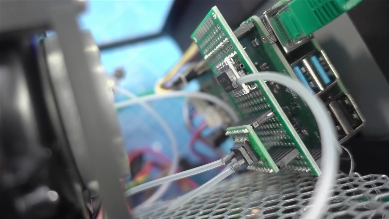

At the centre of the system sits a Raspberry Pi 4, responsible for user interaction and higher-level control. Attached to the Pi is a 7-inch Raspberry Pi touchscreen alongside Trinamic's custom controller board.
"The main brains of the project is a Raspberry Pi 4."
Mounted above the motion-control hardware is a pressure-sensing subsystem which, at the time of filming, still relied on hand-assembled sensor hardware. Trinamic was already preparing production-ready versions of the sensor board so manufacturers could reproduce the complete design using the released design files.

Instead, the TOSV employs a blower-based system similar in concept to respiratory devices used in clinical and assisted-breathing applications. The fan is controlled through closed-loop motor control, allowing pressure and airflow characteristics to be adjusted continuously rather than mechanically approximated.
