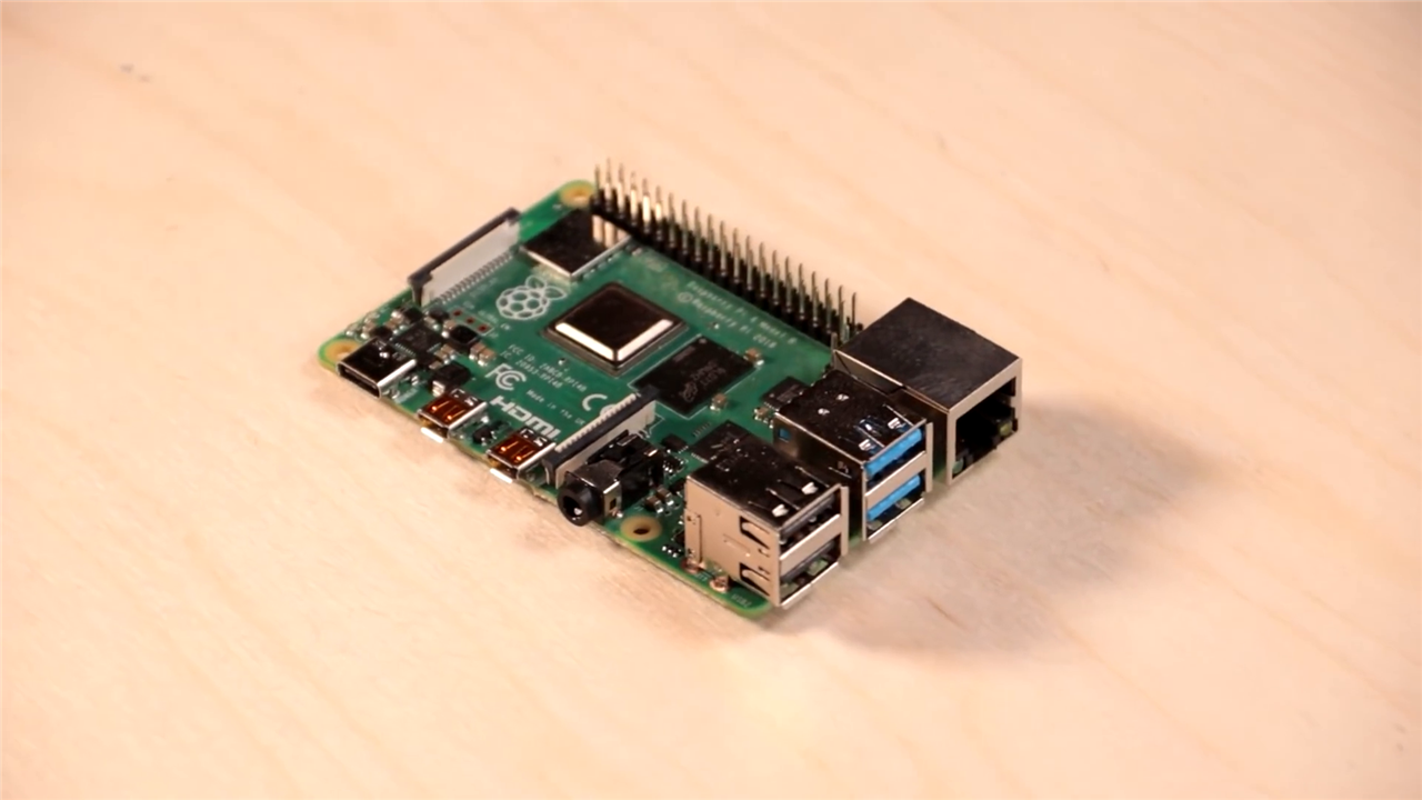

Control and Processing: Why the Raspberry Pi 4 Makes Sense
At the heart of the cyberdeck is the Raspberry Pi 4 Model B, chosen not for novelty but for practicality. Harrigan describes wanting something he could genuinely use as a portable development machine, and the Pi 4 is well suited to that role.
Technically, the Raspberry Pi 4 represents a significant step up from earlier models. With a quad‑core 64‑bit Cortex‑A72 CPU running at 1.5 GHz, up to 4 GB or 8 GB of LPDDR4 RAM, USB 3.0, true Gigabit Ethernet, and dual‑display support up to 4K, it comfortably supports desktop Linux workflows while remaining compact and power‑efficient. Most of this is overkill for what we want, you can get away with a Raspberry Pi Zero which may be better suited, but this was available at the time.
Equally important is its I/O flexibility. The 40‑pin GPIO header, CSI camera interface, DSI display connector, and analogue audio output allow the cyberdeck to integrate tightly without resorting to bulky adapters or internal HDMI cabling, something Harrigan is keen to avoid in a portable enclosure.

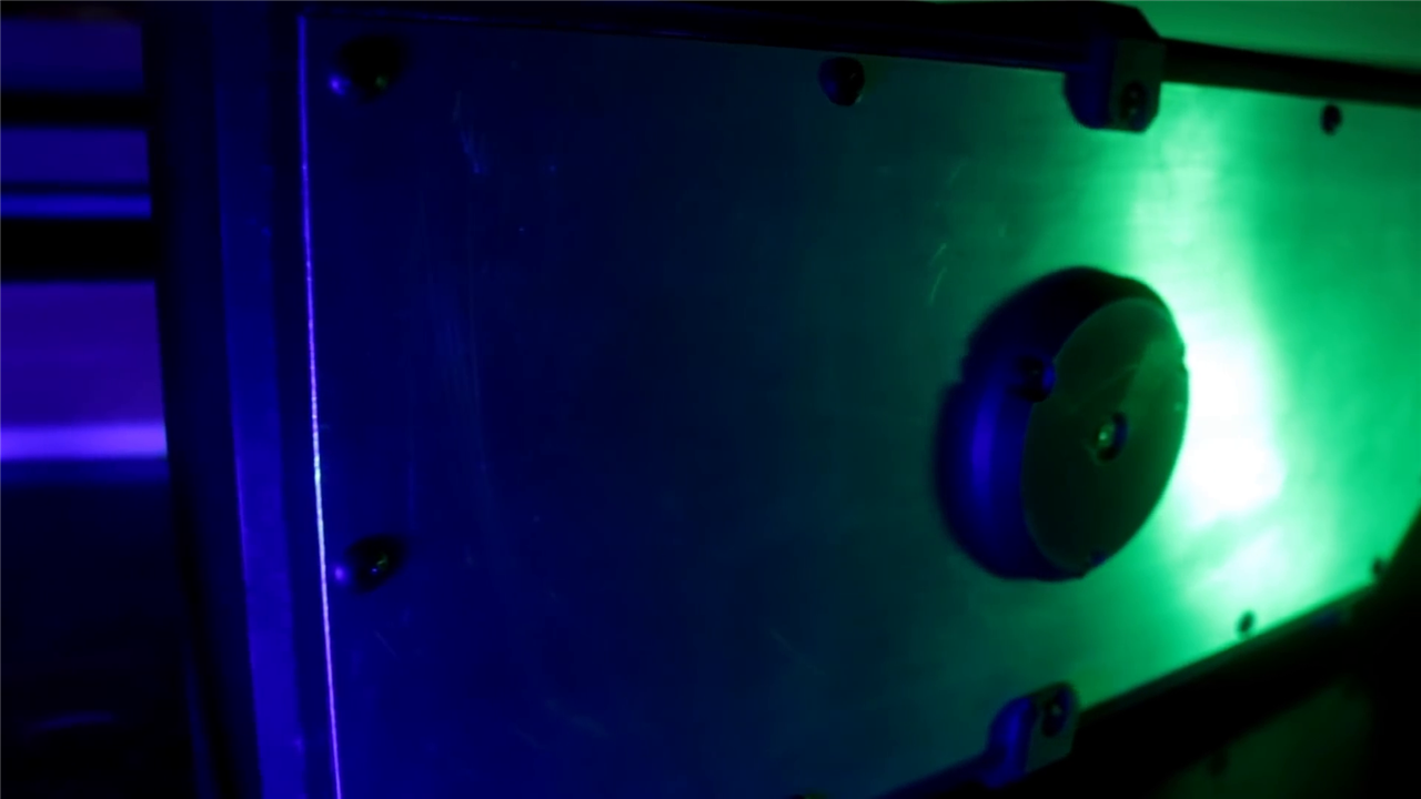

Audio is handled by a 10 W, 4 Ω speaker, driven by a SparkFun Mono Audio Amplifier (3 W). While the speaker’s rated power exceeds what the amplifier can deliver, this pairing provides headroom and clarity without stressing the electronics.
The amplifier’s support for analogue volume control via a 10 kΩ audio‑taper potentiometer allows Harrigan to add a satisfyingly large physical knob to the enclosure—another deliberate rejection of purely digital controls. Compact Class‑D amplifiers like this are highly efficient, making them ideal for battery‑powered systems where heat and power loss matter.

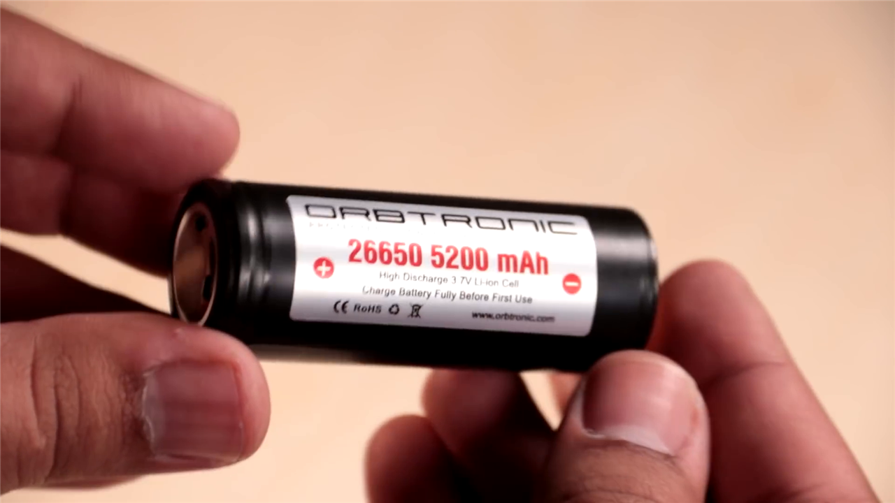

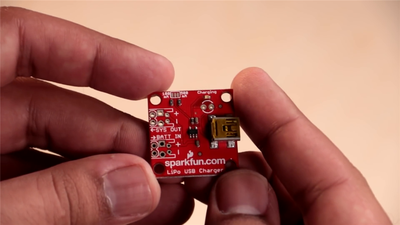

Power is often where portable projects fall apart, and Harrigan treats it accordingly. The cyberdeck is powered by a 26650 lithium‑ion cell rated at approximately 5200 mAh, chosen for its ability to supply high current without significant voltage sag.
Because lithium‑ion cells operate at a nominal 3.7 V, the system relies on a high‑power 5 V boost converter capable of delivering up to 25 W, enough to handle the Raspberry Pi, display, audio system, and peripherals simultaneously. Charging is handled by a SparkFun LiPo Charger, prioritising safety and simplicity over fast charging.
Harrigan is candid about the trade‑offs: this is not a daily‑driver laptop, and overnight charging is perfectly acceptable. That honesty is refreshing and instructive for anyone designing battery‑powered builds.

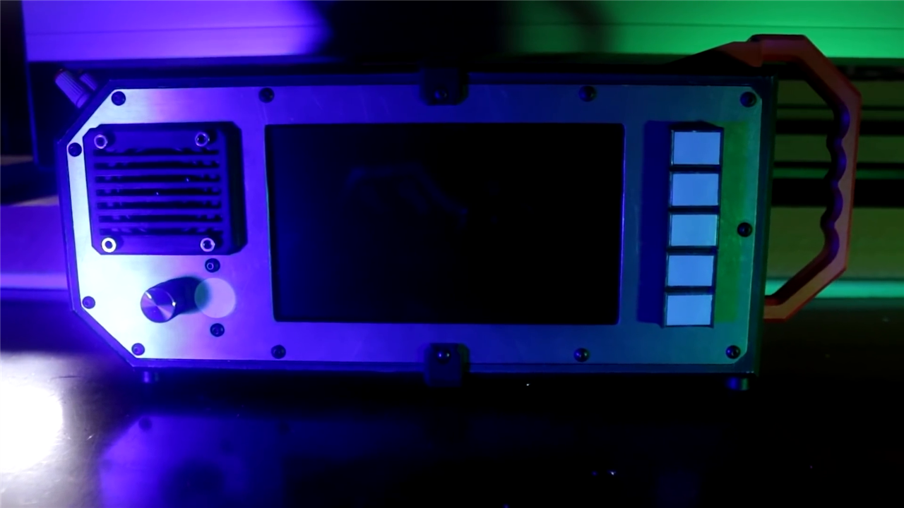

Enclosure Design: Where the Cyberdeck Becomes Itself

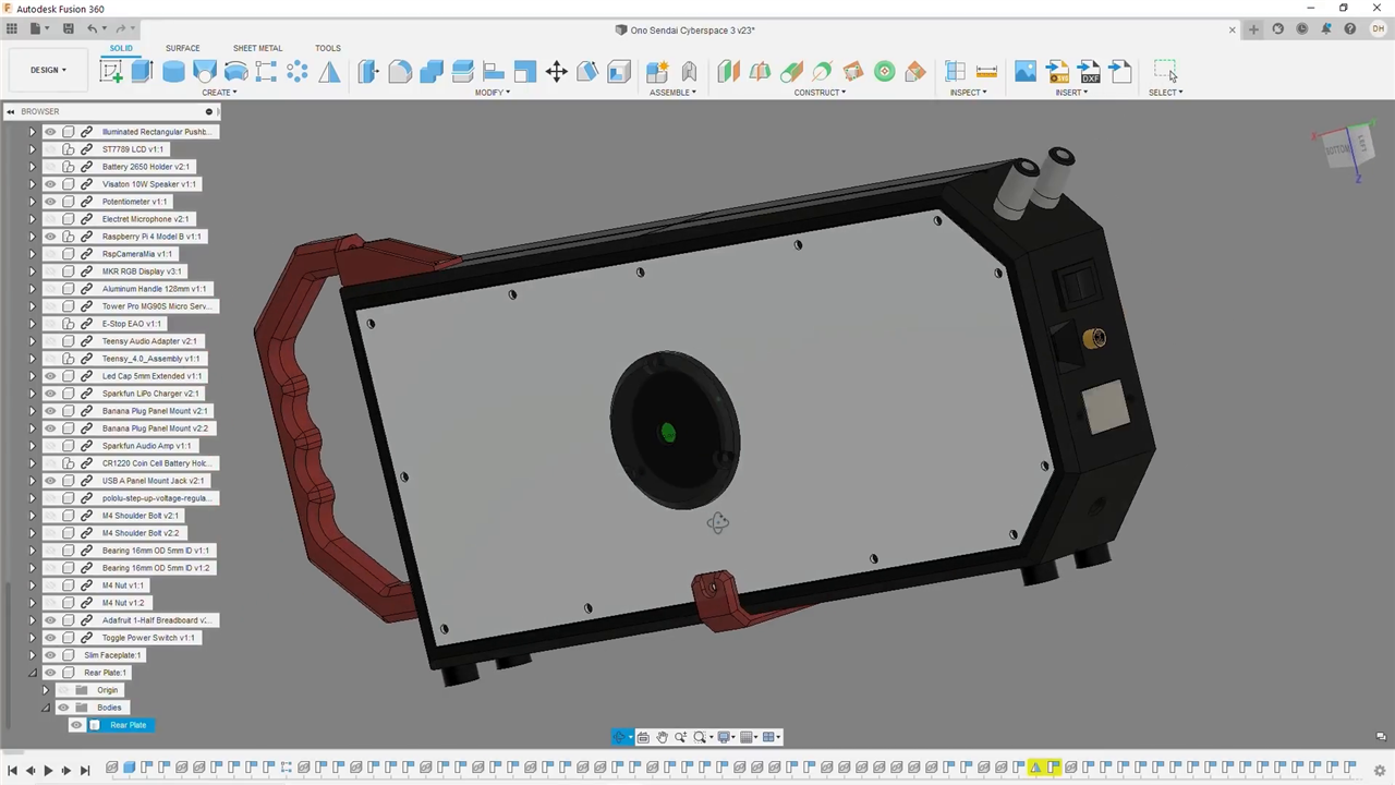

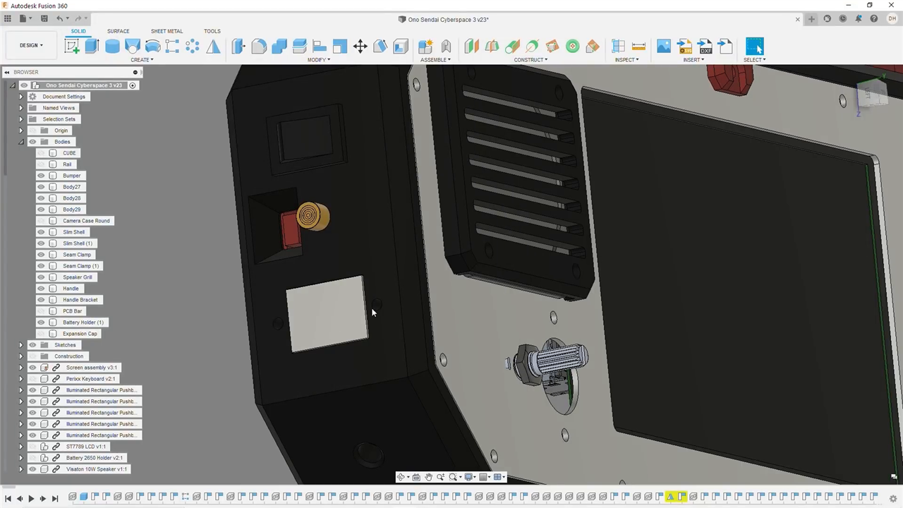

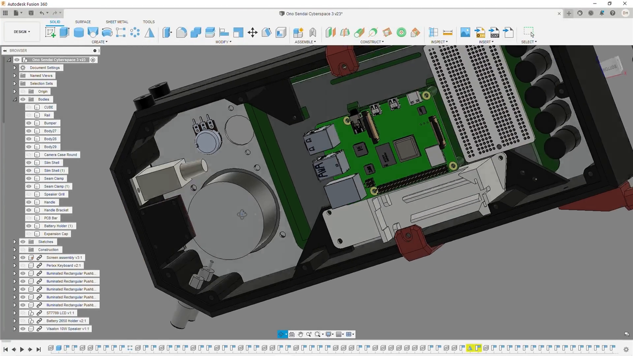

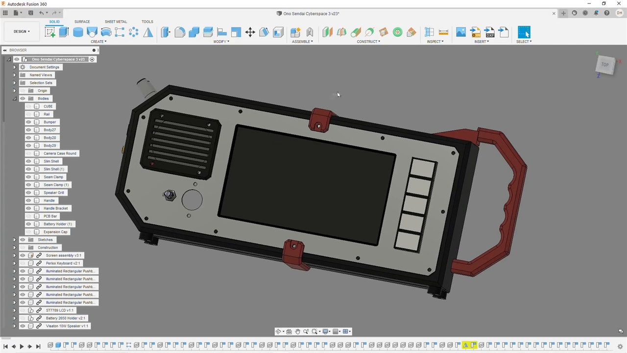

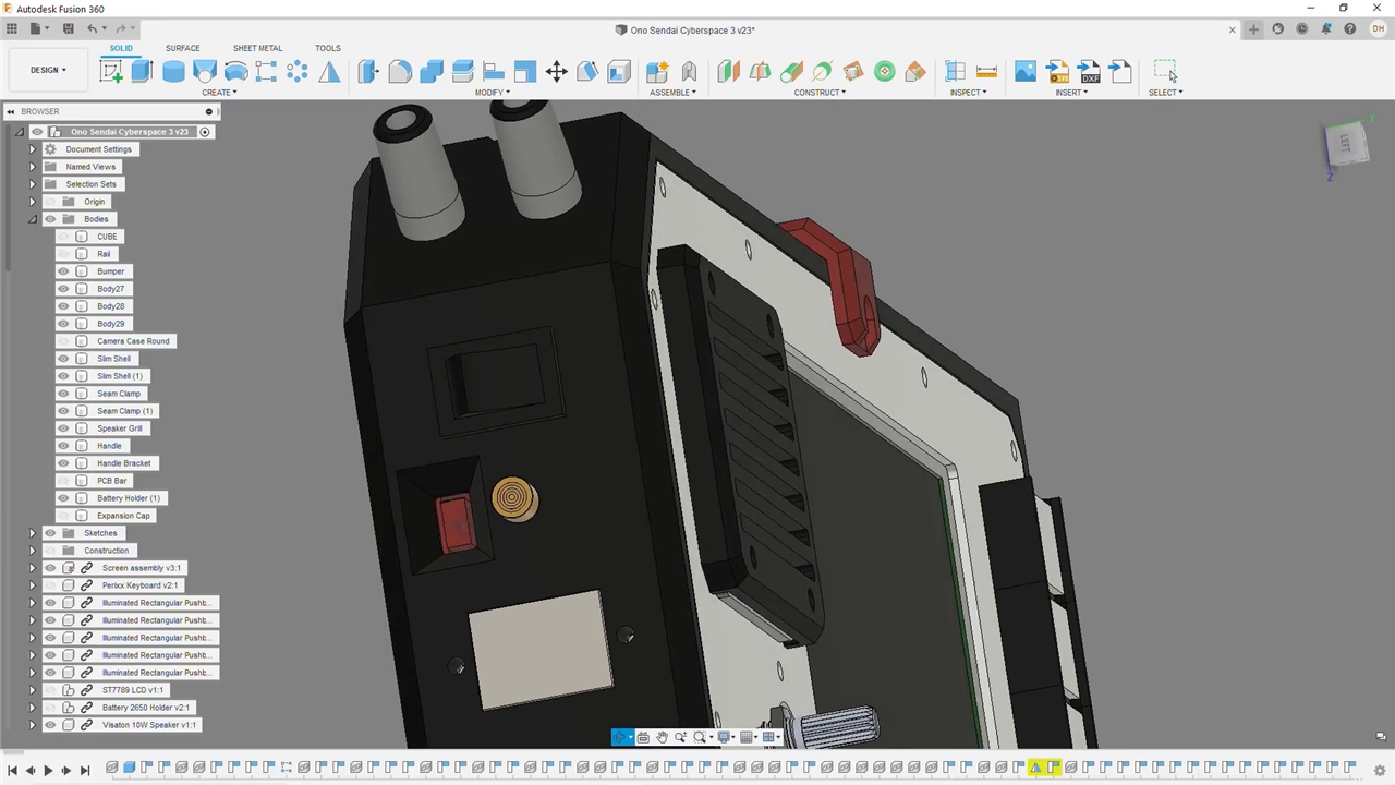

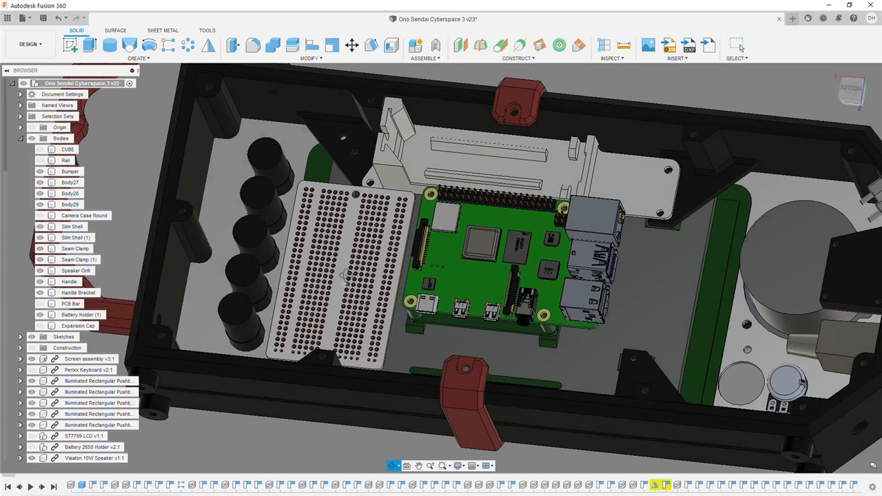

The enclosure is where the project truly earns its name. Designed in Autodesk Fusion 360, the case combines 3D‑printed PLA components with machined aluminium front and rear plates cut from a 1/16‑inch aluminium sheet. The result is a structure that is rigid without being bulky.
At roughly 330 mm long, 140 mm tall, and 50 mm thick, the cyberdeck avoids the “lunchbox computer” trap while still feeling substantial. The asymmetrical handle, exposed banana‑plug power outputs, and deliberate absence of a keyboard all contribute to an object that feels purpose‑built rather than consumer‑polished.
Importantly, the design is optimised for replication. The main printed parts require no supports and fit within the build volume of common hobbyist printers, making the project accessible rather than aspirational.

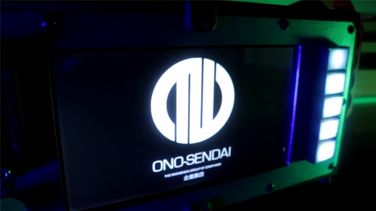

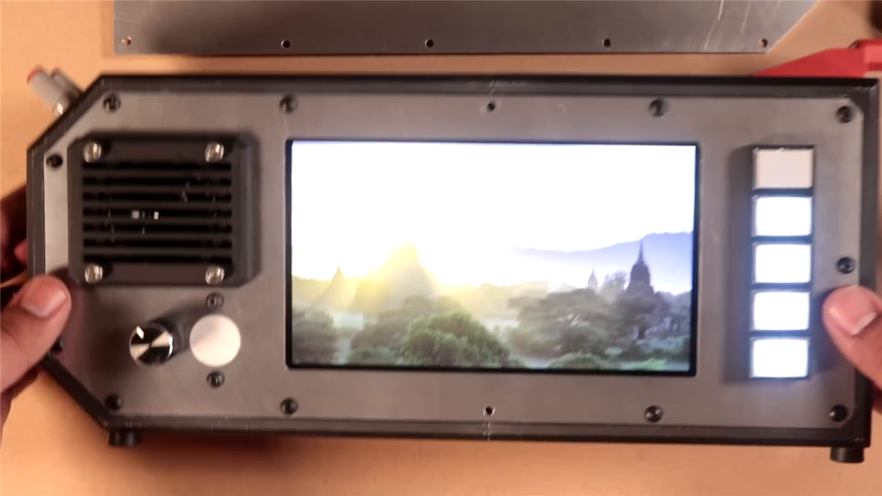

Assembly, Testing, and Reflection

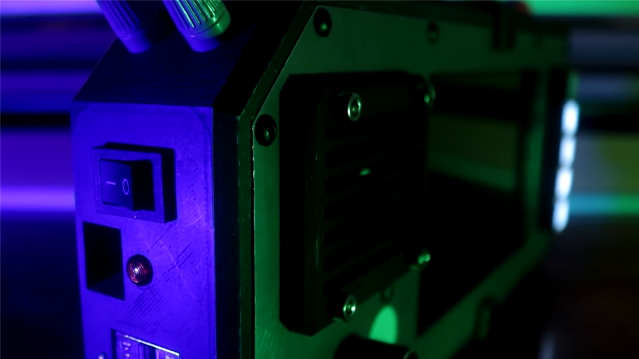

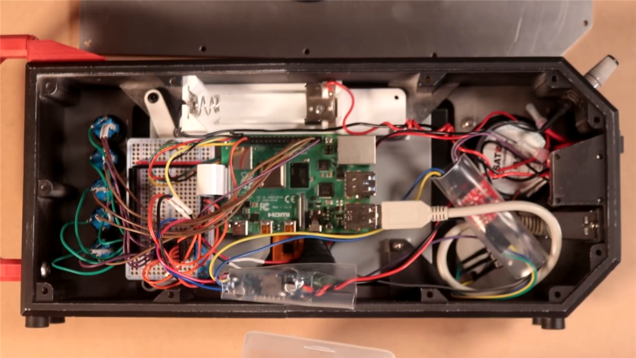

Internally, the wiring is clean and methodical. Power flows from battery to charger, through a physical power switch, into the boost converter, and then out to shared 5 V rails. A Permaproto half board provides reliable distribution and strain relief, an often overlooked detail that dramatically improves long‑term durability.
On first power‑up, illuminated buttons confirm power delivery, the Raspberry Pi boots cleanly into Raspberry Pi OS, and the system comes alive without drama. As Harrigan reflects, it is “just a Raspberry Pi in a cool case”, and yet far more satisfying to use than expected.
What ultimately defines this cyberdeck is not what it does today, but what it invites next. The unused buttons, expansion ports, and exposed power rails are not flaws; they are deliberate openings. Harrigan openly asks how it should evolve, and by extension, how others might build their own.
In that sense, this project succeeds on every level it set out to address. It is functional. It is weird. And it looks undeniably cool.
More than that, it reminds us that personal computing does not have to converge toward a single shape. Sometimes, the future looks like a strange box with too many buttons, and that is exactly the point.

    Here's the plates separated at the same seam as the case. Bear in mind that the body is designed to take advantage of the solid plate for the main structure, and while I'm sure the pi display will hold things together, I don't think it should take the brunt of the mechanical stress.
    If you want solid plates, there are online metal laser cutting services like OshCut and SendCutSend.

    Ditto.  Great Build.   My show stopper is printing the front  and back panels.  Printer bed not big enough.
    Can you provide an STL that splits the panels and glue them together?
    Any pointed on how to get the panels cut out of aluminum or metal.  Can you provide details or pointer on how to do this as well.
