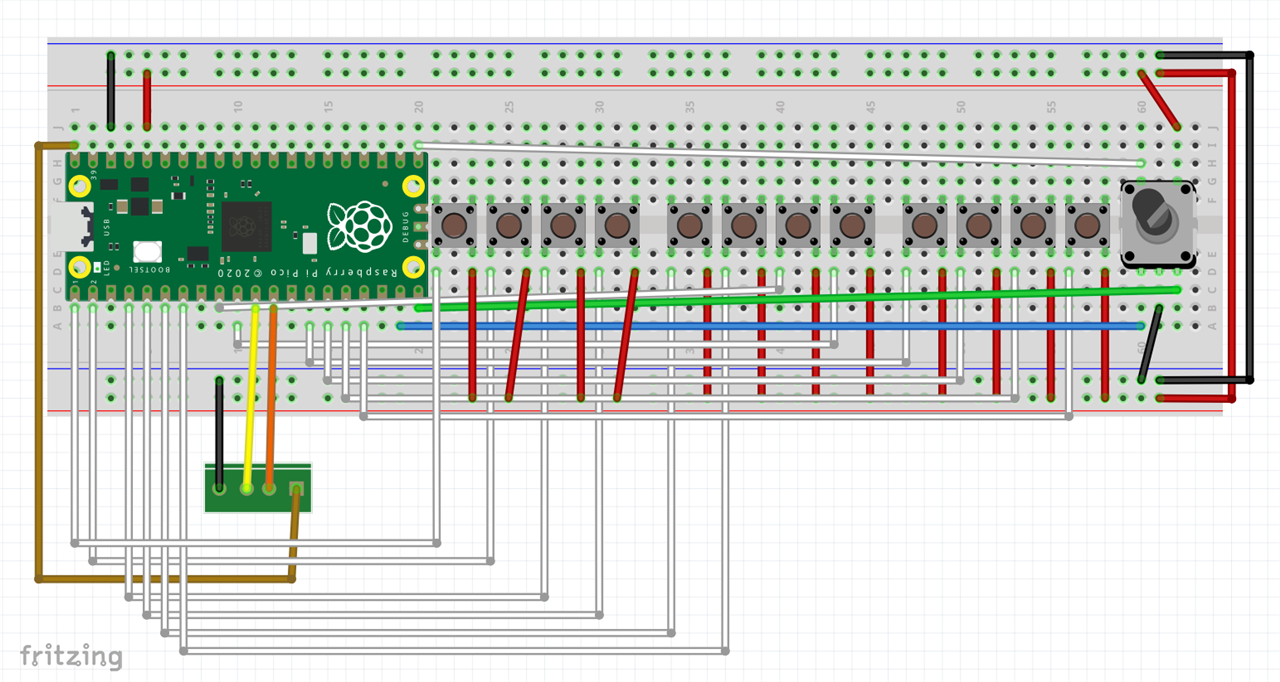

Keyboard Shortcuts Keypad with Raspberry Pi Pico -- Episode 494
Frequently used programs which have shortcuts/macros to save you time, but forget what they are? Here's a shortcut keypad for quick and easy access, with a helpful screen to remind you where the location of each.

wiring.txt :
Switches (all)
Pico					To
GP0 (Pin1)		SW1(pin1)
GP1 (Pin2)		SW2(pin1)
GP2 (Pin4)		SW3(pin1)
GP3 (Pin5)		SW4(pin1)
GP4 (Pin6)		SW5(pin1)
GP5 (Pin7)		SW6(pin1)
GP6 (Pin9)		SW7(pin1)
GP7 (Pin10)		SW8(pin1)
(Pin11)				Screen(pin??)
(Pin12)				Screen(pin??)
GP10 (Pin14)		SW9(pin1)
GP11 (Pin15)		SW10(pin1)
GP12 (Pin16)		SW11(pin1)
GP13 (Pin17)		SW12(pin1)
Pin1 as above
Pin2 to +3.3v (Pico pin 36)
Rotary Encoder
PinA					Pico GP14 (Pin19)
PinC					GND (Pico Pin 38)
PinB					Pico GP15 (Pin20)
Pin1					Pico GP16 (Pin21)
Pin2					+3.3v (Pico pin 36)
See datasheet for pin labeling on rotary encoder
But looks like this:
		1		2
	A		C		B
Screen using gen4 InterfaceBoard
+5V				+5V Pico(Pin40)
TX				Pico UART1 RX/GP9 (Pin12)
RX				Pico UART1 TX/GP8 (Pin11)
GND				GND (Pico Pin 38)
RES				Not Connected

    Hi everyone. As I said, I am not an electronic but I wanted to ask, is the wiring diagram correct? Thinking
  • hifromkatie
    hifromkatie over 4 years ago in reply to Beemot
  • Beemot
    Beemot over 4 years ago in reply to hifromkatie
    Oh! So it is clearer to me Grinning
  • cstanton
    cstanton over 4 years ago in reply to Beemot
    Thanks for bringing it up.
  • cstanton
  • Beemot
    Beemot over 4 years ago in reply to cstanton
    Thanks to Katie who corrected it very fast! Heart eyes
