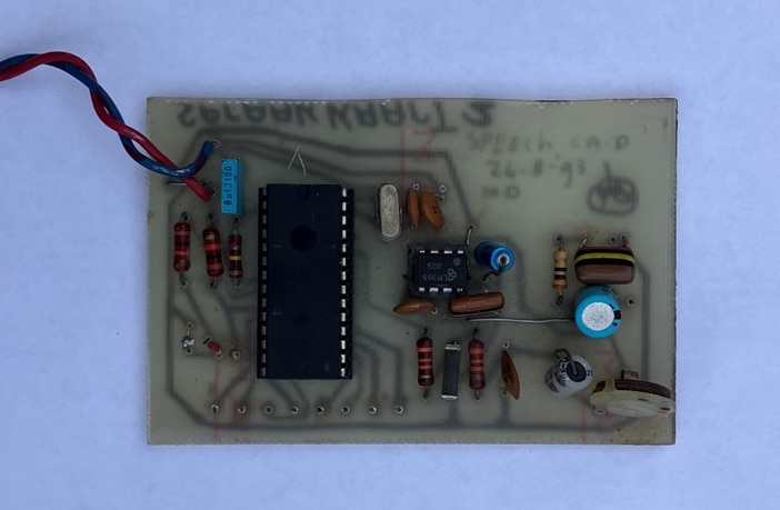

The other day, while cleaning out his basement, Mark found an old project that he did for his home computer. Back in the days, one could buy a speech module that you could plug into the back of your computer to make it talk.  I believe for the VIC-20 that was the SAM module.
Now around the same time magazines as ELEKTOR published articles to build your own module using a SP0256 CHIP.  Guess what Mark found?
Mark found one of the very first PCB ‘s he ever created. He etched it in chemical to create tracks as that was how it was done, back in the days. This PCB holds a SP0256 and some electronics as stated in the datasheet. According to Mark, this has been laying in a drawer untouched for around 40 years!
Schematic
The SP0256 only needs a few external components to function. We have an Xtal and 1 or two capacitors that form the hearth of an oscillator. The oscillator frequency is around 4Mhz. If you play around with the oscillator frequency ( khz range) you will notice a change of pitch in sound.
Little filtering is needed before the audio signal, coming from the chip can be send to an amplifier. The amplifier is simple and is based around an LM386.
To control the SP0256, I will be using an Arduino uno.
Although it’s name might suggest different, we only need to address 6 bits to use all of it’s vocabulary. However, the chip dataport is 8 bits wide and that is because this chip was designed to be hooked up to an external ROM, expanding the vocabularies. For now, this means that will connect the two most significant bits to ground.

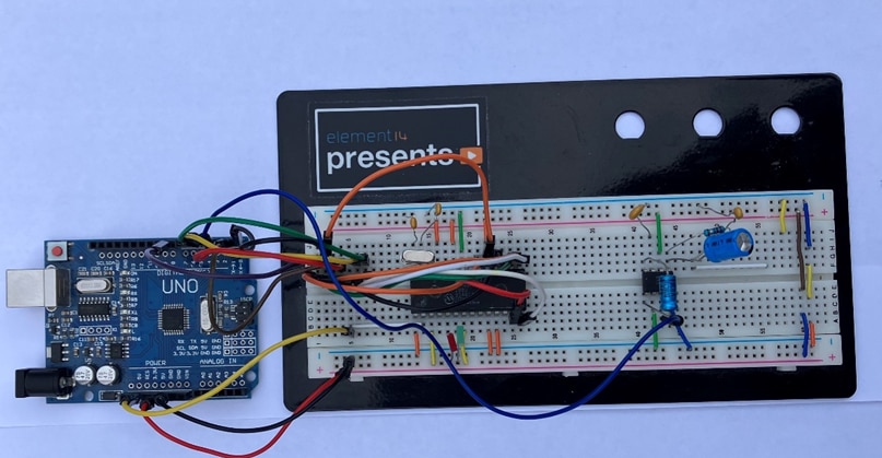

Time to renew
Now as you can see, all components surrounding the SP0256 on the PCB look old (they are). This PCB sat in a drawer together with other old electronics and as you can see all is covered in dust. I am not even sure if any of the electrolyte capacitors are still working or dried up completely. That’s why I will leave those components on the PCB and just use new once instead.
So, Mark placed it all on a breadboard, and added a few components.
As you can see, it all looks very wiry but don’t worry, its not hard. It’s probably harder to get your hands on a working chip than to follow the schematic.
Arduino Libraries? ESP32 Emulation!
When Mark revived this old project, he was driven by curiosity and nostalgia. Because a very long time ago, Mark had a great time playing around with this chip. So, he figured it was worth a shot (and he was right - at least by his terms, what do you think?) Mark may not be the only one feeling this way. In the past years, (according to Mark) others have tried this too, and even left a library to be used with Arduino! How great is that. This sped up Mark's project big time!
This is great news, even after decades, this chip is still doing what it was designed for: Talking Fun!
Like Mark said at the beginning, for some this is a trip down memory lane. However, the younger generations might be thinking: "why? When we can do so much better with today's technologies!". And yes, that is true but if you into this robotic like voice, you will love it, even though it is old.
The sound chip is now obsolete, and it might be hard to get your hands on one. Fortunately, you don’t have to. There are a few sound libraries available to emulate the chip with nothing but software on the micro-controller. If you watch the episode, you'll see how this was performed on an ESP32.
