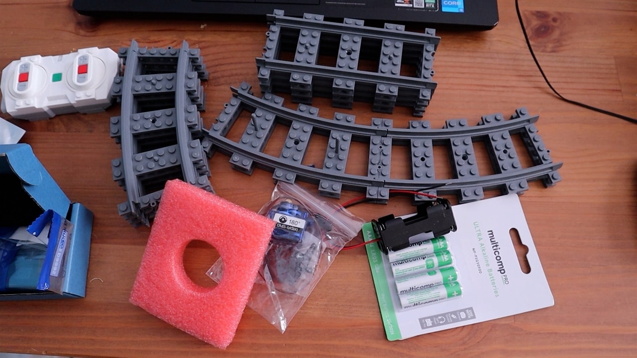

What happens when a Bluetooth-controlled LEGO train meets a maker's imagination and a ceiling with just enough clearance? In this episode of element14 Presents, Lorraine takes on the challenge of modifying a standard LEGO train to follow custom commands, detect obstacles, and operate on an overhead track. The result is a creative blend of electronics, coding, and home decor, designed to move a train through the airspace of a living room using smart control.
Design Intentions
The project began with a clear goal: to control the LEGO train programmatically and free it from its default Bluetooth remote. Rather than having the train occupy floor or shelf space, Lorraine designed a track layout to mount along two walls at ceiling level. The vision was to have the train run at set intervals, detect walls, and respond to its environment—all without manual input. This required integrating control logic, sensing capabilities, and a power-conscious hardware setup, all embedded within the constraints of a moving LEGO train.
Component Choices
The core controller is the Seeed Studio XIAO nRF52840 Sense board—compact, Bluetooth-enabled, and compatible with CircuitPython. It was small enough to fit inside a LEGO train carriage while providing the computing power needed for real-time control. A NeoPixel RGB LED strip was used to light up the train's windows with programmable color effects. For obstacle detection, a rotating LIDAR sensor was mounted on top of the train. Although a simpler ultrasonic setup could have sufficed, the LIDAR offered wider coverage and visual appeal. A separate battery setup powered the XIAO, with an optional servo mechanism considered for toggling the train’s power supply to conserve energy.

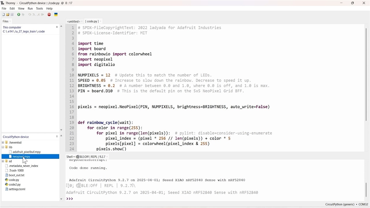

One of the primary challenges was managing power consumption. The LIDAR sensor in particular drew significant power, raising concerns about the available battery life. While a servo was considered for turning off the train’s main battery to conserve energy, it would also consume power and possibly reduce overall efficiency. The code was developed in CircuitPython using libraries for NeoPixel control and serial communication. Existing Python code examples were adapted to work with CircuitPython, removing unnecessary features like data plotting and focusing on extracting distance values to detect when the train should stop.
