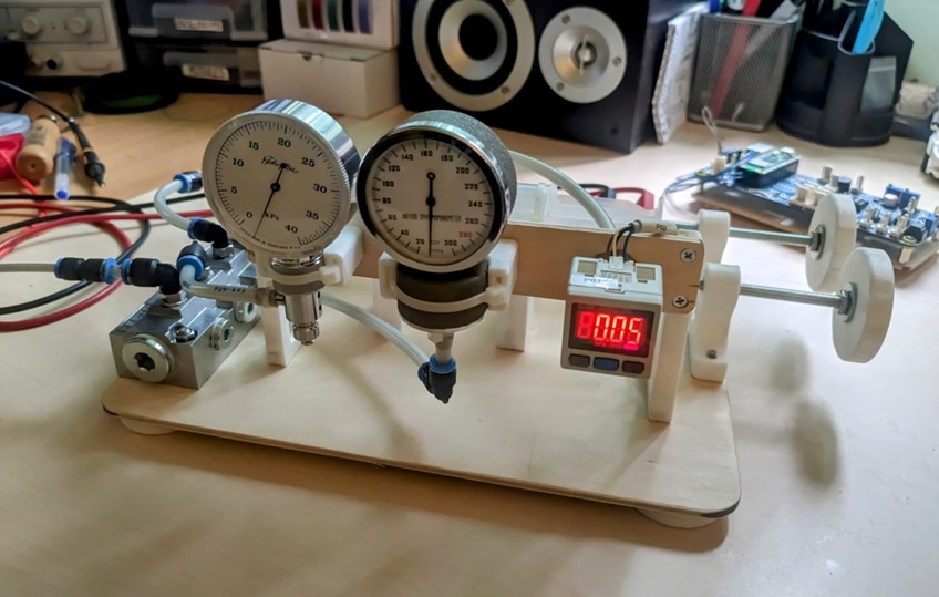

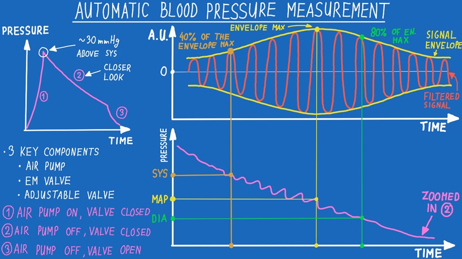

How do Blood Pressure Monitors Work?
Milos begins the video by describing the differences between the manual and the automatic blood pressure method. Even in 2024 the manual method, where a doctor uses a stethoscope, is still considered the gold standard for non-invasive blood pressure measurements! The manual method works by listening to Korotkoff sounds which appear on the stethoscope once the pressure inside the cuff drops below the systolic pressure, and then they disappear once the pressure drops below the diastolic pressure.
Companies keep it a secret for what algorithms they use in the automatic blood pressure monitors, but some of the most famous ones from the literature are the Sapinsky and Geddes methods. These are methods that require only the signal from the pressure sensor, and they work by looking at the envelope of the filtered signal. If any of this sounds interesting, make sure to check out the video, because Milos first describes it in a drawing and shows how the analysis is done on the data recorded by the device!

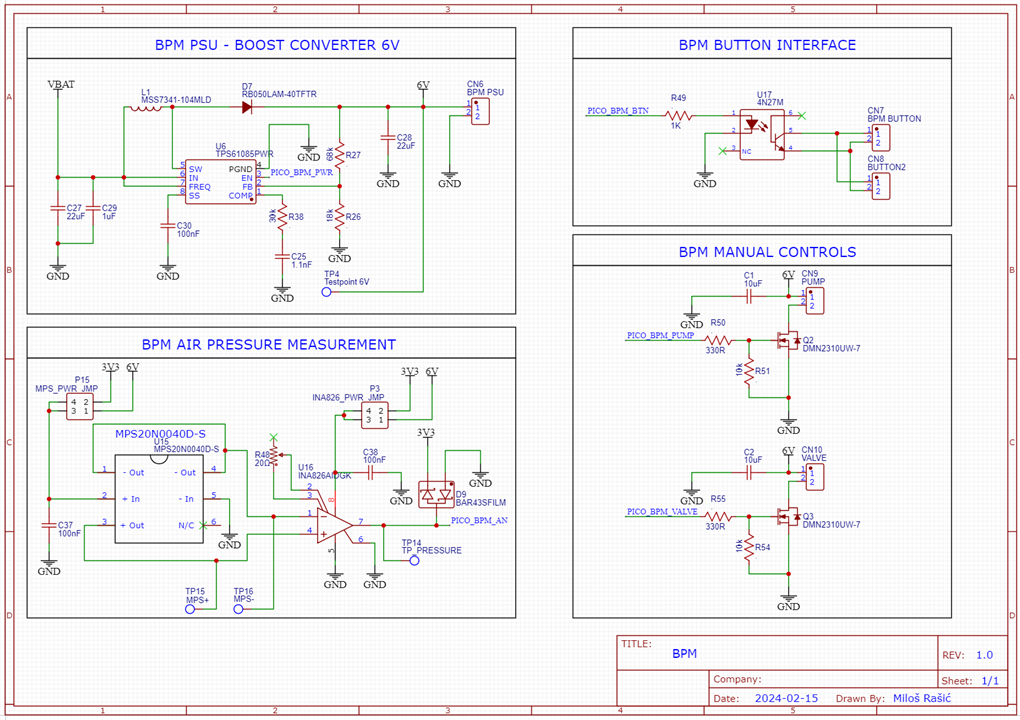

The Electronics Inside
Before getting into the electronics, Milos began by listing the main system requirements that the system had to fulfill.
  • Safety – the first item is safety, when a person is in contact with the device, nothing should be connected directly to the wall, including the PC that is connected to the device. To fulfill that standard, Milos used a specialized USB isolator IC, and an isolated power supply for charging the battery.

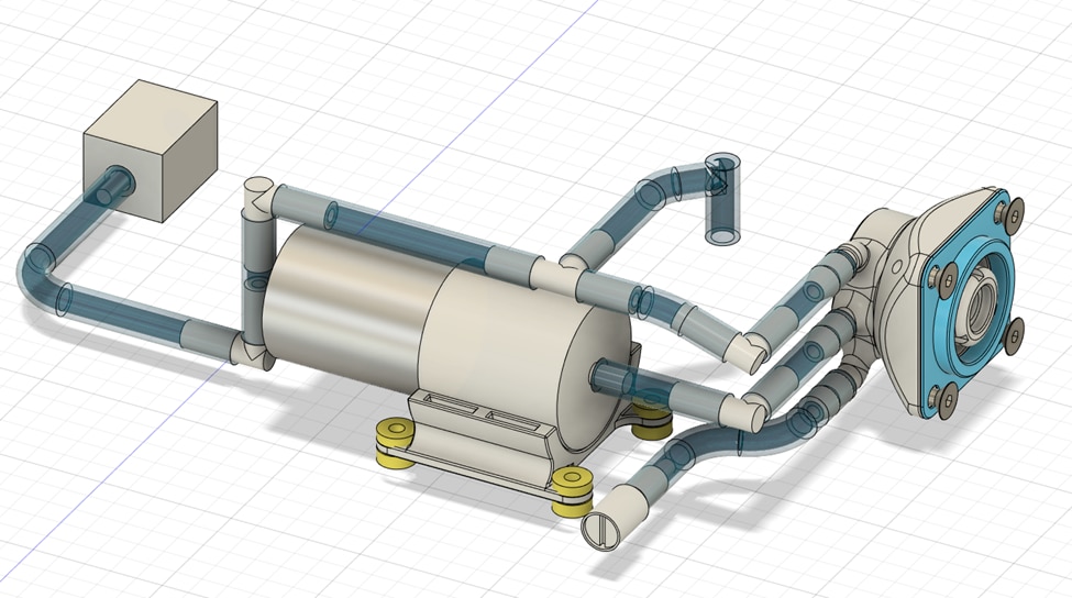

  • Blood Pressure Measurement – This is of course the focus of the video, these are the critical components for this part of the system:
    1. Air pump
    2. EM valve
    3. Adjustable valve
    4. Pressure sensor
    5. Amplifier or 24bit ADC for the pressure sensor

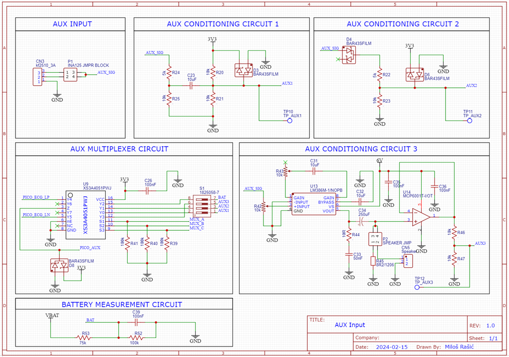

  • PPG – PPG Clamps are used often for measuring oxygen saturation in the blood, but they can also be used in blood pressure measurements, since their readings are affected by blood flow in the arm.
  • ECG – To ensure the validity of other results (like calculating the heart rate), Milos added the AD8232 IC to the PCB for measuring ECG signals
  • Wireless connectivity – To enable the possibility of wirelessly connecting to the device, either using a phone or a PC, Milos decided to go with the Raspberry Pi Pico W as the MCU.

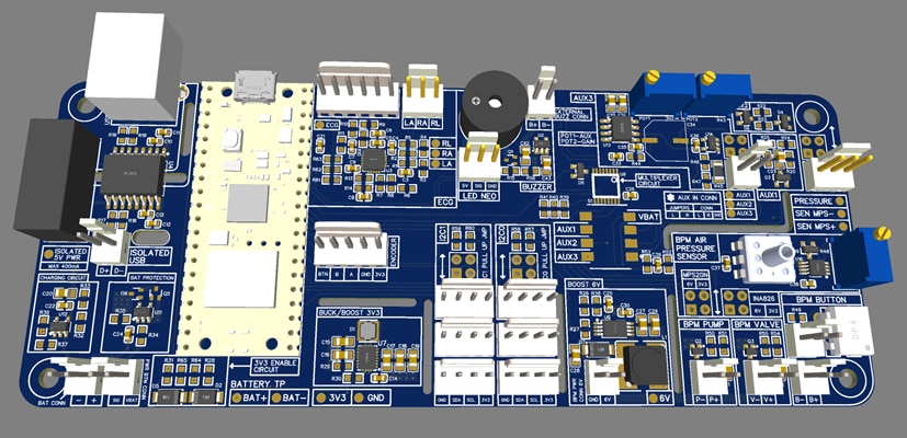

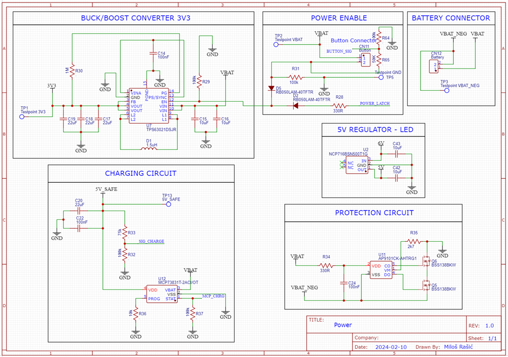

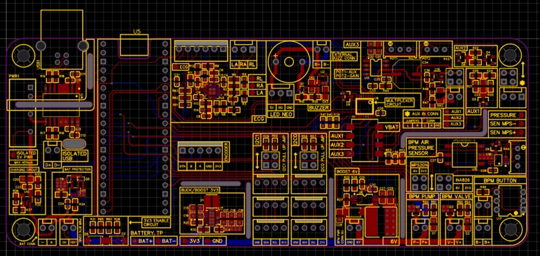

To keep the device compact, all the necessary electronics were placed on a single 4-layer PCB, with many additional I2C connectors to enable future expansions with new sensors.
Since the pressure sensor was connected to the Raspberry Pi Pico W using an instrumentation amplifier with adjustable gain, a calibration procedure was needed to ensure that the system is providing accurate pressure readings. To accomplish this, Milos designed a calibration rig consisting of manometers and syringes which are connected to the pressure sensor. This rig can keep a constant pressure in the system, so that raw ADC readings can be written down at multiple pressures across the desired range, from which the parameters can be calculated for converting the raw ADC measurements into kPa or mmHg.

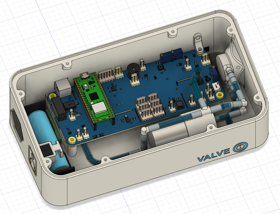

The Mechanical Design

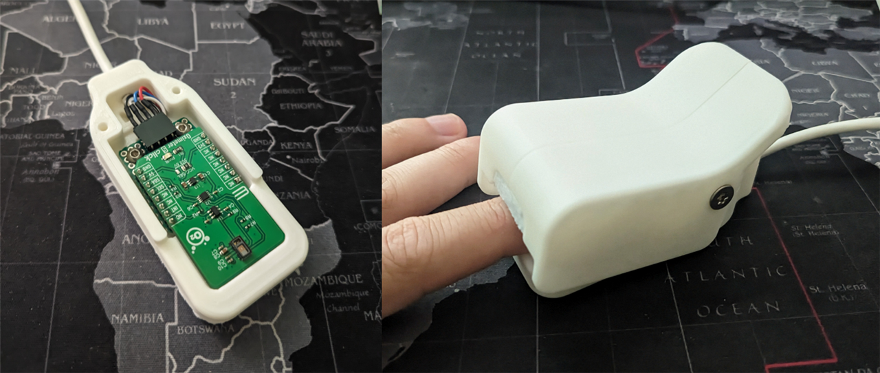

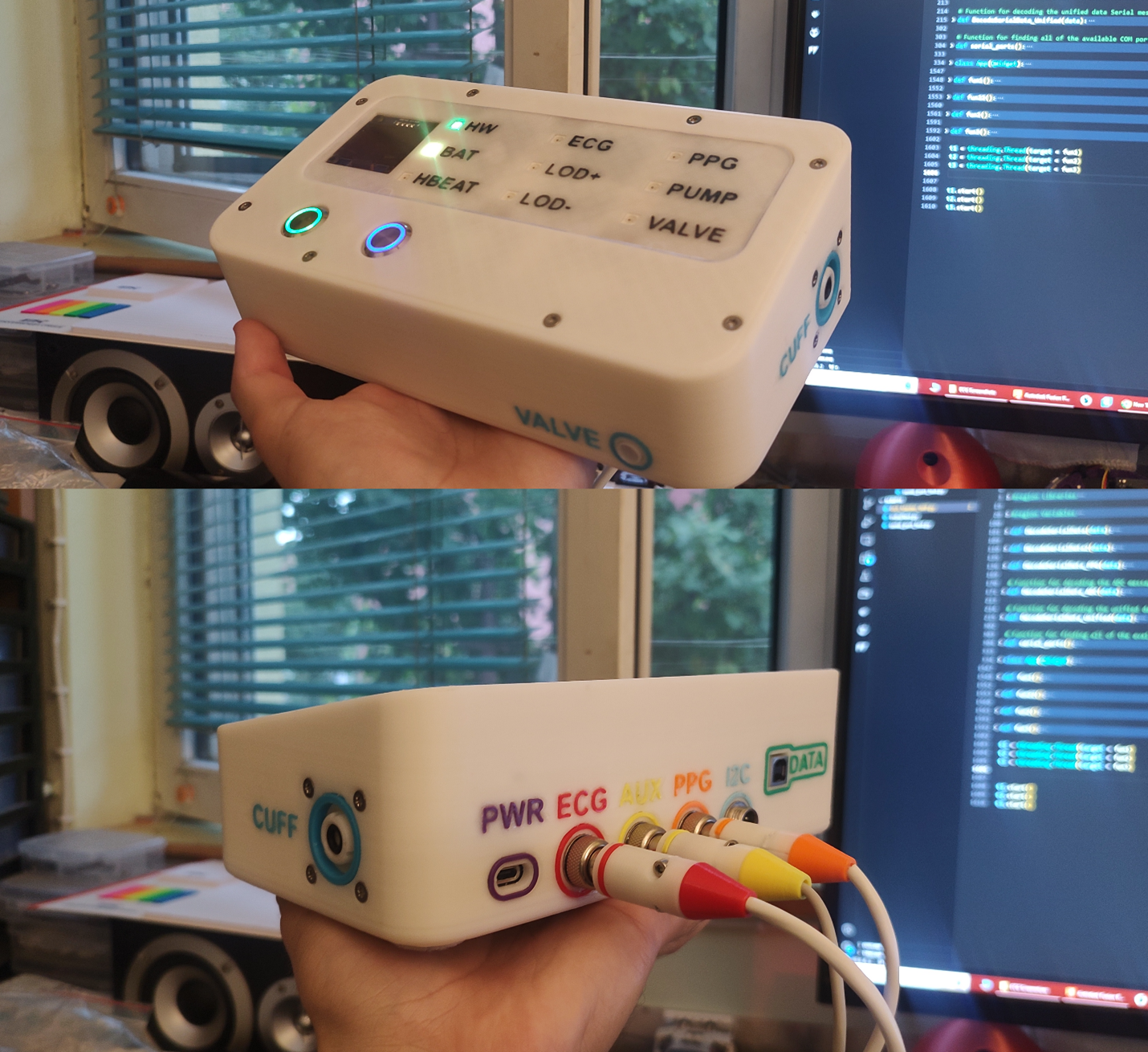

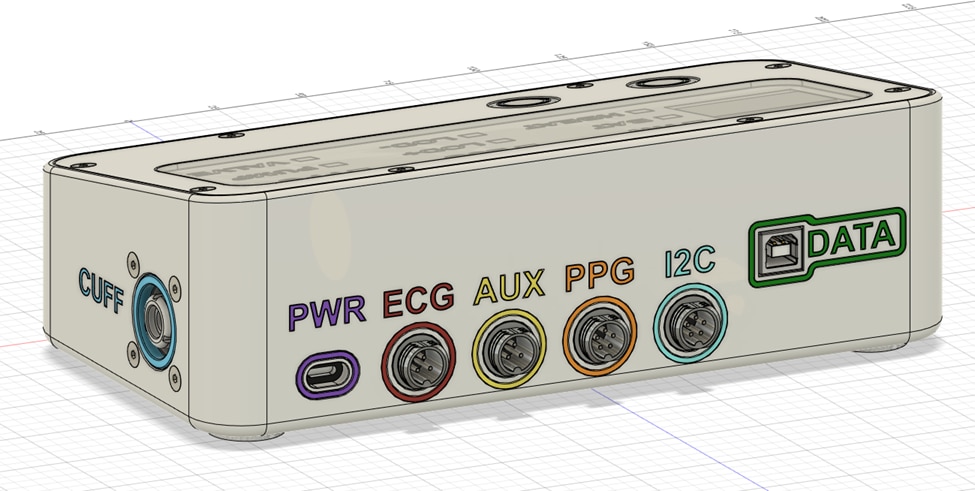

To keep everything together and to decrease the possibility of touching anything on the PCB, Milos designed, and 3D printed an enclosure out of PLA with all the necessary connectors. Milos went a step further and colour coded everything to ensure a sleek look. While this would have been easy to do with a multi colour printer, this process was a bit tedious, since Milos had to glue in all the letters by hand into their spots.
Besides this, Milos also designed and printed a clamp that goes around a Mikroelektronika Oximeter 5 Click and case for the electronics that convert an old regular stethoscope into an electronic one.

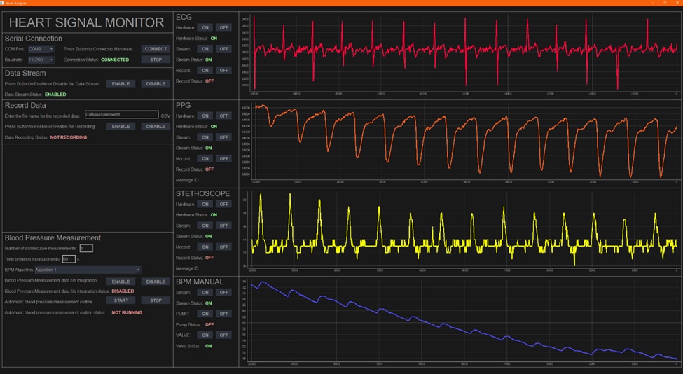

Running the Software
This was all of course accompanied by the necessary software, which includes 3 different codes:
  • Raspberry Pi Pico Code – C++
  • GUI Software – Python
  • Data Analysis – Python
The raspberry can receive commands over serial, where Milos designed commands to mimic the G code commands. Besides that, there is a GUI which shows all the signals in real time and lets you record all of them into a CSV file for further analysis.

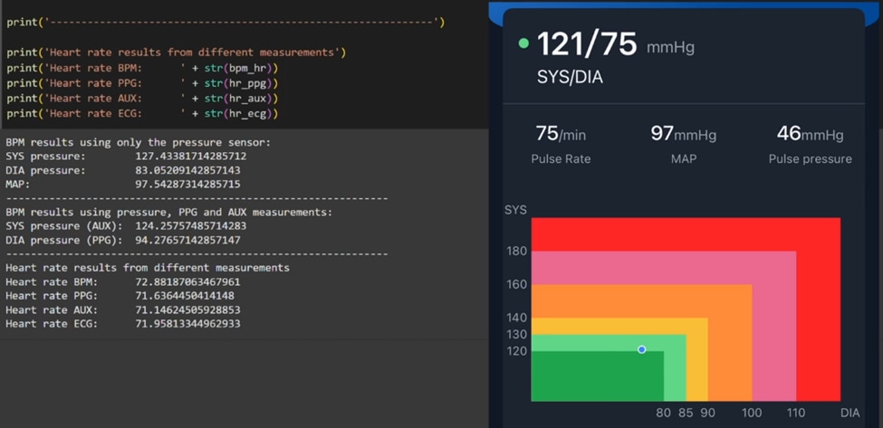

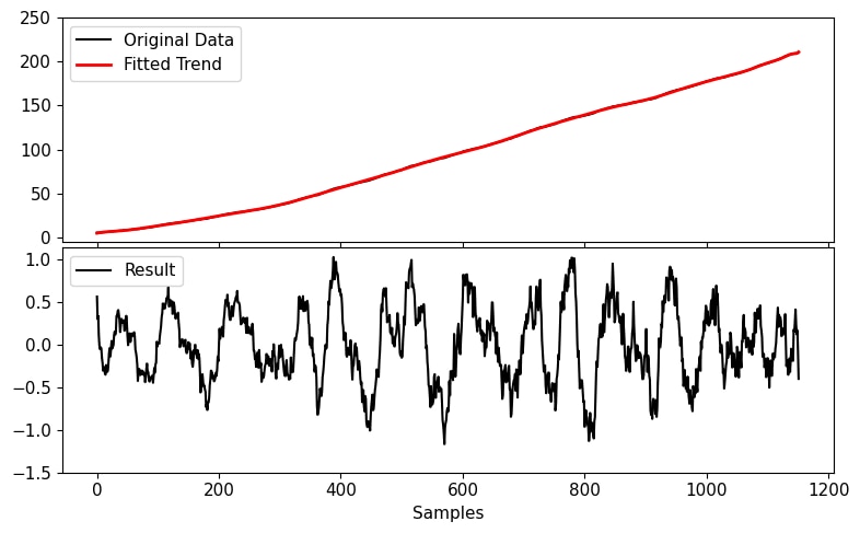

Milos dedicated the end of the video to show how Milos analyzed the data using Python and comparing that to the results acquired by a commercial blood pressure monitor. If you’re interested in just the data analysis part, you can download the dataset with the code and try analysing it yourself!
The results Milos got were not too far off from the commercial device, but as Milos discusses in the video, the end results are extremely sensitive to any noise in the signals, the way the data is filtered, or if the person has an irregular heart rate.

    In my eyes, the only kind of trend that can be established is, as you've said, by routine monitoring at home. Having those one-off measurements sounds rather unreliable and would only serve the purpose of checking the current condition of the person if they are feeling unwell at that moment. As you've pointed out, too many factors influence the pressure reading.
    Haven't seen ones with the clothing detection, and honestly wanted to try over thin fabric shirts since to me it doesn't look like it should cause any errors in the readings (if it's light material and it's not constricting blood flow through the arm). I'm impressed that they can detect pieces of clothing. I'll need to explore further how they do that. Sounds cool!
    The stethoscope I had here was broken, so the readings were bad, but that's something I wanted to try, to see whether the manual method could be recreated like that. There are some other fun methods I've come across while researching, one of them being a two-cuff method, where an additional cuff would be placed near the wrist to monitor sounds, and with PPG, which is what I tried here.
    A lot of cool research and devices have already come out to estimate blood pressure without a cuff. Some principles include looking at the delay between the ECG and PPG signal, which essentially shows the speed of the mechanical wave through the vessels, and other work solely by looking at the morphology of the PPG signal. So there are a lot of fun things to explore and research about this subject!

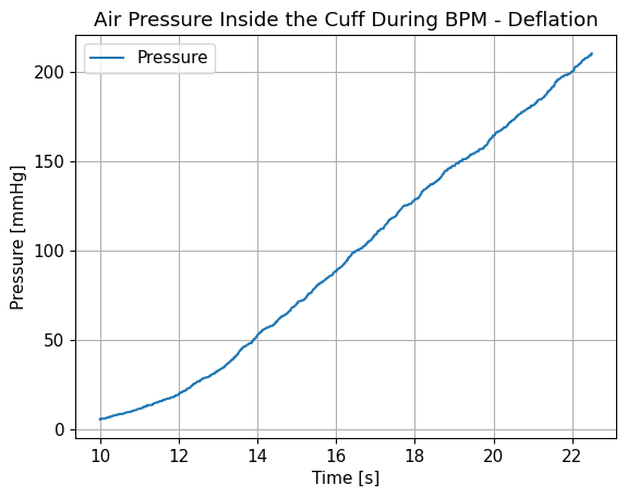

    Even one minute apart, the measurements will be off, especially since all of the non-invasive procedures are just estimating the pressure. Another thing is, pressure by itself is something that, of course, drastically changes throughout the day, based on activity, food, to stress, so I guess the general idea is to establish whether there is a clear pattern of constant high or low pressure. But there is another issue here, and that's the white coat syndrome, which can actually go both ways! Some people get extra nervous when they are at the doctor and their blood pressure jumps up because of that, while other people feel at ease when they are at a doctor and their blood pressure drops.
    Since this was all inspired by my grandma, we always make sure she sits for at least 5 minutes, and if it's not a crazy high value, we remeasure after 10-15 before she takes any additional medication to lower the blood pressure, and usually, the pressure is much better the second time around!
    I haven't done any experiments in regards to estimating the systolic pressure based on the cuff inflation, got curious so I extracted that data from the video dataset. This is what I get:
    The data is much noisier because of the pump, which is to be expected, of course, but pulsations can still be seen even after the systolic pressure has been surpassed. One reason why pulsations can still be seen is that the cuff, while cutting off circulation there is still in contact with the upper part of the arm and transferring that mechanical wave. I am not sure how they reliably cut off at about 30 mmHg above the systolic pressure, but as you've mentioned, it's rather reliable. Sometimes it fails and needs to be reinflated, but rarely.
    As for how long the deflation lasts, there are probably some models that can vary that speed as well. I remember finding a proposed mmHg/s figure in some research paper, to which I adjusted the valve I had. The ones I've taken apart have all had a small adjustable valve. Having a fully closed system with two valves would be an even better option, since that would allow for more complex and accurate algorithms where the device could keep the cuff at a set pressure level while conducting a measurement over a longer time. The time difference could also be attributed to how tightly the cuff was put around the arm, since that affects how much air will actually go in the cuff, though I don't know how much time-wise that would affect the deflation phase.
    My mistake for mixing up the 40% and 50% sorry, and here is why ahhahaha! Two of the more popular methods are the Sapinsky and Geddes methods, and they both work in the same way, look at the envelope of the signal, and using the percentages, they do the pressure estimation. One of the methods proposes using 40% and 70% while the other proposes using 50% and 80%. This is something that I found weird when looking at it since this meant that we can get two rather different results from the same measurement. I had the methods mixed up in my head a bit while doing the video, so I've probably used one in the beginning and one in the end!

    How is the rough estimation of systolic pressure done during cuff inflation ? I have found it pretty reliable and as you point out usually around 30mmHg above the final systolic reading. Very occasionally does the pump turn back on to inflate the cuff more. Is it just monitoring for loss of heart rate detection and then adding an extra 30mmHg ? It appears to lock onto heart rate through the cuff pressure pretty quickly at about 5 seconds/40mmHg into the inflation.
    Interesting insight into the two valves. Sometimes when taking measurements I've noticed that the measurement deflation phase appears to take a lot longer than others, even without significant variations in final readings. Up until now I had assumed that it was just the EM valve controlling the deflation phase but it looks like the adjustable valve and signal monitoring is doing the work, until the final cuff pressure release.
    In the overview section you mention 40% of the envelope max for the systolic pressure time
    however later on in the analysis you start to use 50%. Was this adjusted after experimentation to more closely match the reference readings from the digital gauge ?
