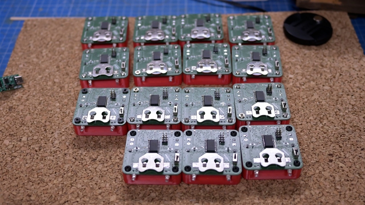

I Tried Building 16 ATtiny Robots with Vibration Motors – It Was a Disaster -- Episode 676
Join us as we explore the harsh lessons learned from building a swarm of tiny robots powered by ATtiny416 microcontrollers, vibration motors, and 3V coin cells. What started as a simple DIY robotics project quickly descended into development hell plagued by power issues, motor driver failures, inconsistent components, and programming headaches. Follow along as we break down the seven circles of integration problems, uncover what went wrong, and share practical insights to help you avoid the same pitfalls in your own projects.

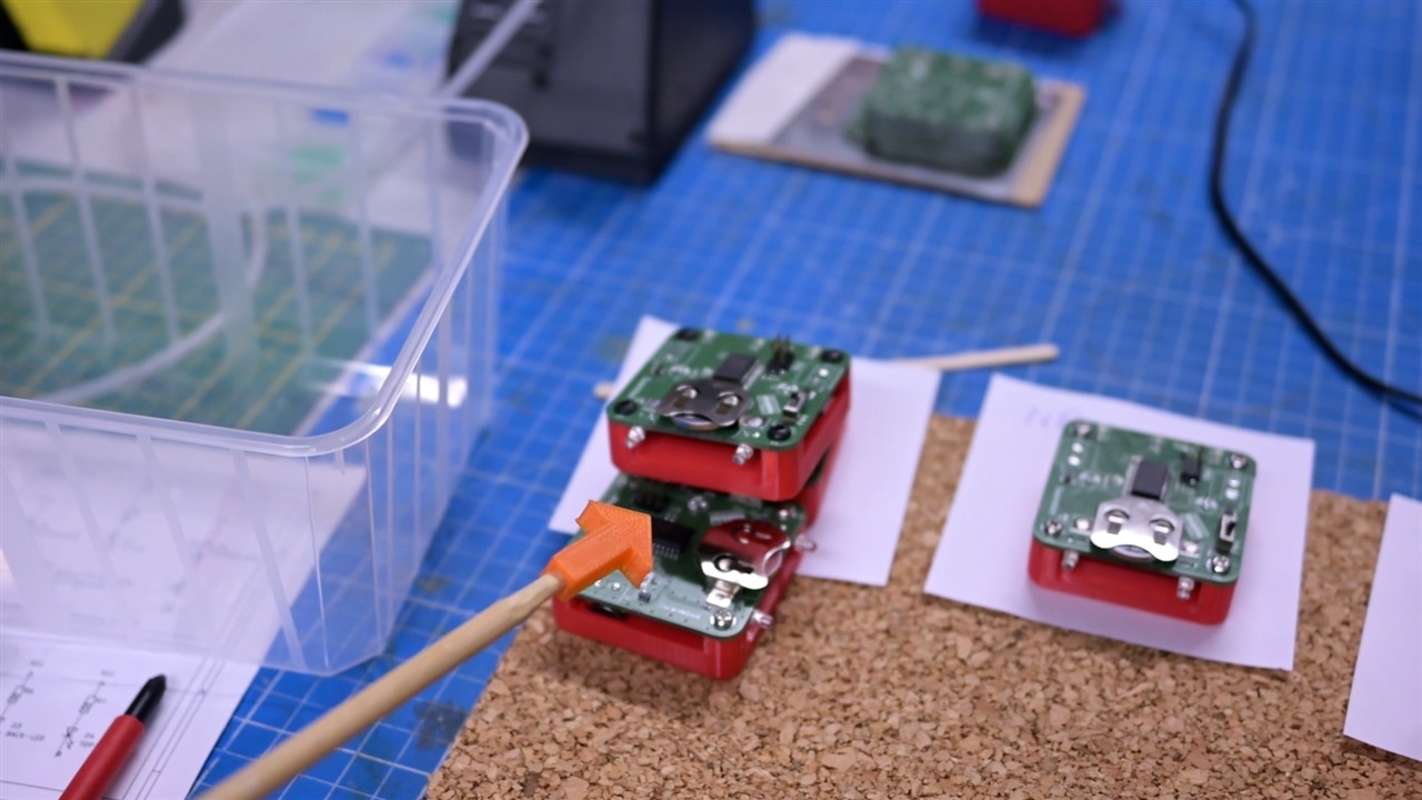

Circle 5: Manufacturing Inconsistency
The Problem: Even with the same PCB and components, results can vary. Some devices may have odd power consumption issues, while others suffer from unexplained motor noise.
The Escape: Expecting variability, especially in hardware projects, is essential. Using controlled test environments and maintaining detailed logs of behaviours can aid in troubleshooting. Sourcing components from the same batch and investigating alternative suppliers or design adjustments can also improve consistency.

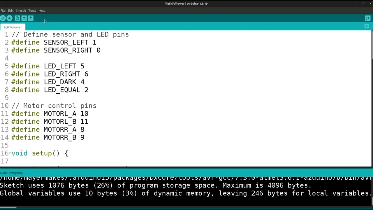

Circle 6: Programming Hiccups
The Problem: Flaky flashing interfaces, cold solder joints, undefined behaviour, and brownouts are common obstacles. Debugging in such conditions can be slow and frustrating.
The Escape: Investing in proper debugging tools—such as logic analysers, oscilloscopes, and serial debuggers—can significantly ease troubleshooting. Implementing fail safes early, such as watchdogs and reset mechanisms, ensures stability. Version control and incremental testing prevent the accumulation of unresolved issues.

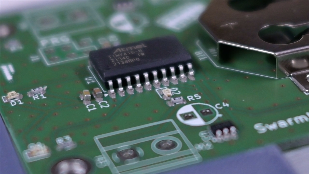

    Sometimes the report is the most useful outcome of a project. A negative result from an experiment is till a point of data that may help followers !
    I had a quick look at the problem - here are my thoughts:
    1) The motor looks like  a good choice  - its very cheap  - much better motors exist but at the £30+ level. The down side of the motor is that it is not well specified ( Farnell could improve the offering by providing better data  - like stall current, inductance, torque curves etc.)
    2) The battery is the main issue - the maximum specified continuous current is 1mA and the pulse current (15 seconds) is specced as a 30R load causing the battery voltage to droop to 1.5V. The motor stall current will be at least 10x the run current so of the order of 3A. This battery will really struggle to turn that motor - and we can't say how much of a struggle because neither will be operating in regions for which data has been provided.
    3) The motor driver is current limited and will trip at between 1 and 2A.
    4) The capacitor will help get the motor spinning but it's much too small and the ESR isn't specified. I don't have enough motor data to work out how long it takes to get spinning but I'm going to guess at 10ms - so you need a cap that drops 0.3V at 3A for 10ms = 100,000 uF - not very practical (a supercap could work) but it must have an ESR below 30mR !!
    5) If you isolate the supplies so that the processor isn't de-powered when the motor starts you might keep control but the motor driver may still not get enough volts to work.
    6) I can think of two ways round all the above - use PWM to soft start the motor (elegant but complex - you'll probably need a better processor with motor control type timers), or simple and brute force-ish - use  a lithium ion battery. An AA size lithium ion battery will be able to start the motors.
    7) You will still need much better isolation between the processor and the motors - but you should be able to get away with powering the processor via an RC filter (C on the processor side). SM ceramic caps across the motors and the motor driver supply will be needed.
    8) The motor stall current may still be a problem with the driver 1A current limit - you might fix this by putting a resistor in series with the motor (2.7R should do it) - this is simple but will much reduce the efficiency.
    I would add a detail to DAB's list in sections 2/3  - do the maths/simulation/experiments to validate the selection of values and types of all the parts. As with all rules, just how far you take this is project dependent - (I don't do a calculation/simulation to justify every 100nF decoupling cap but I would for every electrolytic (Farnell sell nearly 2300 different 100uF caps, ranging in price from £0.03 to £119.77 each - you have to choose the right one !).
