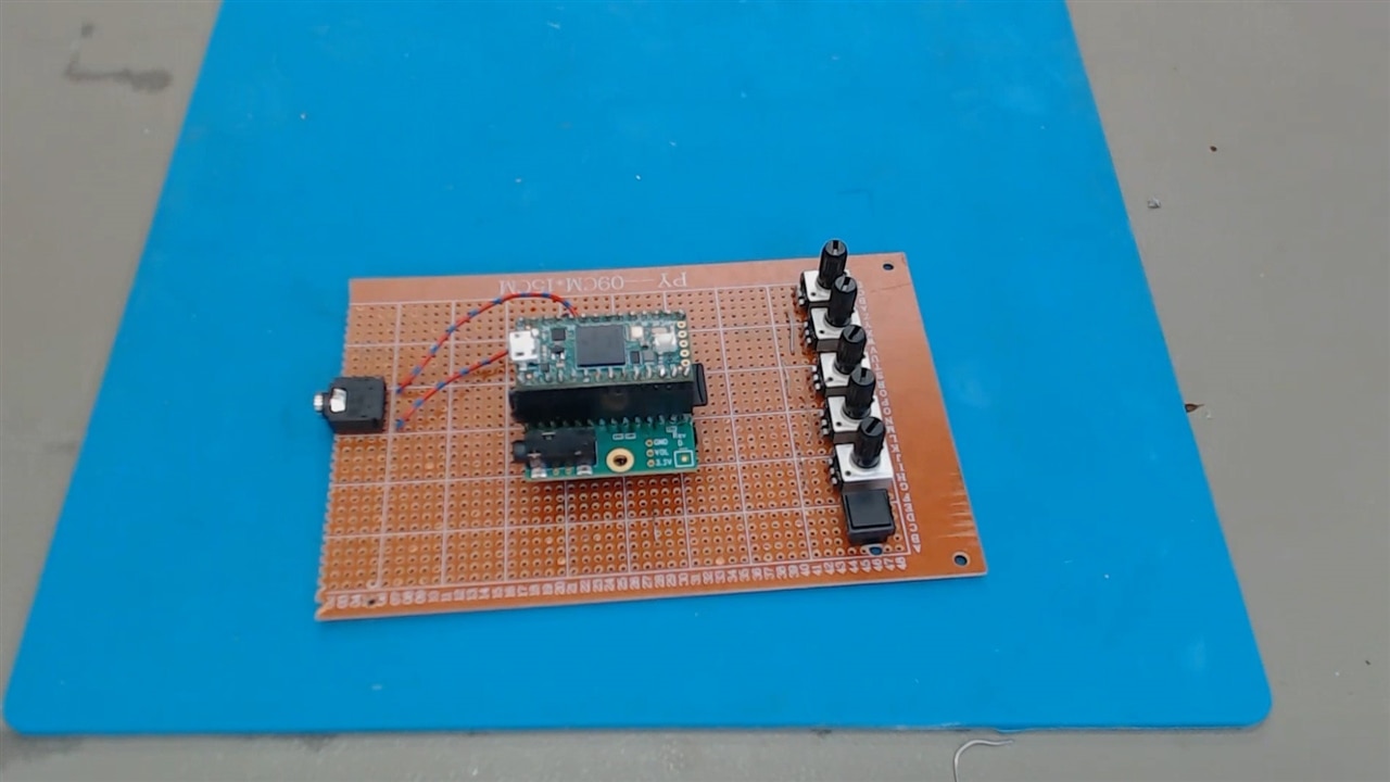

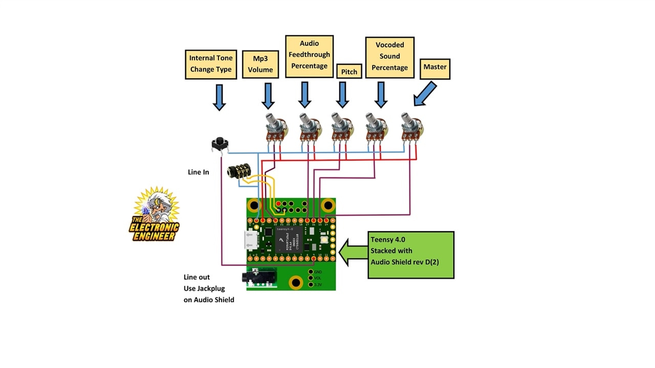

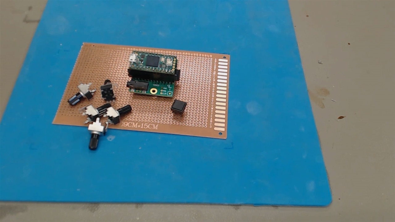

The hardware platform for this build centers around a Teensy 4.0 microcontroller, selected for its high processing speed and compatibility with real-time audio DSP tasks. It is paired with the PJRC Audio Shield (Rev D), which provides line-in, mic-in, line-out, and SD card capabilities. These features are critical for both capturing and playing back audio during vocoder operation. To provide real-time control over various parameters such as pitch, volume, and waveform characteristics, three potentiometers are wired to the Teensy's analogue inputs. A tactile push button is also included to toggle waveform modes for the internal tone generator. All components are mounted on a soldered prototyping board, a design choice that offers improved connection stability compared to a solder-less breadboard. This is essential when dealing with analogue signals that can be easily disrupted by intermittent contacts.
Mark opted to use headers and sockets on both the Teensy and Audio Shield. This does introduce additional height and board space, but the modular approach makes it easy to disassemble and reconfigure during iterative testing. One minor challenge encountered was that the Audio Shield’s header pins are not aligned to standard breadboard pitch, which required workaround wiring for audio connections. Additionally, the potentiometers used have wider pins than typical 2.54 mm spacing, so Mark pre-cut custom slots in the protoboard to accommodate them and ensure a snug fit. The final layout includes a 3.5 mm TRS jack for audio out, allowing for quick connection to external speakers or amplifiers. This hardware setup, although manually assembled and prototype-grade, proves highly capable of supporting the vocoder’s multiband filter processing with minimal signal latency.

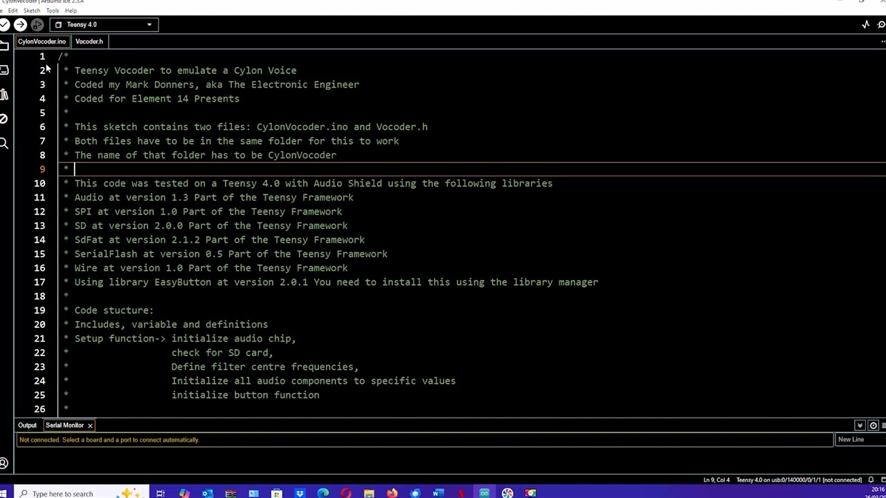

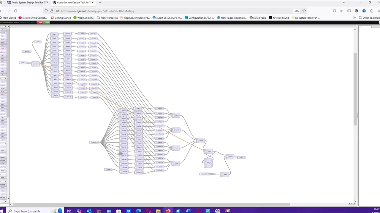

Using the Teensy Audio System Design Tool, Mark constructs the entire vocoder processing chain graphically before exporting it into Arduino code. The tool allows for the placement and linking of audio objects like waveform generators, band-pass filters, and mixers. On the software side, the sketch includes support for audio input via line-in or microphone, signal peak detection, real-time user controls, and playback of a WAV file from an SD card. The audio signal flow mimics the vocoder model: the analyser captures the spectrum, and a parallel path generates a new signal, modulated by the original’s spectral characteristics.

Despite the many filters and processing elements involved, latency is surprisingly low—almost imperceptible during real-time use. The final result is a functional digital vocoder that emulates the iconic robot-style voices popularised by science fiction. While this build is tuned for voice processing, the design can be adapted for musical or experimental audio applications by modifying the input sources and control logic.
